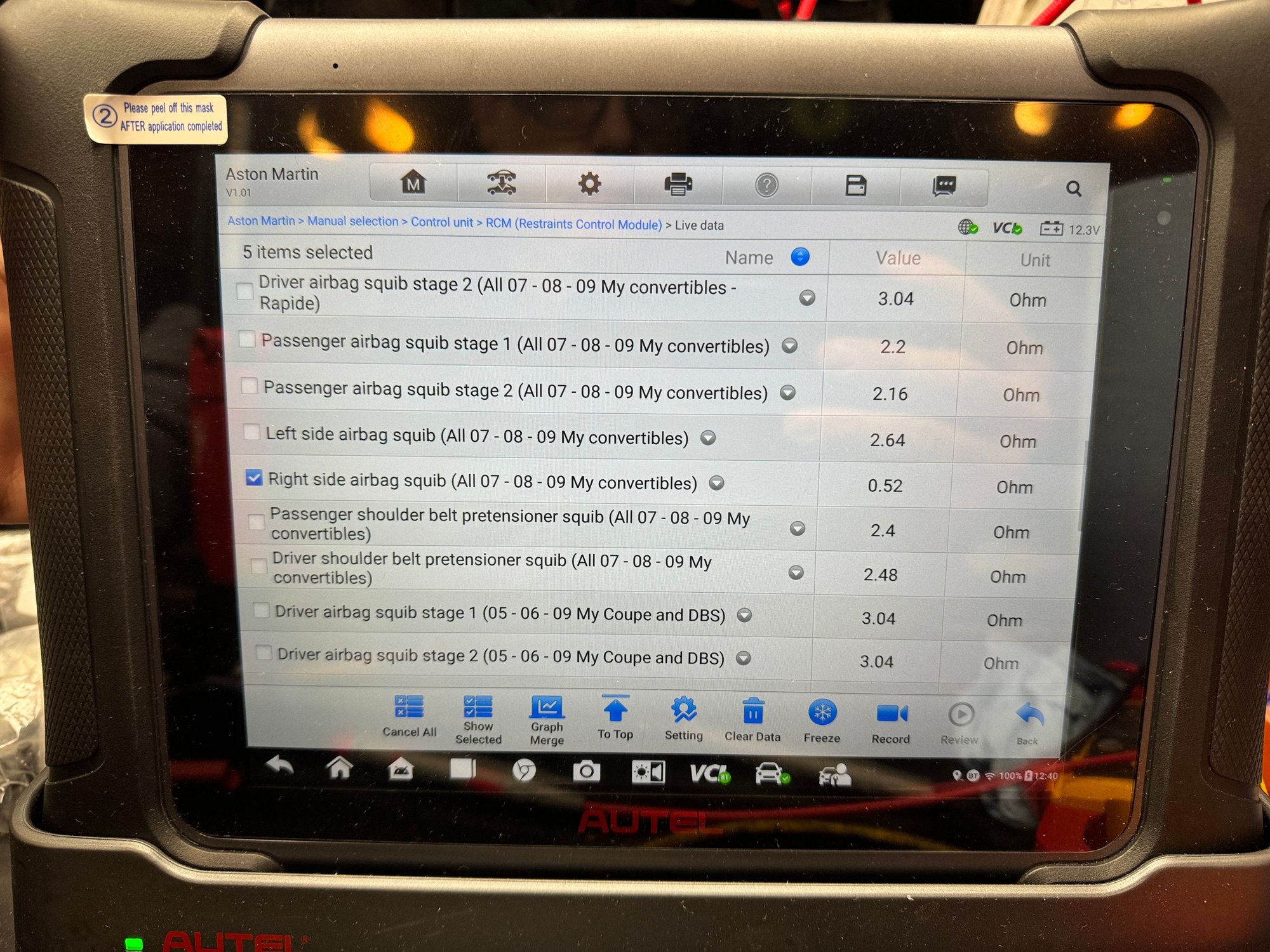

Right side airbag squib error
My airbag light is on (2007 V8V cabriolet). When I hook up a scanner with live data, it shows 'right side airbag squib 0.52 ohms'. I believe it should be around 2.2 ohms like the others. Where is the right side airbag squib? Is that in the dashboard or the seat?
Incidentally, the error code relates to the passenger seatbelt pretensioner squib, which I sent to Safety Restore and they told me it was fine and didn't need replacing. But live data points to the right side airbag squib? I am confused.

Well, after analyzing the live data, I tracked down the issue to the passenger seat airbag. I removed the seat and measured the resistance of the airbag and it shows as 0.5 ohms, below the minimum limit. I bridged the connector plug with a 2.2 ohm resistor and the airbag light went out and all the codes cleared. Therefore my Autel scanner is mis-diagnosing the seat airbag as the seatbelt pretensioner. I need to contact Autel and also locate a passenger seat bolster airbag. They seem to be hard to find.

My passenger seat airbag is bad, needs replacing. The Autel misdiagnosed the DTC, but the live data from the Autel was correct. If you are getting the same codes, test it by unbolting the seat, disconnecting the battery then measuring the resistance across the pins of the airbag connector under the seat. Takes about 45 mins from start to finish.
I found scuderia car parts online that supplied a new airbag for about $400 with shipping and taxes.
