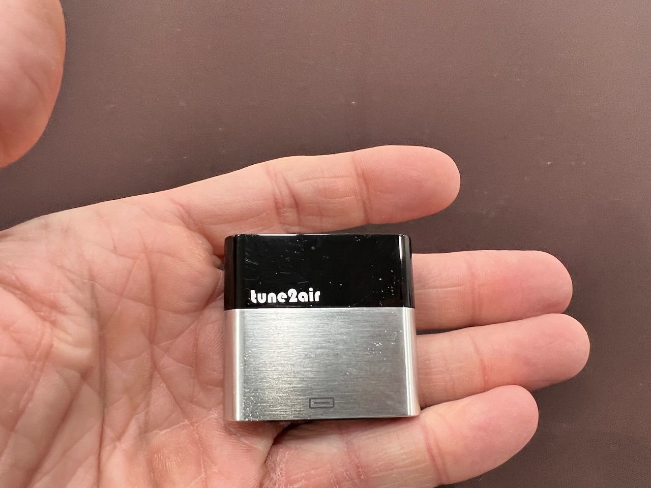

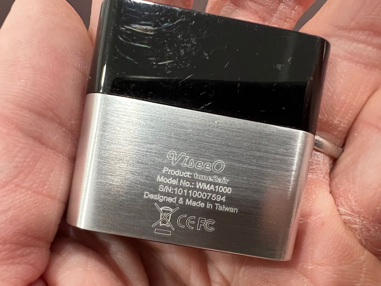

I'm not sure what the Mr12Volt P600 unit is but I have this basic Tune2Air WMA1000 device plugged into my car's wired input (using an old school iphone pre-lighting connector) and it works perfectly 100% of the time. Never have to cycle it, doesn't drain the battery when the car is parked for weeks at a time, shows full data info on the display, forward/back/etc controls all work.
Very simple and effective.

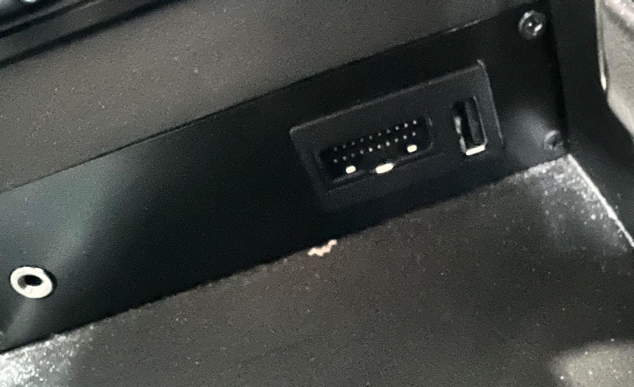

It's a 2010 Vantage - window sticker with all the options below. What I mean by wired input is this rectangular plug connection in the armrest compartment. See pictures below:

I did not realize that port in the console was not standard across all Vantages. Here is a parts diagram that shows the port and the cable (that also came with my car) and you are correct that it was designed to plug in an iPod (this was back in the day) or iPhone directly and the Tune2Air just turns that connection wireless with bluetooth.

I think you have to have the ipod option... some don't have that option.

That may have changed over the production years but on my 2010 the option "6 CD autochanger and iPod connection" is listed under standard features (see window sticker for my car above).

Earlier cars did not have that as an option as I understand.
Either way, not all cars have the Ipod connection, my 2007 does not but have the premium audio system. So unfortunatly the only way to get phone audio into the car speakers is FM transmitter or a MOST integration unit. FM transmitter sucks when it comes to audio quality and the MOST options seems to be working sometimes and sometimes not.
