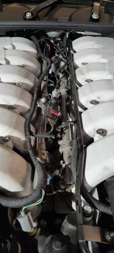

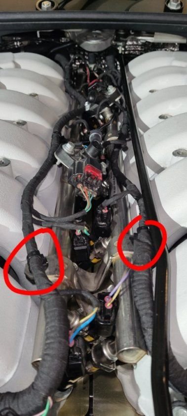

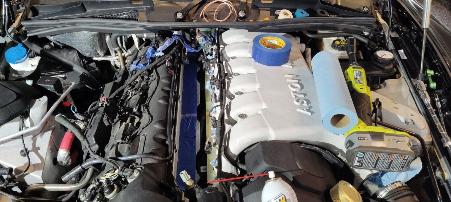

First is the dissassembly, it's pretty straight forward, take a lot of pictures for routing of the loom.

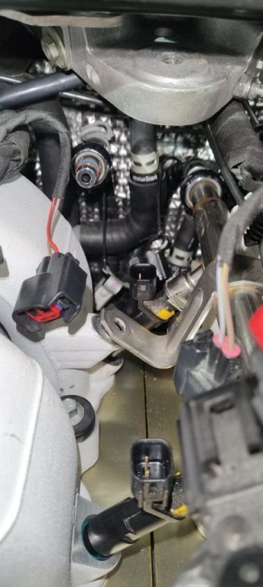

One thing I did differently, is I removed the fuel rails. To me it was obvious that I was going to get a lot more room to work and not have the injectors / rail in the way and potentially damage them.

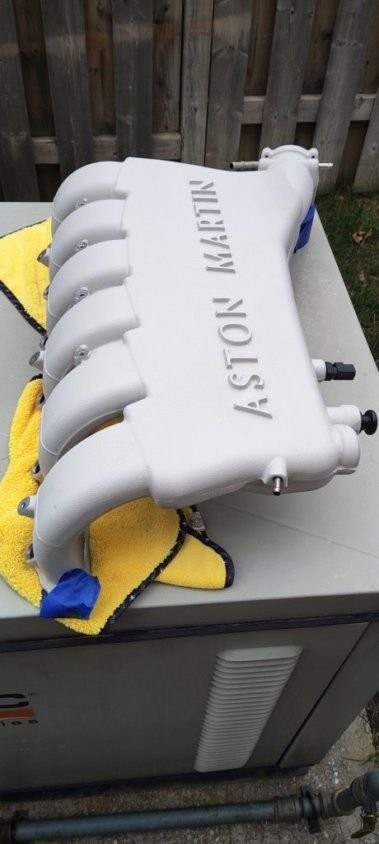

Remove the intake manifolds requires a bit of time and care to move them out of the way without scratching anything, but once the throttle bodies are out of the way and everything is disconnected properly, then it comes off without a hitch.
Had a bit of issue figuring out how to disconnect the brake booster line, but Steve @ Aston1936 had it figured out for me. Getting to the last manifold insulator bolts at the back is what took the most time. Also, start with RH side of the engine bay, the LH manifold has its last cylinder further recessed and harder to get to the bolts.
With the fuel line removal tool ($10ea), they come really easy, just have to be ready to catch the fuel. They are sized differently as well, need a different tool size for each, and only go back one way.
I did have to snip the fir clip ties (0.22" wide) for the injector loom off the fuel rail as they get mangled when prying them off with a trim tool. Ordered a pack of 100 online for $14, when I needed 6... but it made for a clean re-install.
Snipped the fir clips off the rail, had to replace all 6

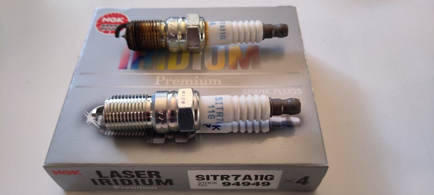

First off, did the plugs. Removing them was straightforward if only the ones at the back are a bit cramped. They were on very tight from the factory.

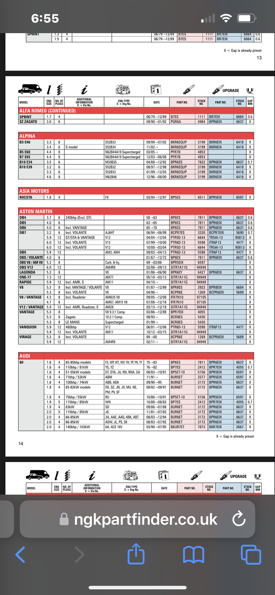

The OEMs on my car are the NGK SITR7A11G , Catalog # 94949 . I couldn't find them anywhere here in North America, only the local dealer carries them in the Aston Martin white box.
The OEM pack of 4 CD33-12405-AA-PK ($183) comes to ~$45ea
I bought the retail NGK plug for $11/ea
Aston Martin CD33 NGK plug vs Retail NGK 94949. Both SITR7A11G

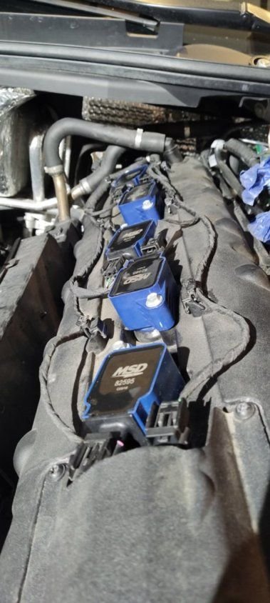

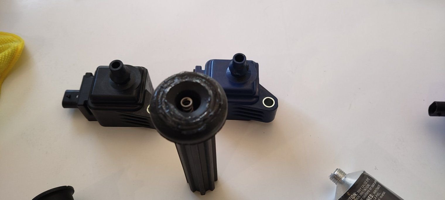

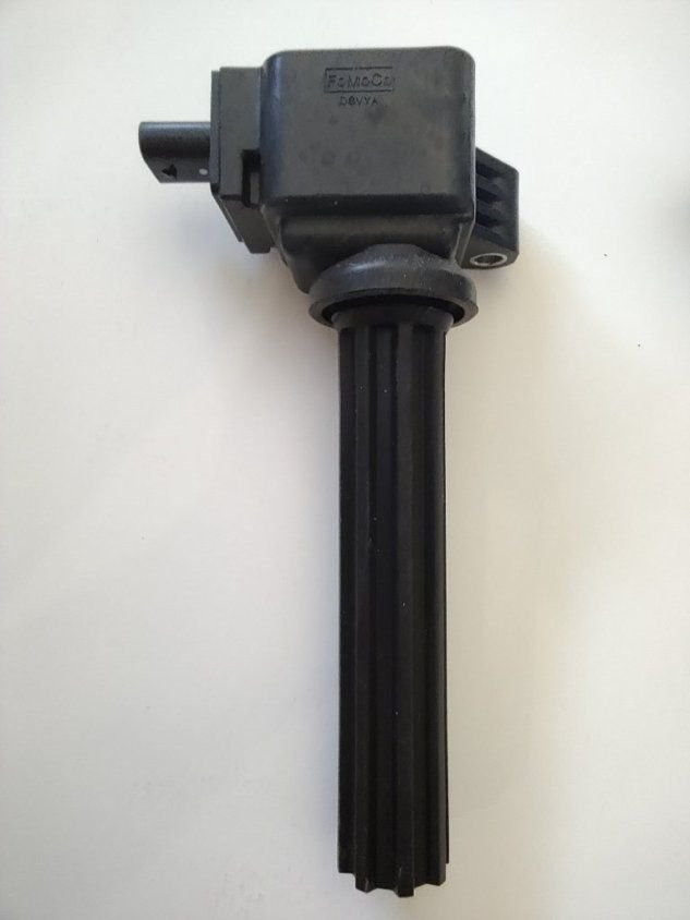

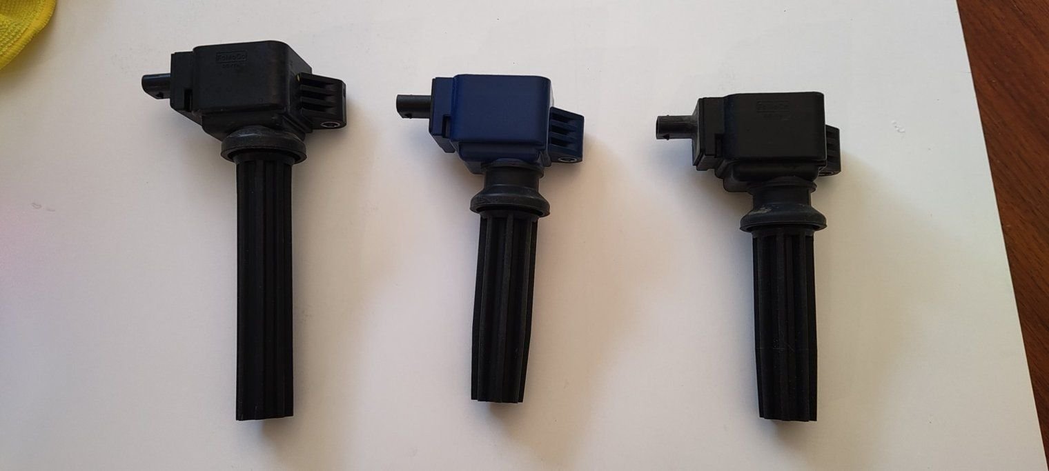

Then onto with the coils. The square coil is a Ford unit with a longer boot. This has been discussed elsewhere. Since the boots on mine were fine, I went aftermarket.
The Motorcraft part# for the coil is DG562 ( Also available: Denso 6736203 , Walker 9212147, NGK 48770 ,etc ) , and is used on a variety of cars including the Ford Ecoboost engines (2.3L I4)
OE Aston Martin Coil (Ford), MSD Coil, Motorcraft Coil (Ford)
OE Aston Martin coil
Since they had a sale on, I settled for a set MSD Ignition coils. I've no issues with quality on those specific coils in the past. Main reason was price, not really expecting more 'spark' out of them.
Price wise: the OEM ED23-12A366-AC ~$105 , vs Ford ~$60, vs MSD $42
I twisted the boots carefully off the coils to get them to unstick, added some dielectric grease on the base and put them all back together.
Swapping the boot onto the new COP, bit of dielectric grease for reassembly
And onto the car they went...
For re-install, spent a bit of time cleaning up the intake manifold, removing oil residue from them and throttle bodies.

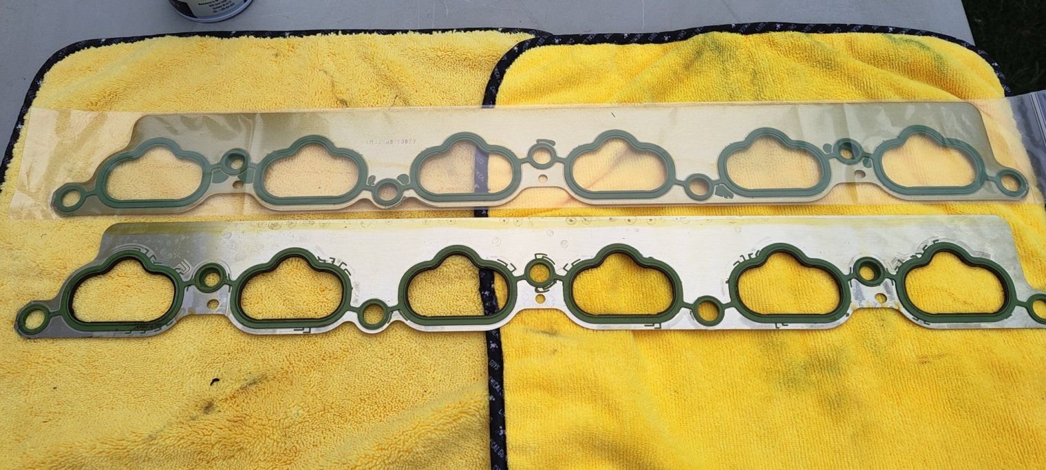

The intake manifold gasket price almost knocked me out! The single gasket is ~$258 , and the 2 pack kit ( 1R12-08-10077-PK )is between $350 and $430 .. that's nuts!
So, I did as I usually do when seeing price gouging from OEMs, and found my way to save a lot of money there:
Ended up paying ~$125 new for the pair!!
New gasket ($65!) on top, old gasket ($250!) on bottom

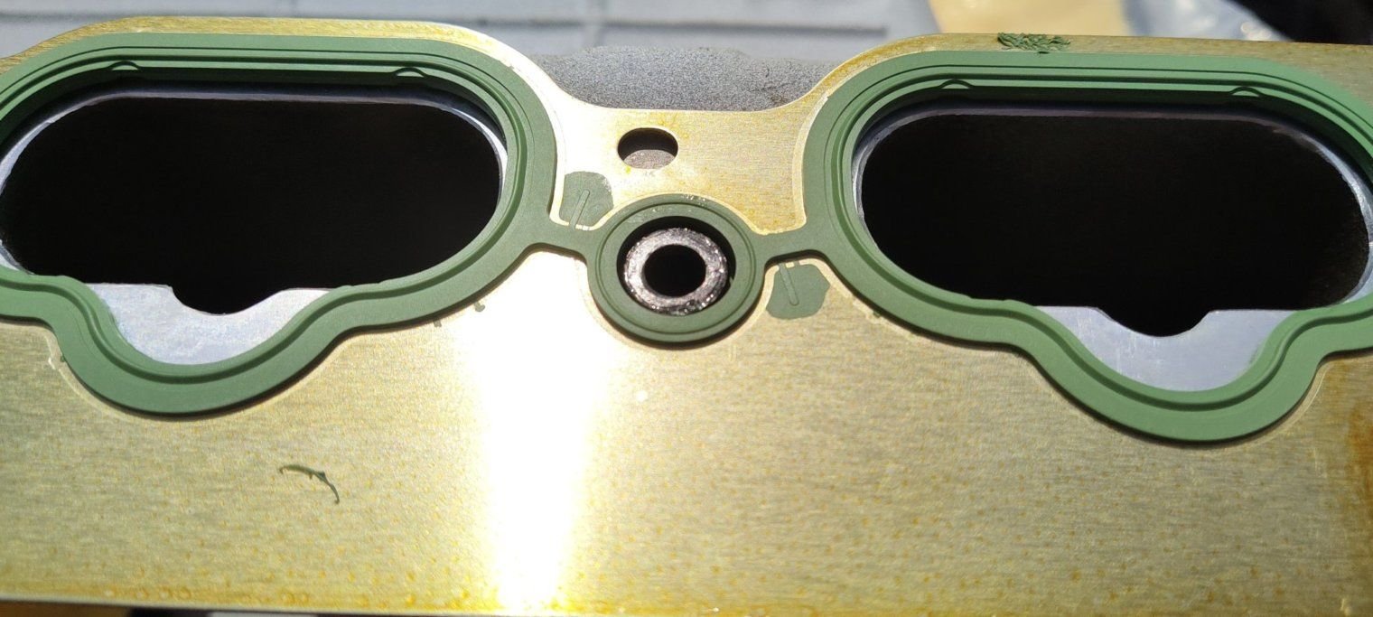

Lining up 2 Manifold Isolator bolts around the gasket ridge holds it in place for installation
I went per the instructions for installation and mounted the gasket with its 2 ridges with the insulators and made sure they held the gasket properly, did the install in reverse, slowly!

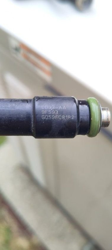

I changed out the lower O-Rings on the injectors. Left the top ones as I didn't remove the injectors from the rail.
The Aston Martin OEMs come in $42 replacement packs of 8 ( 6G43-08-11260-PK ), because it's a Bosch EV14 injector on Ford V8s. Vs Bosch 8 packs for EV14 top&bottom o-rings` $10
So OEM lower O-ring ~$5 each vs Bosch $0.50
Carefully routed and installed the looms as they were originally

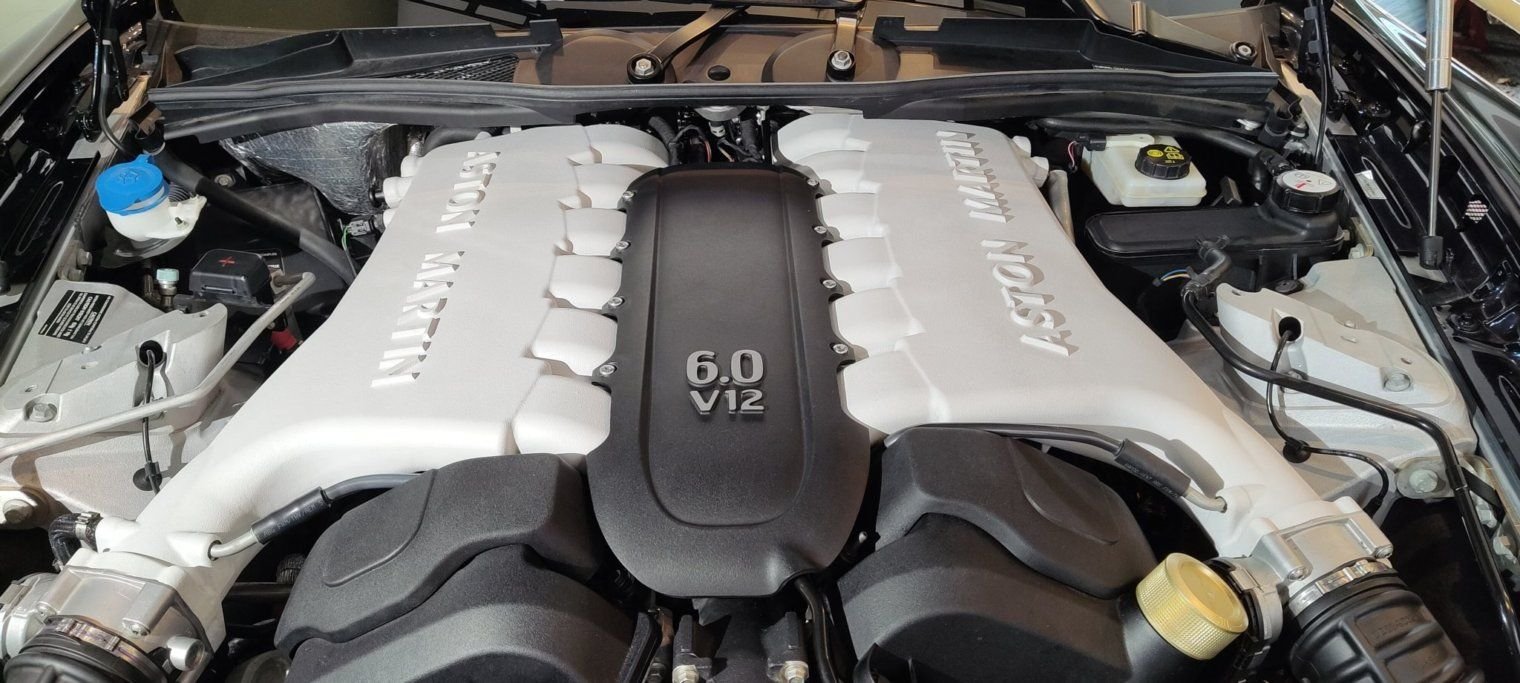

Finished by putting back the cleaned engine cover and brace!
