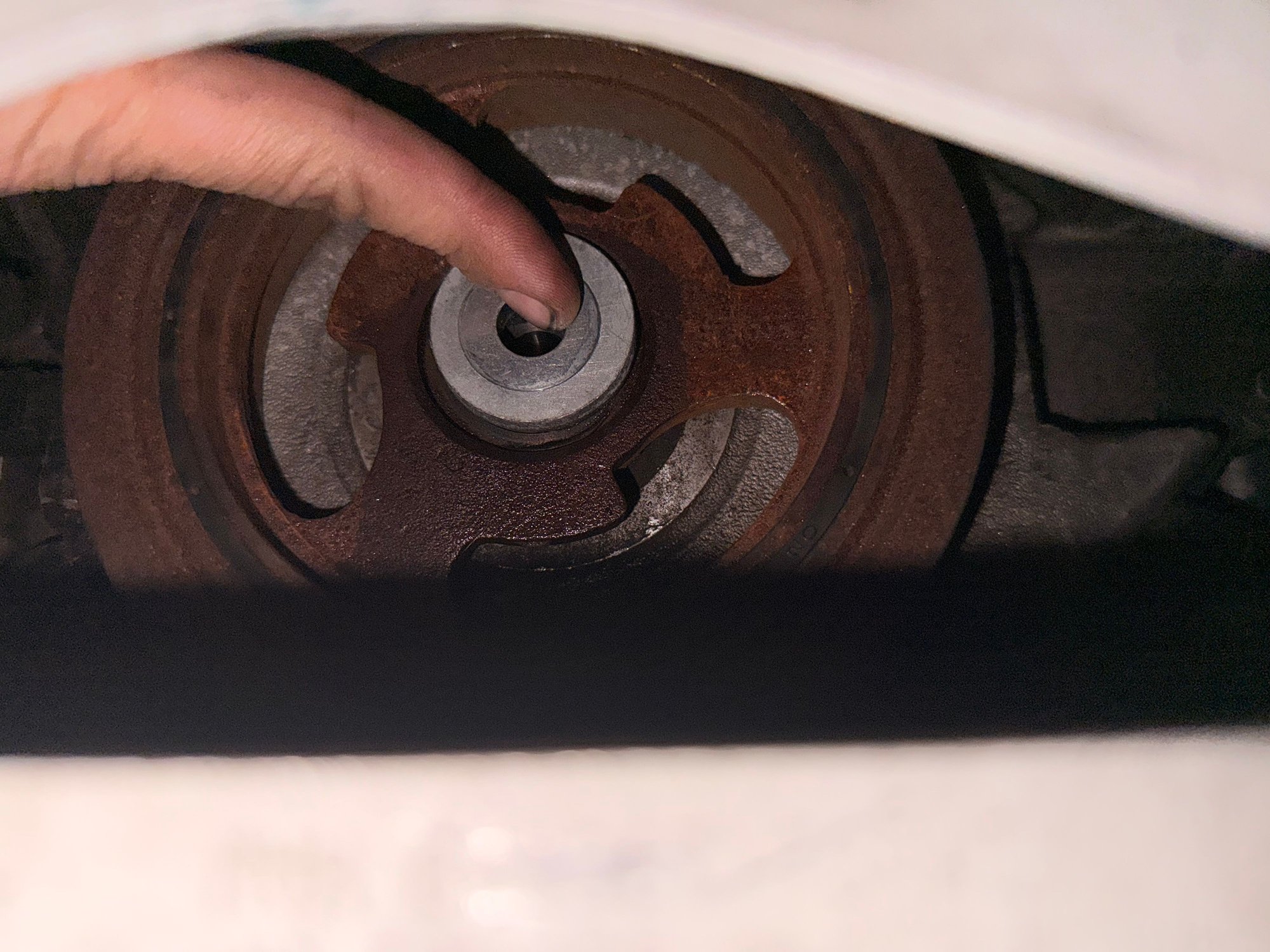

Hi all, new to the forum and the DB9 platform. I’ve just purchased a 2009 and am in the process of baselining it. One thing I’ve noticed is that my crank pulley seems to have a tiny amount of movement that I suspect is due to a deteriorating rubber isolator between the two pieces and have parked it until replaced.
Scuderia has this part priced at ~$1700 plus tariffs/shipping. In shopping for idler/tensioner pulleys, I saw a post where someone mentioned that those pulleys were exchangeable with duratech 3.0L V6 parts (of which the v12 is constructed). I’ve since ordered and received new idler and tensioner pulleys for a 2005 Ford Escape, and they are in fact identical. Now I’m wondering if the crank pulley of that same engine will also work, which is a much more palatable $170 on the high end of oem Ford parts. The photos look near identical, though it does seem Aston used several variations through the years judging by the drilled markings I’ve seen in Google photos. I haven’t removed my existing to measure and confirm, wondering if anyone else here has?

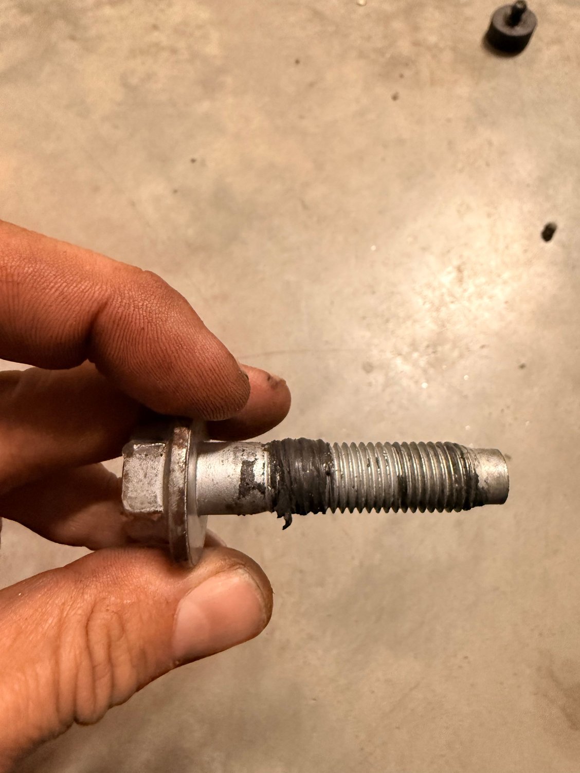

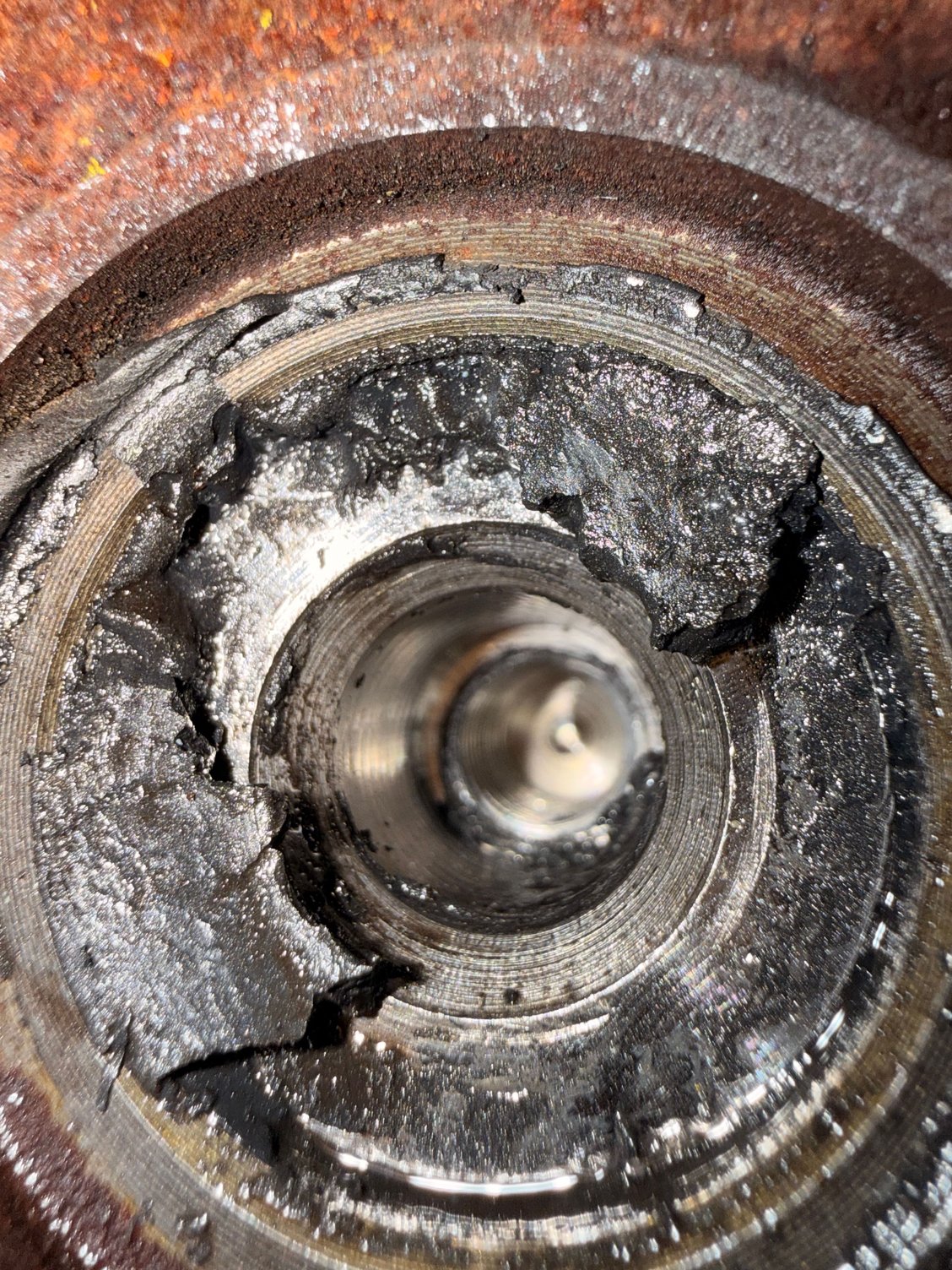

Ok, so I’ve managed to get the bolt out, but I cannot for the life of me get a puller to work. For whatever reason, my crank pulley does not have threaded holes, so a jaw puller is the only option unless I can somehow wiggle it loose; open to suggestions.

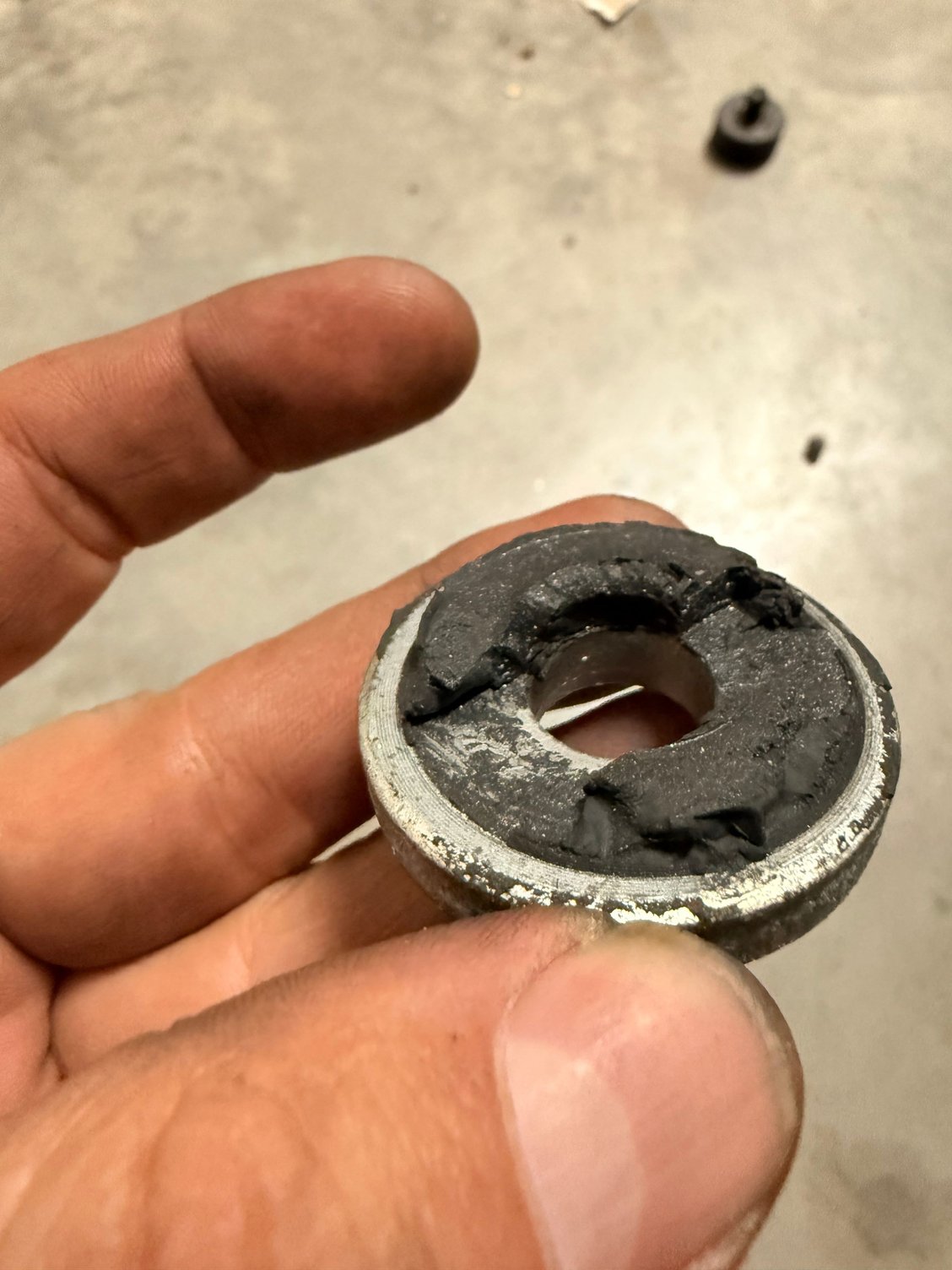

Also, when I pulled the washer out, it seems like it was in there with some rtv or gasket. I haven’t seen this mentioned anywhere and wondering if I need to apply new sealant when reinstalling?
Also also, my new pulley did not come with a new washer. Is it safe to clean/reuse the old one? I did source a new bolt.

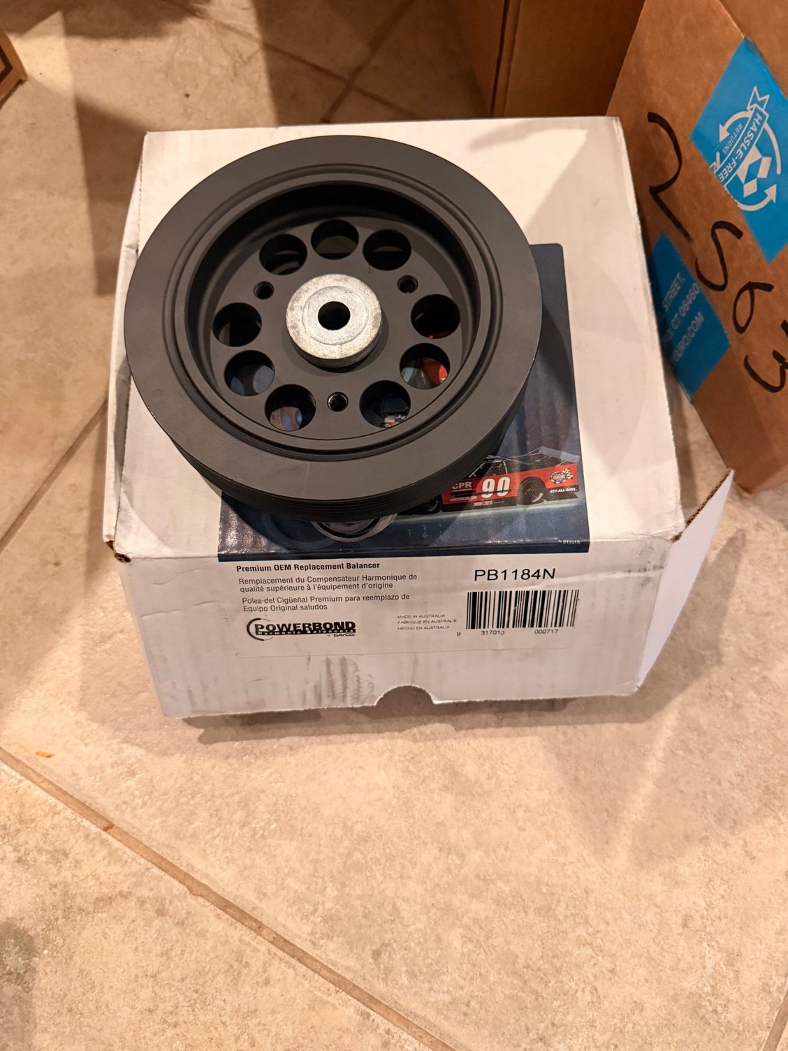

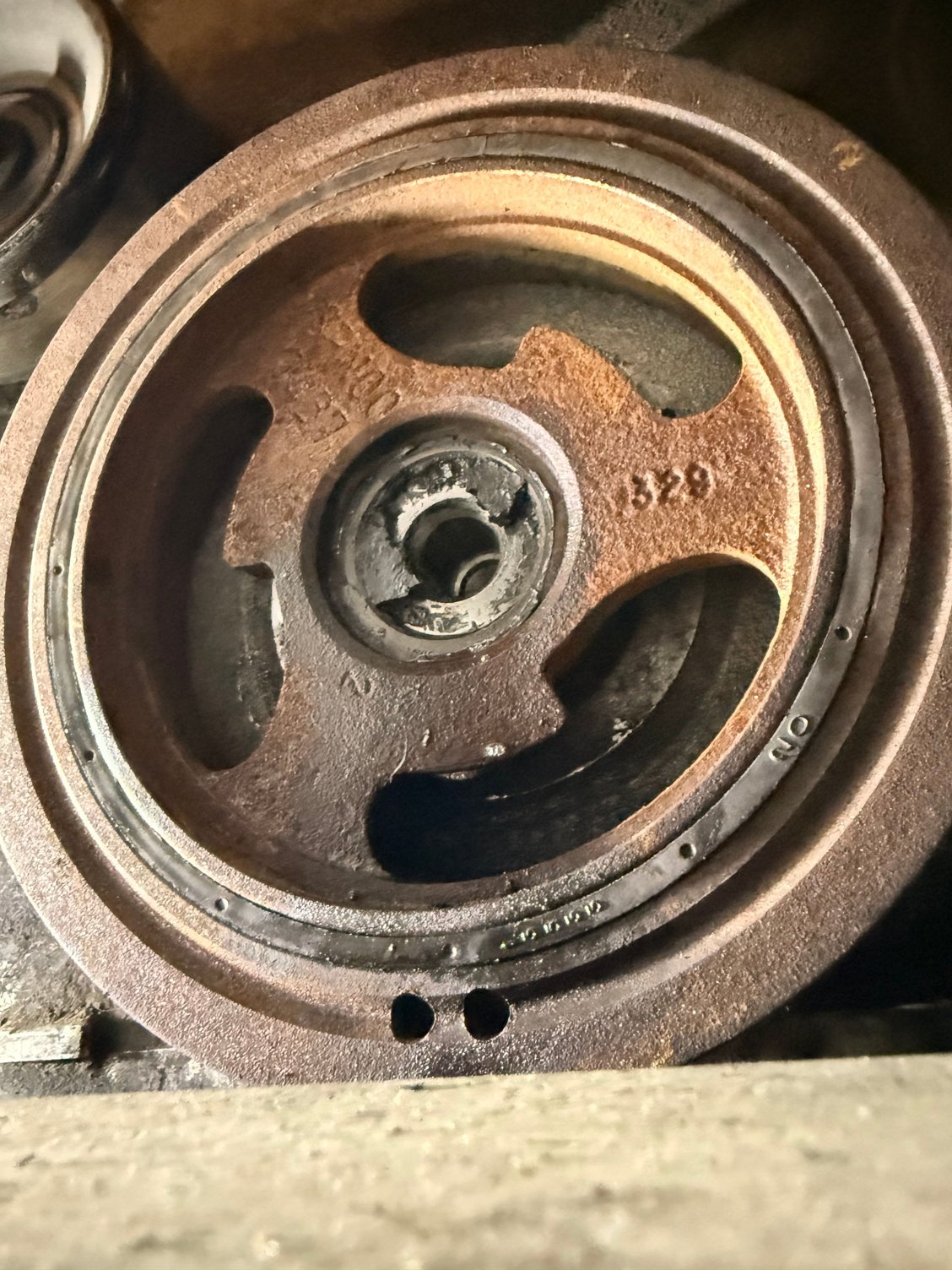

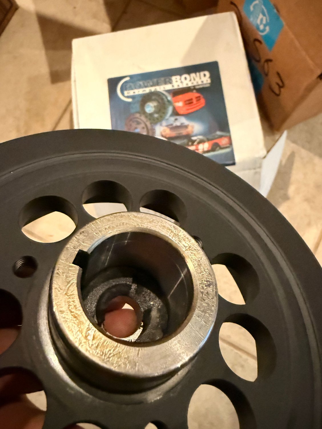

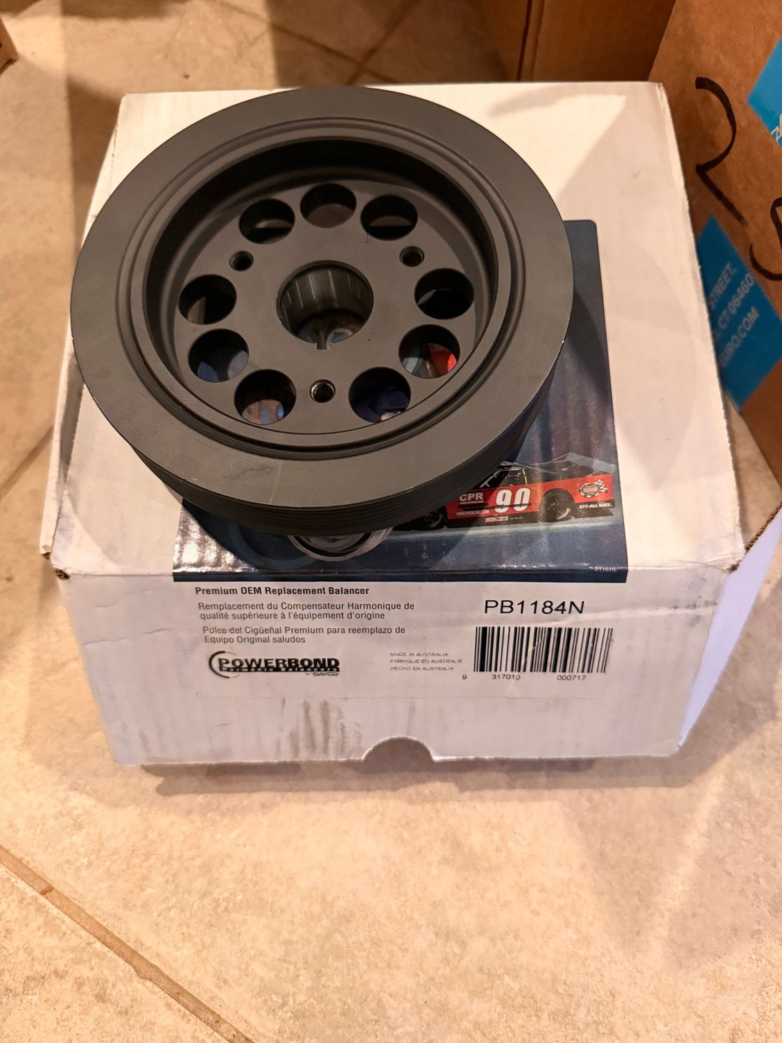

The new pulley is obviously a newer design, and if you look at the key way for the crankshaft, the old one has a recessed area the washer sits down in ~1/8-1/4”, whereas the new one is flat. I’m a little concerned this will affect thread engagement length on the new bolt. However, when I fit the washer with the bits of gasket still on it, it fits precisely in the new pulley.
I also ordered two new different types of pullers, will report back on Saturday if either worked.
Old Pulley with washer mocked in place:
New Pulley:
New Pullers:

Either puller will work, I've used a 3-jaw type multiple times for this. The second puller you show could have issues of the rubber bonding comes apart. You need to replace the bolt and use some RTV so oil doesn't weep thru the surface.

Thanks! I really appreciate all the help. The rubber bonding already looks like it’s coming apart, hence the replacement, that’s a good thought to try the other puller first. What started this is I noticed the pulley had a minor up/down movement to it and then I noticed the rubber bulging a bit on one side of it. It wasn’t slipping yet, but I was worried it could be causing vibrations.
Since I’m not replacing due to a leak and am not pulling the timing cover, do you think it’s necessary to replace the crank seal behind the balancer? Can it even be replaced without removing the cover? It’s not leaking currently, the car only has 26k miles, and I didn’t order/anticipate replacing it, but now I’m worried I might regret it. Does it do anything to locate/steady the crank/balancer or is it just there to keep oil in?
Also, any thoughts on the recessed area for the washer on the original pulley and the flat face on the new one? Should I still be using the same washer? (Photos of this posted above).

Anytime a component is changed the seal should be also. It can be done without front cover removal, although it's a special tool or equivalent to do so. You may do more damage than good trying to replace the seal. Clean the new damper sealing surface and apply a rubber friendly grease or engine oil. Reuse the washer after cleaning all the old RTV off and apply a small bead of RTV to the center of the washer.

It’s off and the new one is on. FWIW, the only puller I could make work is the one that grabbed it by the ridges, which actually worked really easily. I’ve gotten all of the other pulleys replaced while I’m waiting on the ultra black to cure on the crank washer.

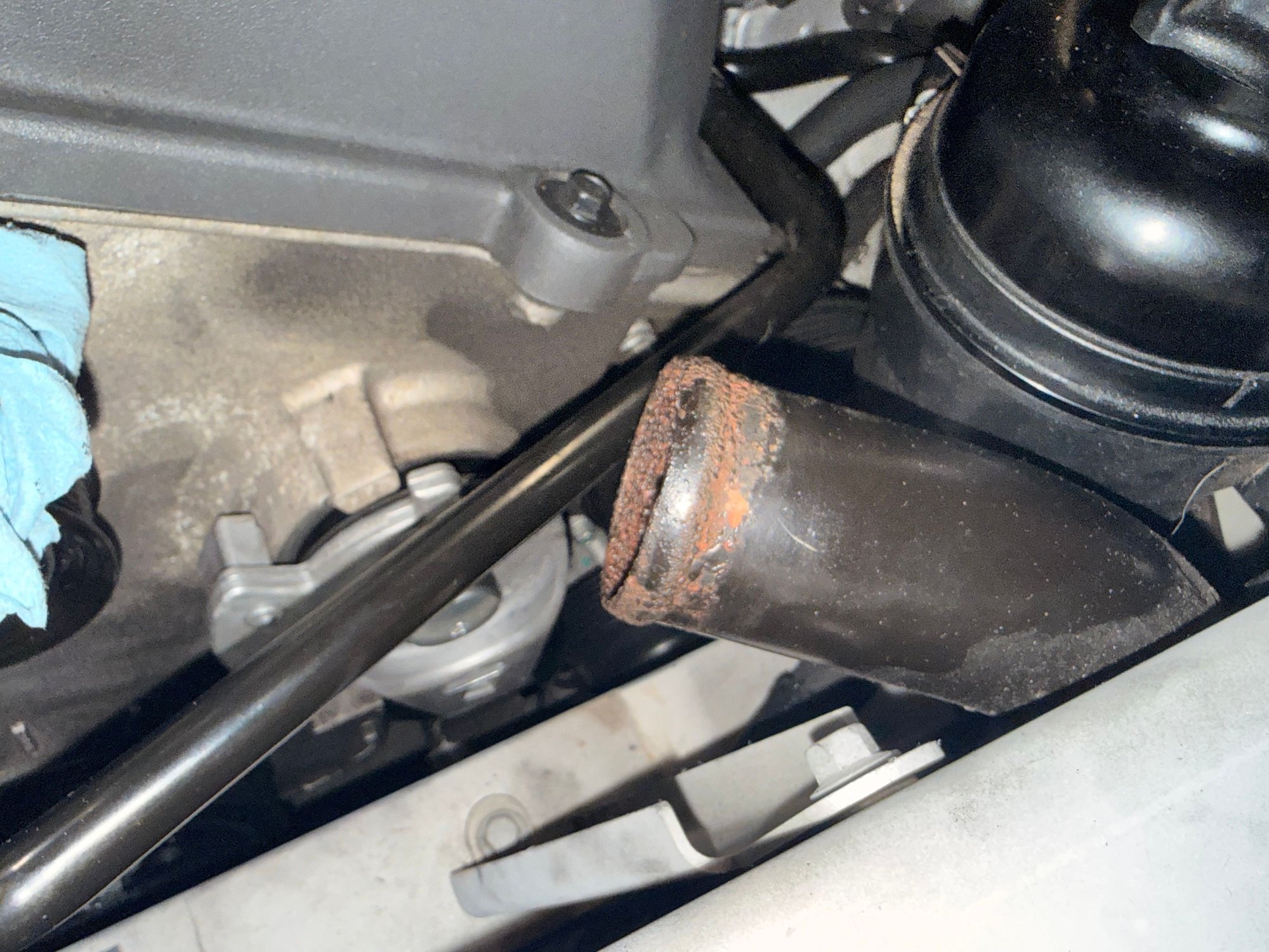

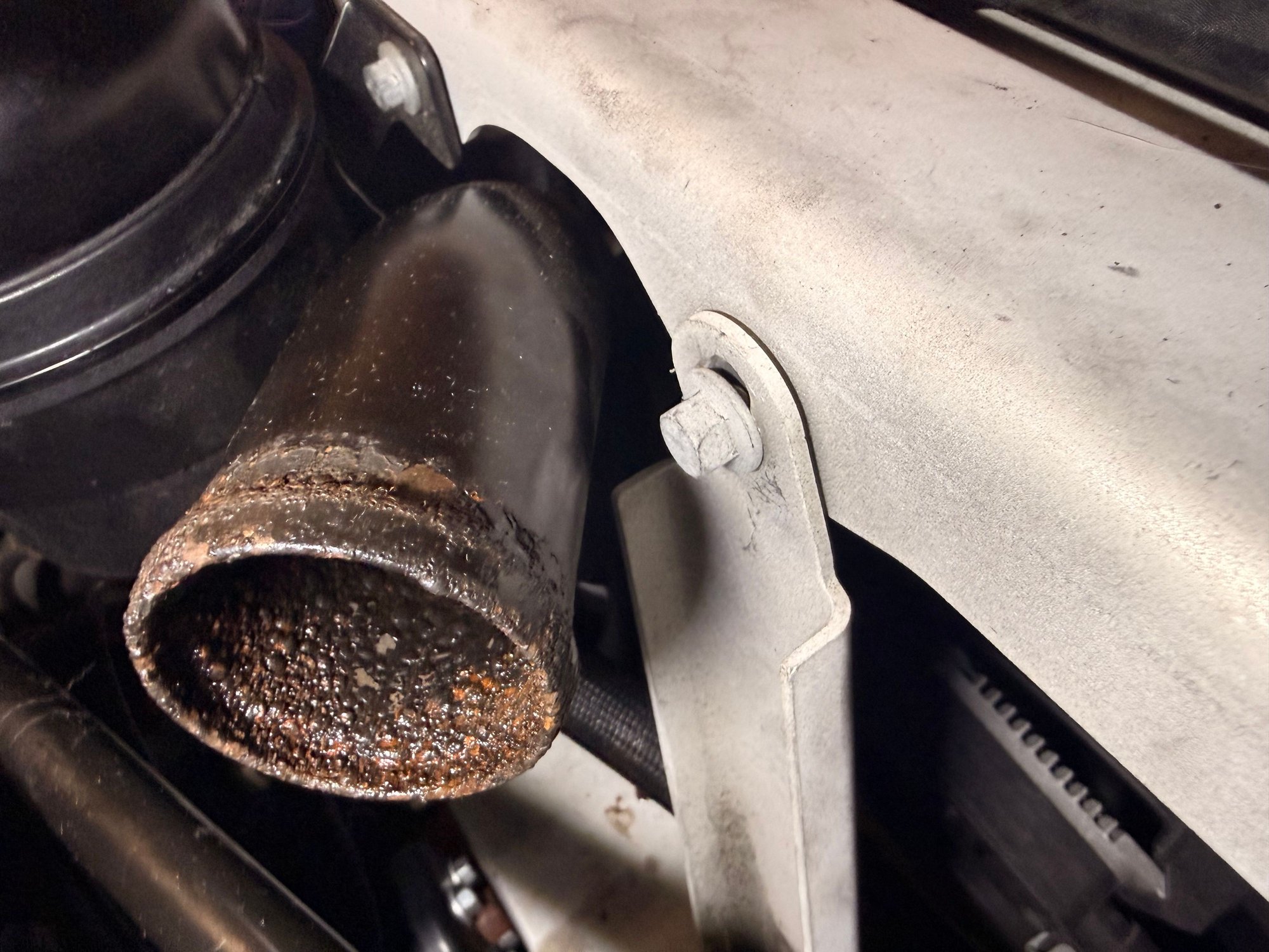

I pulled one of the upper radiator hoses to make my life easier installing the belt tensioner. There is a metal manifold that it attaches to, opposite the thermostat housing. Upon pulling the hose, it looks like this, how concerned should I be about replacing this manifold right now and/or the possibility other rust could be in the system? I was able to drain about 2.25 gallons out of the system, and there was not any debris in coolant that I saw (bucket wasn’t entirely clean to being with).

WRT your cooling system - a prior owner didn't love the car as much as you and let the coolant go too long, and/or added tap water to it. If you buy 4 gallons of distilled (not spring) water and fill/drain after getting it up to temp a couple of times you can get all the old out. Then drain the last time and add in straight coolant. That got me close to 50/50. I've also bought some test strips so I can monitor the ph of my coolant (and brake fluid).
