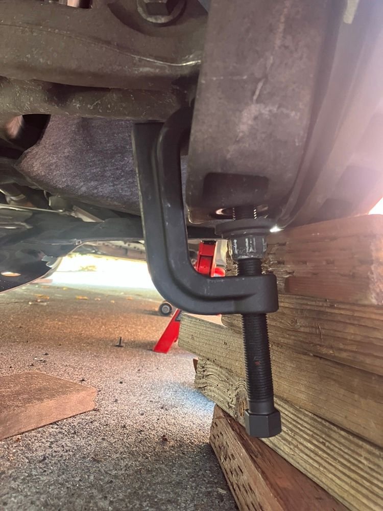

Good evening,
I am trying to remove the LCA on my 2010 Rapide, so I can replace the bushings and ball joint.
Has anybody ever done that? What splitter did you use?
I got a standard ball joint splitter but it is too short, it won't reach the end of the bolt.
The workshop manual is calling for special tool 43-28147 but no way I can find one of these...
I am going to try another splitter, and give it a shot...
Any help appreciated.
Thank you!

Just to circle back on this one, I finally found a low profile splitter that would fit on our cars: Astro 78912
Got mine off Walmart, worked like a charm!
