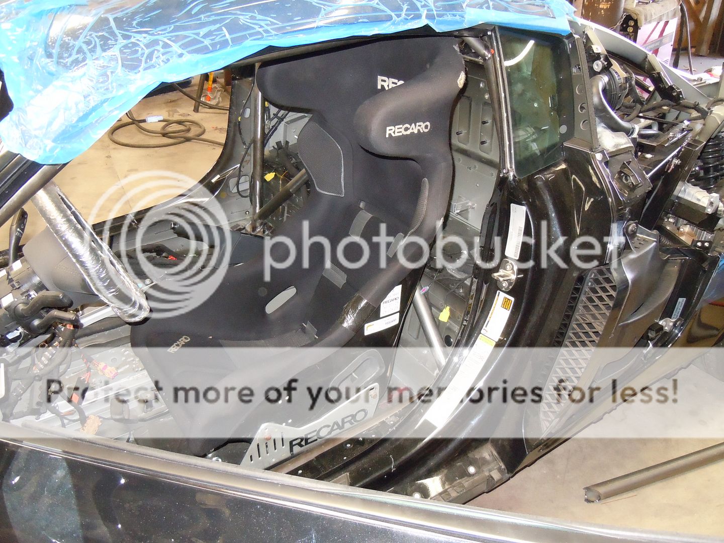

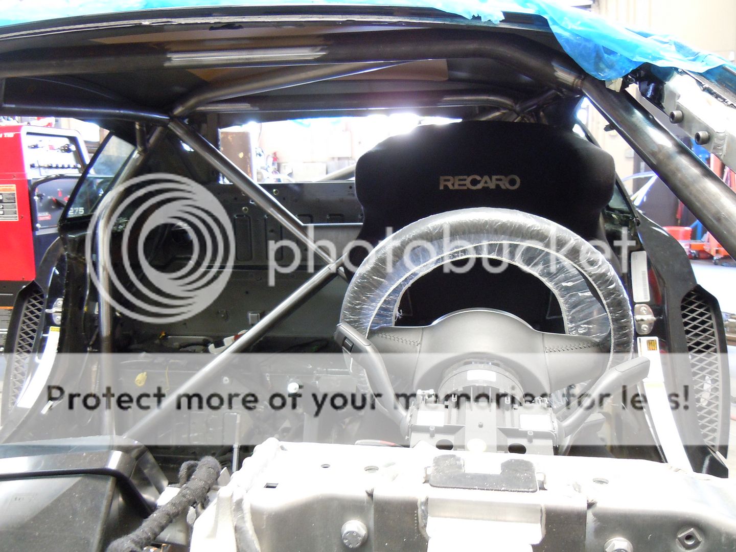

Well as projects sometime go, enough is never enough. Our client with one of our signature GMG R8 V10 LeMans 780 Twin Turbo kits decided it was time to build the ultimate R8, and what better way to achieve that goal then to build a full blown race car.
The pictures below document the process that we're taking to achieve his desired result. As far as we know, this is the only type of R8 build in existence at the moment, and we're more than excited with the progress thus far.
Enjoy!
The seat fitment:

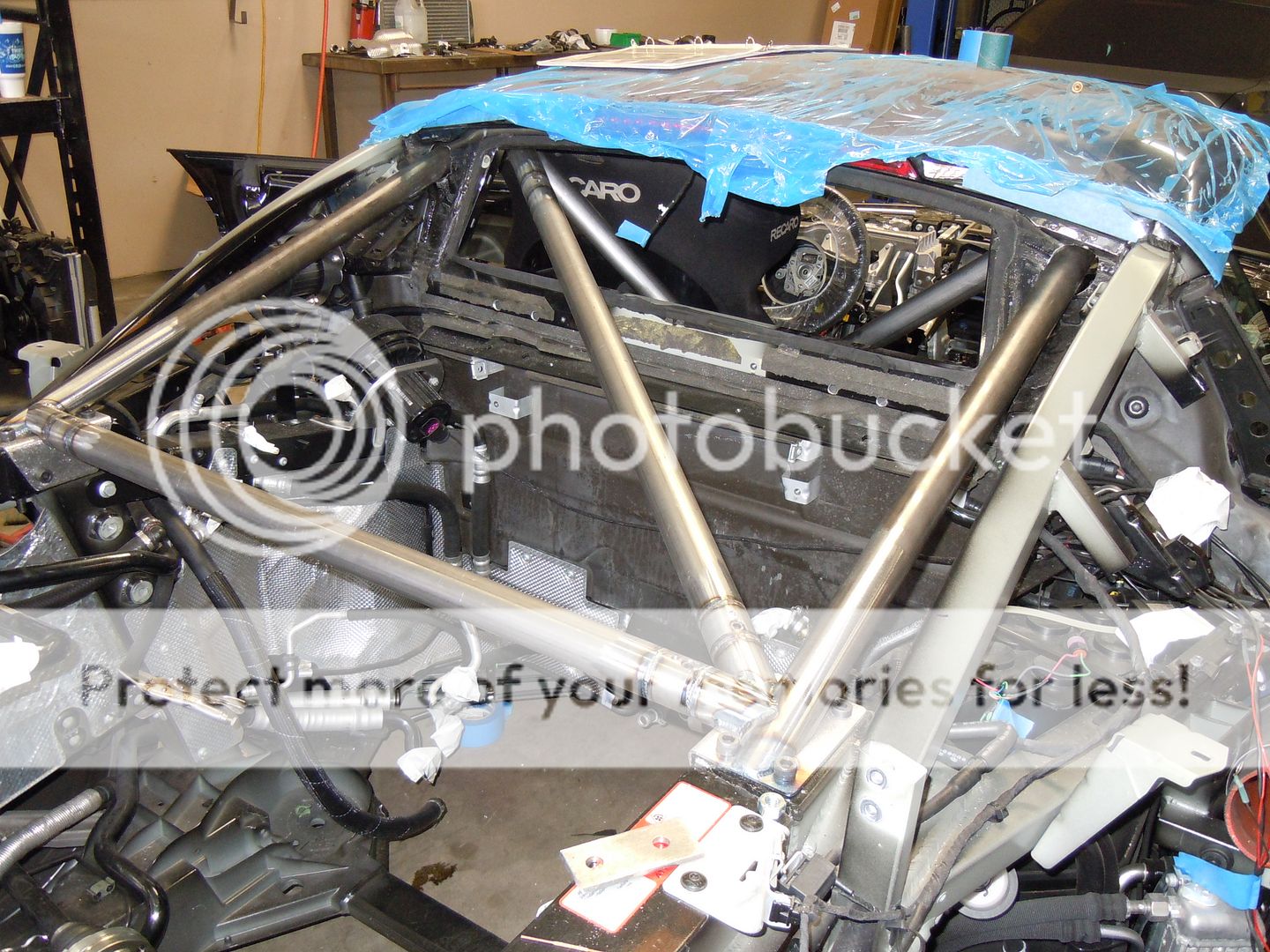

The process of building the cage into the car is very complex, as it simply cannot be welded to the chassis. The car is aluminum and the cage chromoly, so the cage has to be welded together in the car, the chassis is then reinforced and finally the cage is bolted to the chassis, just like the LMS race car.
The rear section has CNC machined couplers to allow access for engine removal :
We will update this thread as progress continues. Cheers!
