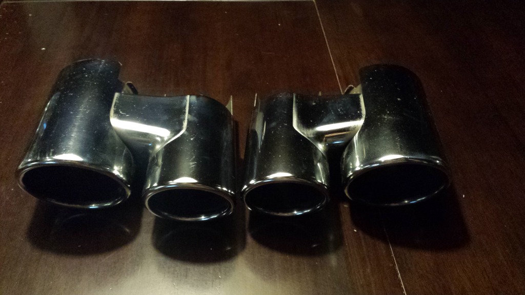

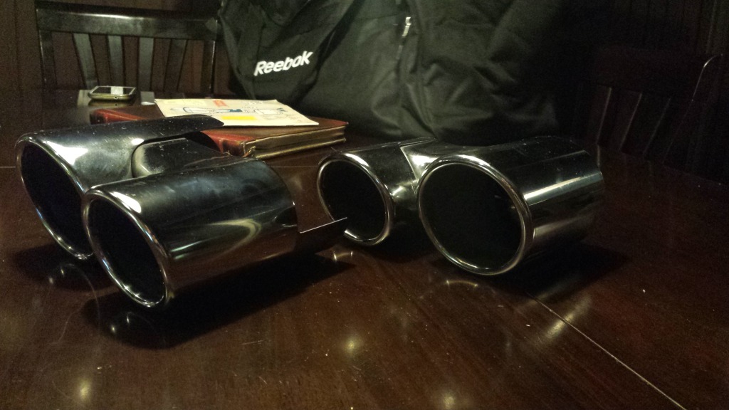

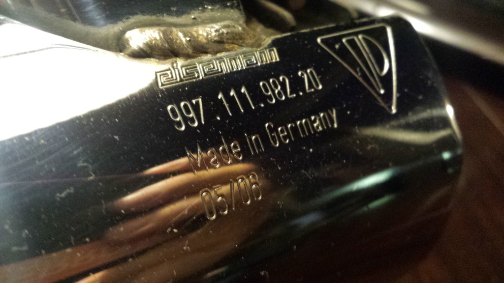

Porsche quad exhaust tips. Came off a 2006 997 C4S,has a small scratch on the lower tip not visible when tips are installed,Thanks for looking.8/10
