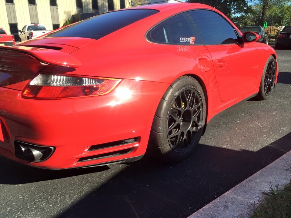

Dusted off the good'ole dancin' shoes.... Hopefully Atco tomorrow
