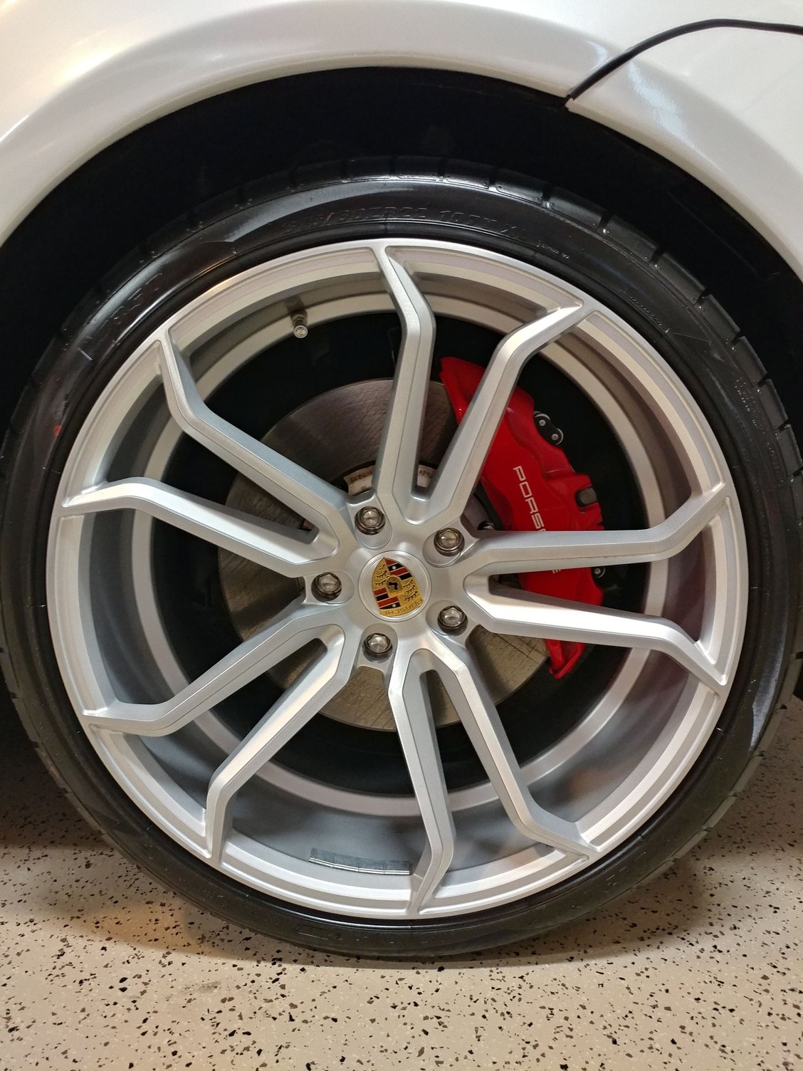

Looking for a set. On eBay came across some of these
Anyone have experience or info on these?
Price appears awesome. Black would be perfect for me.
They are 14x1.5 28mm long, spline, and black. Set of 20 for $32 shipped.
My rear tires have 8mm spacers, but I dont think I would need longer bolts (until I contemplate getting 15mm spacers, then would need longer).

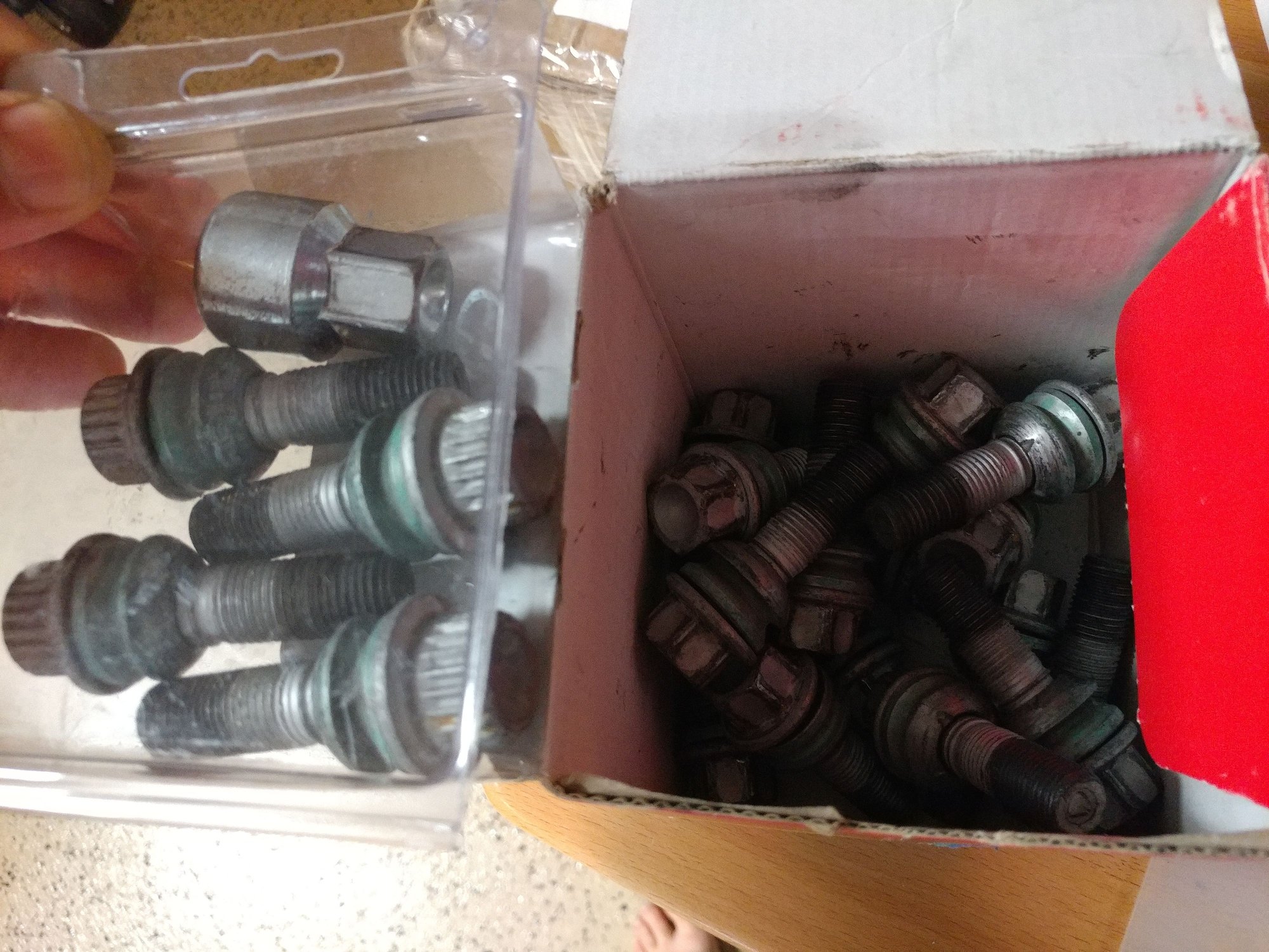

Those won't work for you if you're running OEM Porsche wheels. Those "tuner" lug bolts have a conical or tapered seat and Porsche wheels use a ball or radius seat. The seat is important for the bolts to torque down and hold the wheels properly. Also, an 8mm spacer is enough extra length where you should be running a longer lug bolt (3 mm wouldn't matter). I have a set of OEM lug bolts I just pulled off my 28,000 mile Cayenne, which are longer than the 997 bolts and I'm assuming longer than the Panamera bolts that I haven't yet listed for sale. They include the locking ones and the key for the locking ones. If you're interested, let me know and I'll figure out a price.
If you're looking for something with a nicer finish than the OEM steel lug bolts, I'd recommend World Motorsports Titanium versions - I run these on my 997 (lug nuts) and on my Cayenne.
