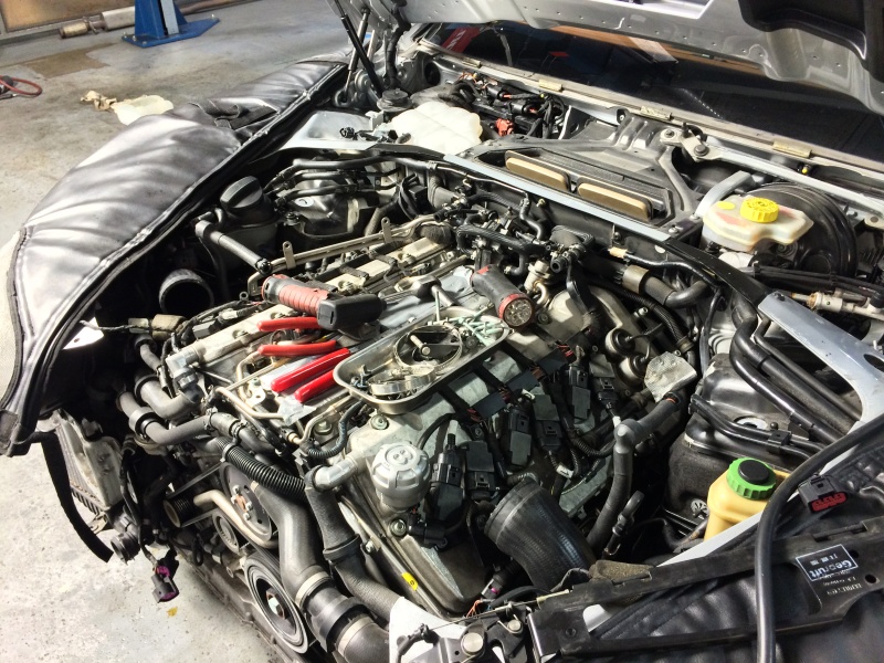

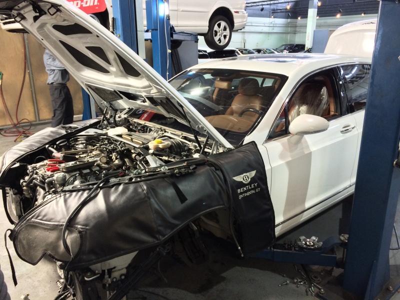

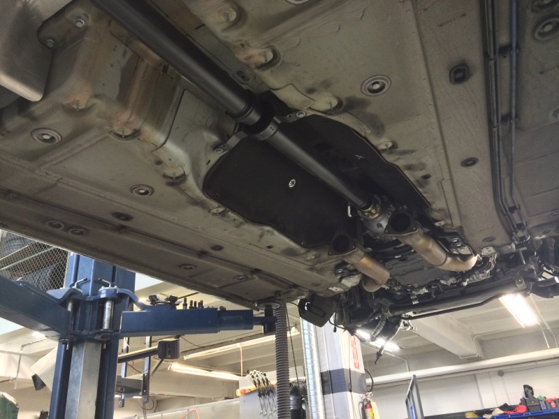

Had a check engine light few weeks ago, took it down to the local Bentley dealer to be diagnosed. Turned out the car was misfiring in one cylinder and the gas temp sensors were shot. The fix for the misfire was a faulty injector.
Then came the EGT sensors. Driver side sensor was replaced without any issues, the passenger side sensor came out with the threads... the dealer tried to re thread the manifold to no avail, so the motor had to come out! Hopefully pick the car up Friday, the control arms are being replaced as well.
Some pics, didn't catch any with the motor fully out

Thx for pics and WOW they really pack in the engine on these cars.
no prob and yes they do, it's crazy how tight it is

hope you will not have any issues again, and many thanks for posting the pics
