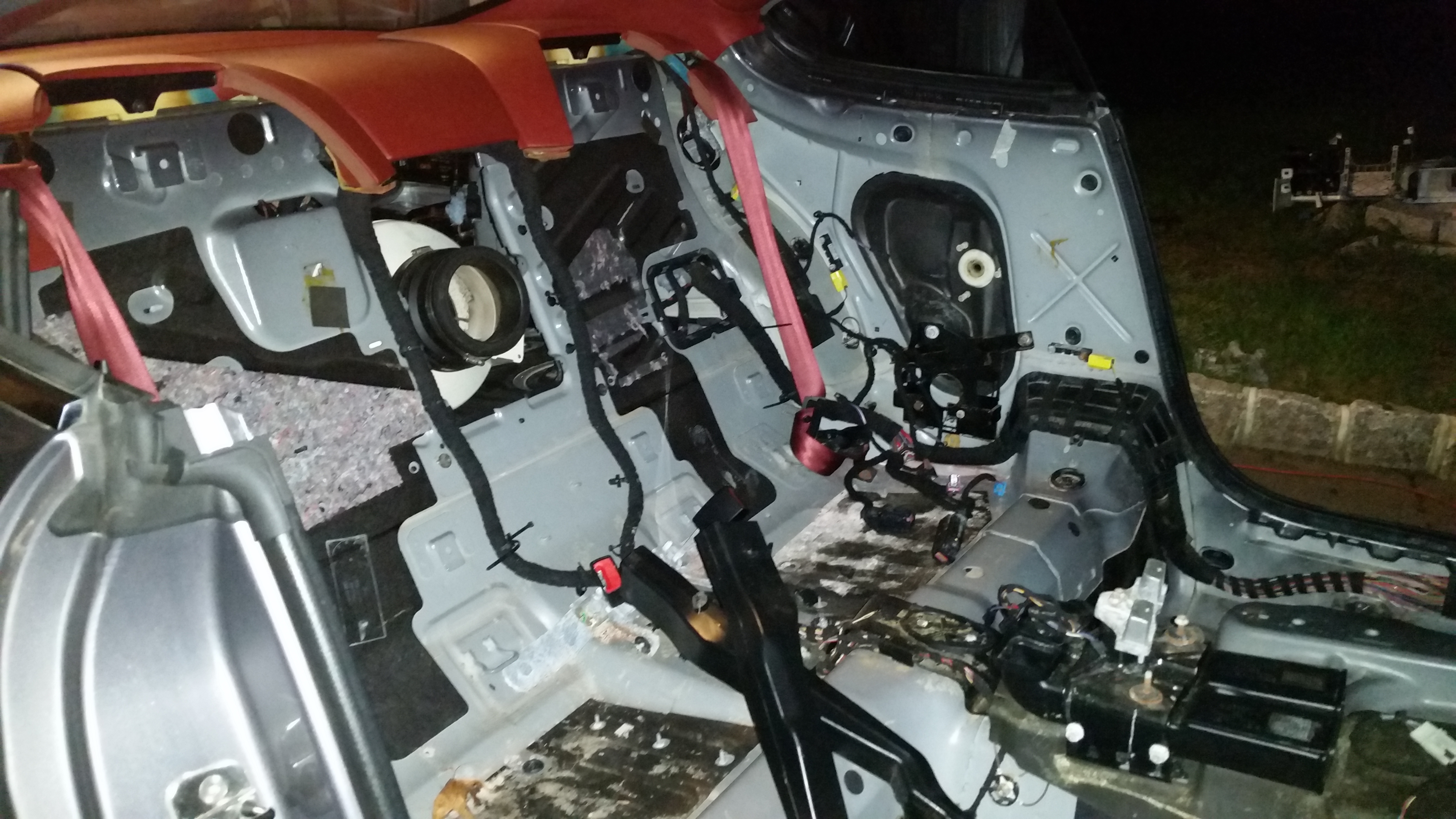

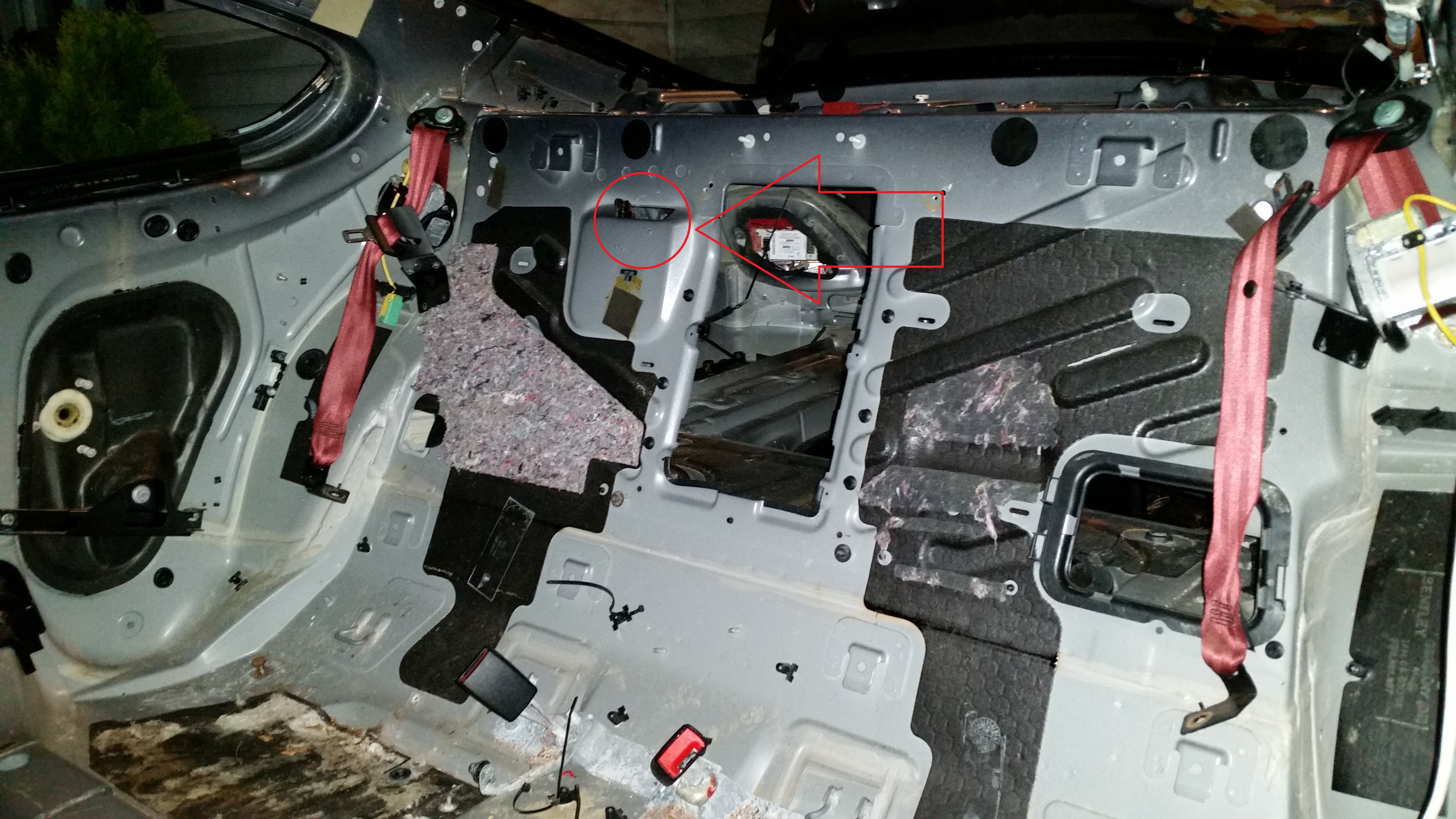

Originally Posted by lefizzet
First and foremost, I did tons of research on this topic and nothing has worked so far.
I saw this video which has been posted numerous times on here https://www.youtube.com/watch?v=XErgTtr0bN8, but when I try removing the left air filter, it doesn't even budge. It seems to be connected to something else on the bottom as well, since after removing the 10mm screw on top as shown in the video, I can barely get it to move afterwards.
As the emergency trunk release handle is also electronically operated... that option is exhausted as well.
I have no idea what to do at this point.
Any help is appreciated, thanks.
Good morning Lefizzet,
If for some reason to still cannot remove the air filter lower box, the NON electric emergency trunk release lever is located behind the right rear upper seat, you would pop the lower section of the seat out as it just snaps in place, so you would lift the front of the lower section up and out, next you will see the 1 torx bolt at the bottom holding the vertical portion of the rear seat in place, remove bolt and slide the seat down so it releases from the upper mounting apparatus, you will now see the black metal trunk release lever, it does require some strength to unlatch, and if you could have a second person gently push down on the truck lid and then lift as you operate the lever it would help.
ID:	474267   Click image for larger version
