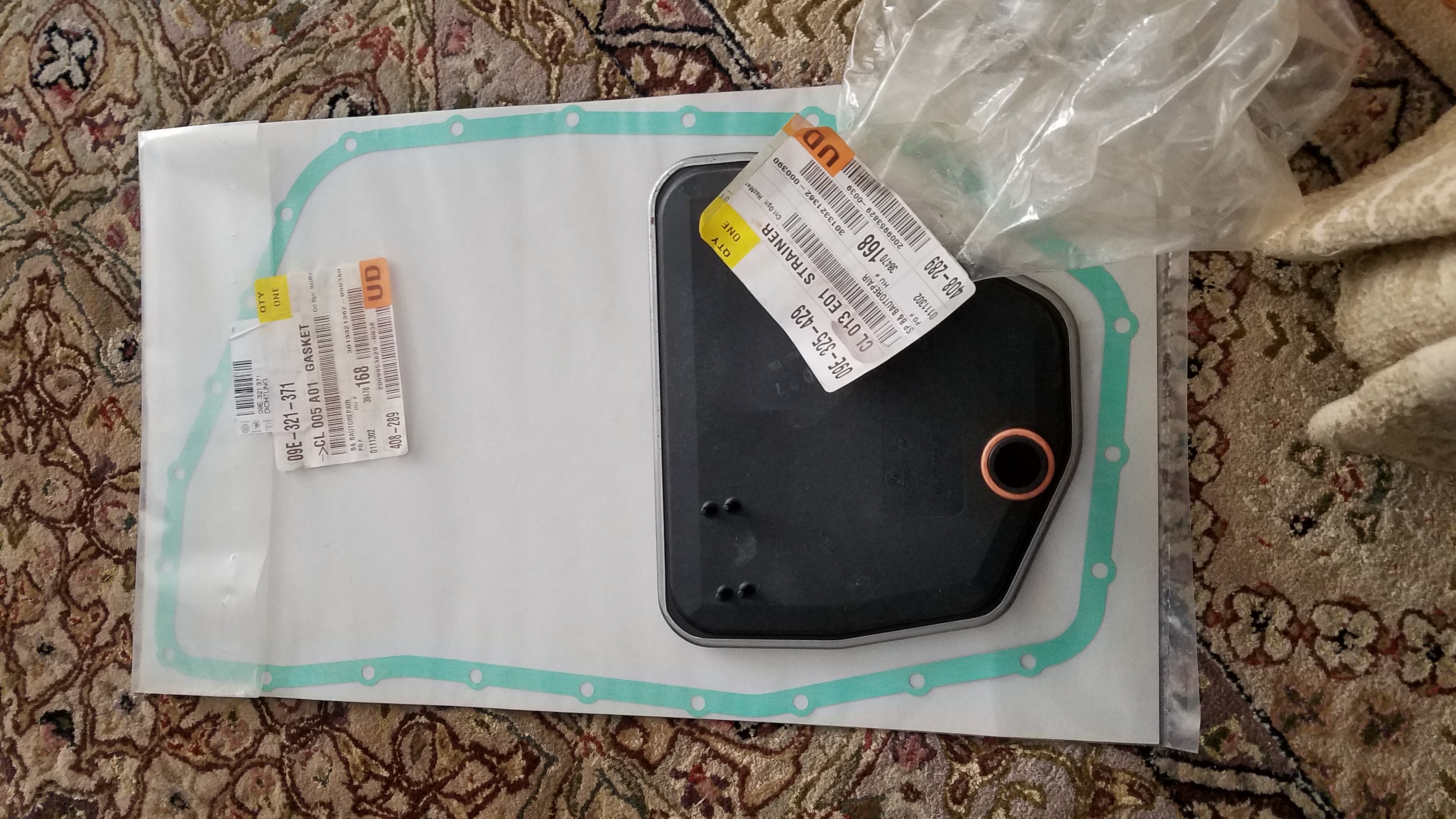

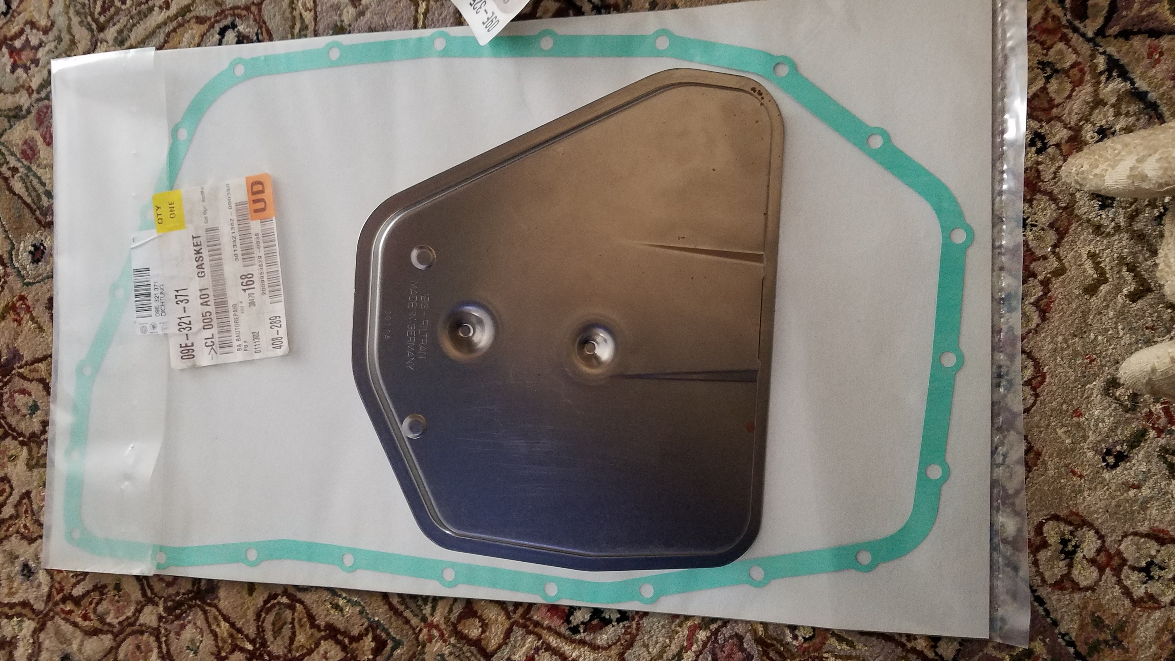

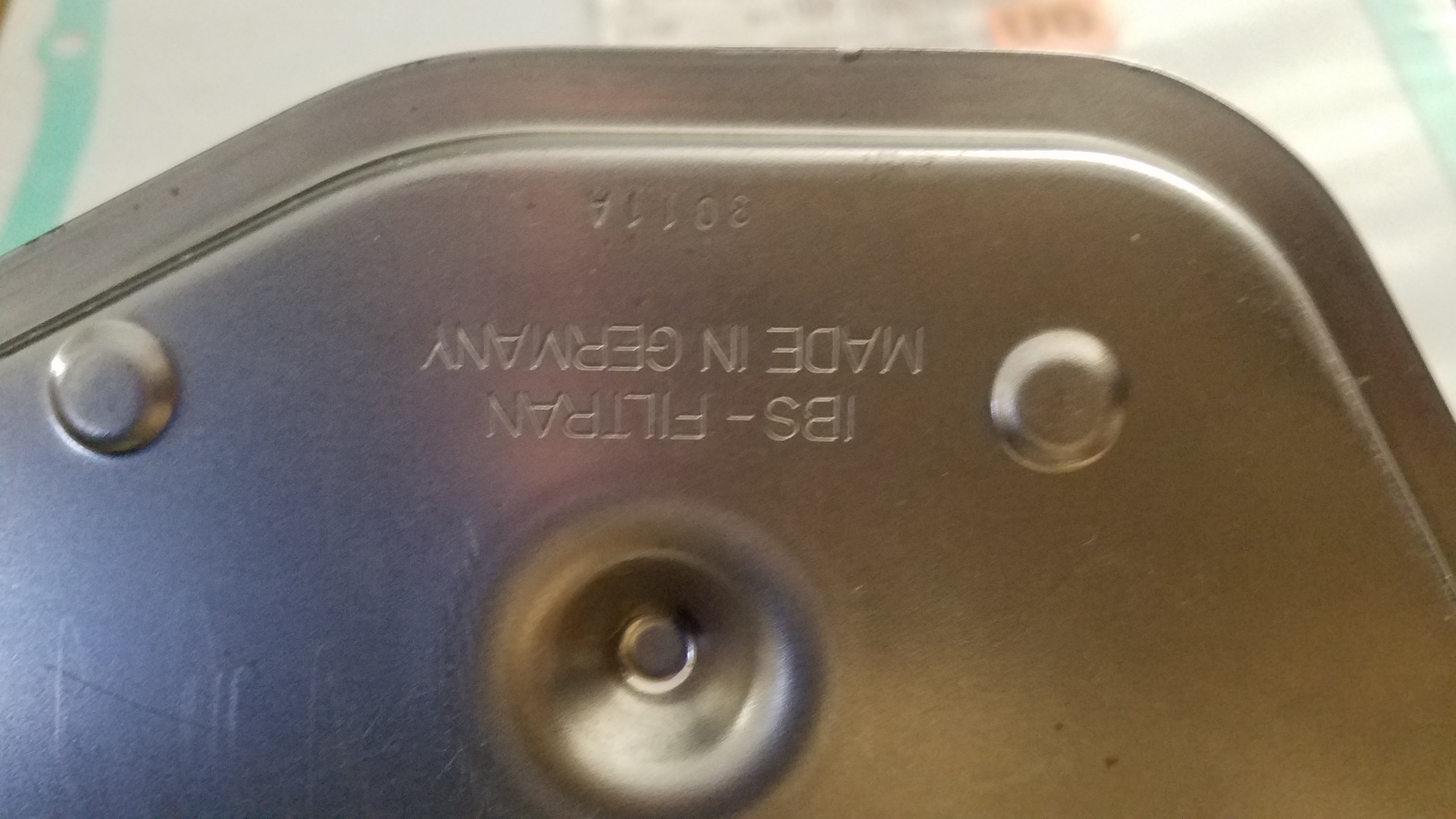

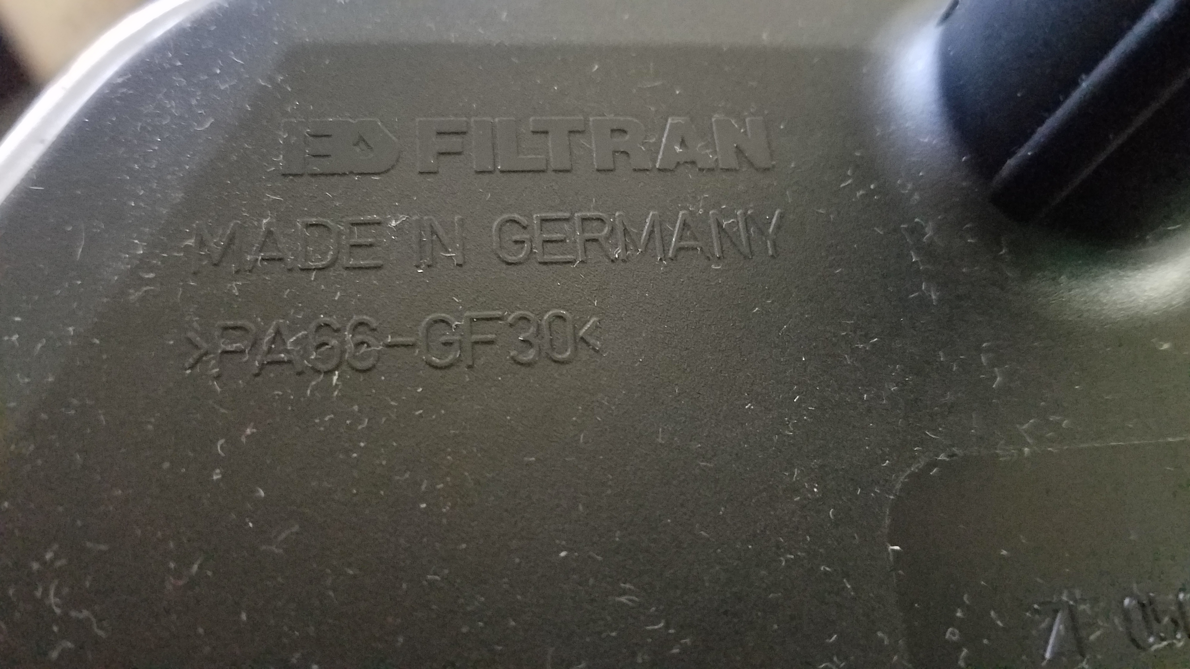

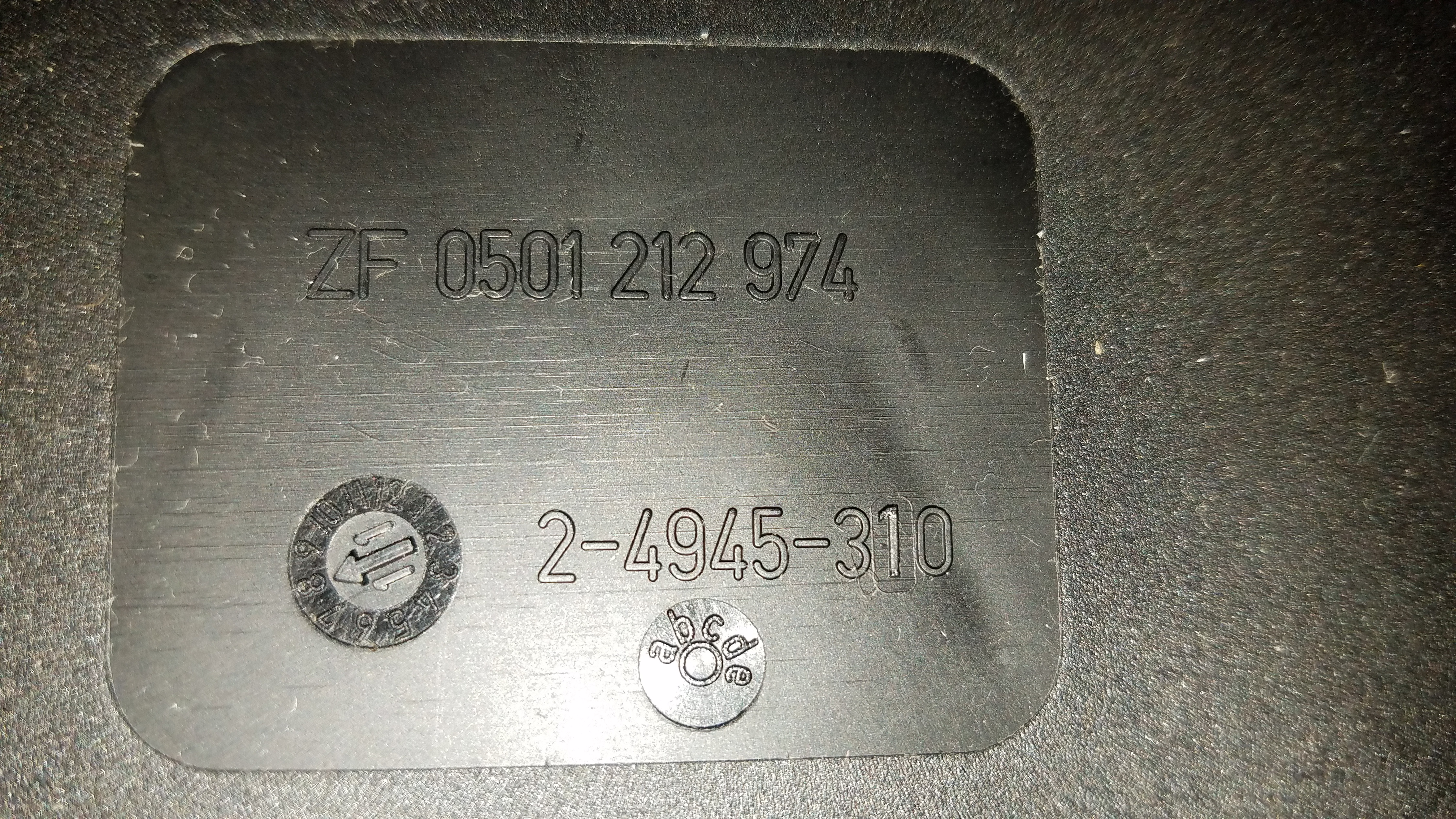

Hello Chris,
The "filter" is inside the transmission, so it is not leaking, what the service adviser most likely meant is that the transmission pan is leaking, now you could look at this a few ways, you could just have the pan bolts snugged up and top off the tranny fluid at the proper fluid temperature of 30-35 Celsius, 40 Celsius max, but never allow the fluid temperature to reach 50 Celsius, see attached link for proper checking and filling instructions, and wait to see if the seepage stops, who knows how long it took to get to the low level it is at now, ALSO by going this route you would be just topping off the trans to the proper level and the see how she behaves, meaning if all is now shifting fine after top off you can then see if the leakage stopped and leave it alone, OR because you are at 70K you may want to drop the pan and install the new filter and pan gasket, you will lose tranny fluid dropping the pan, so that is where some expense will come in, BUT not $2200.00, that is if you are comfortable doing it yourself..
In the pictures below you will see the parts I purchased at Audi, this is the same gasket for the Bentley 6HP26A, I just went outside and matched it up, it would be interesting to see how much B charges for the same gasket.....
NOTE: The ZF instructions although they do not mention Bentley, it is the procedure for checking the fluid level on the 6HP26A transmission, so I added it just as a guide.
http://www.vaglinks.com/Docs/Catalog...28_Catalog.pdf
http://www.flyingspares.com/shop/ben...nv862564a.html
Amazon Amazon
https://www.automaticchoice.com/uplo...zf_filters.pdf
https://www.car-parts24.com/Oil-chan...sion-6HP26-A61
http://www.americanpowertrainwarehou...n-aftermarket/
