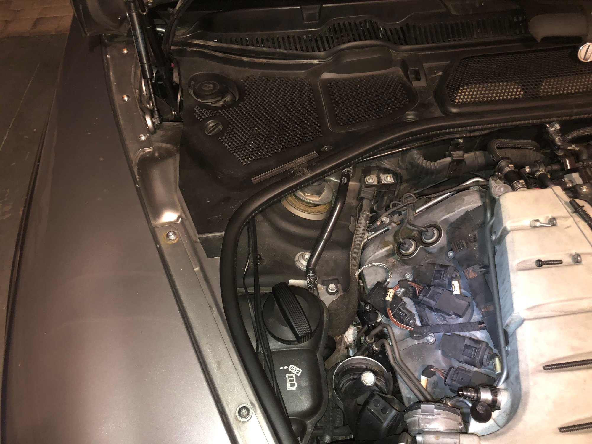

thanks for the quick response! I took a look and i'm not finding anything there but two bolts about 2" apart, but im not sure if this is what you're referring to?
And are there any pictures of what you're referring to?

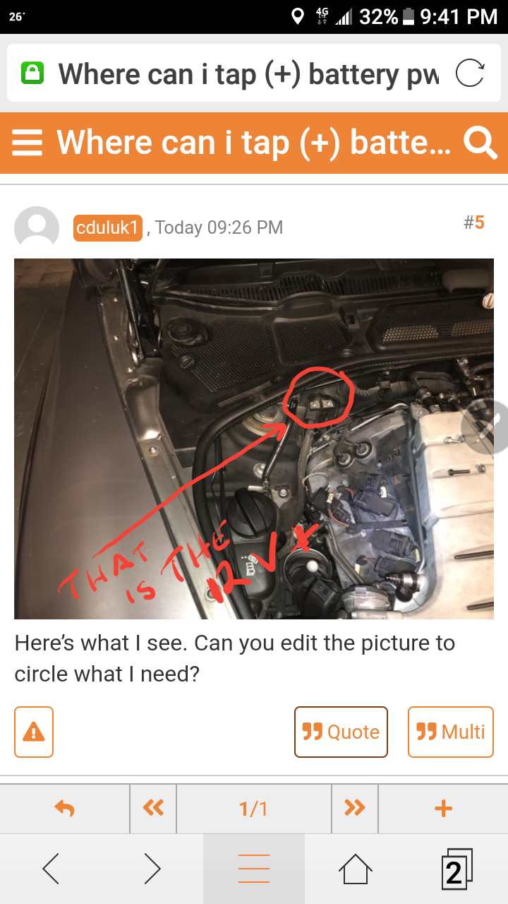

Here’s what I see. Can you edit the picture to circle what I need?
