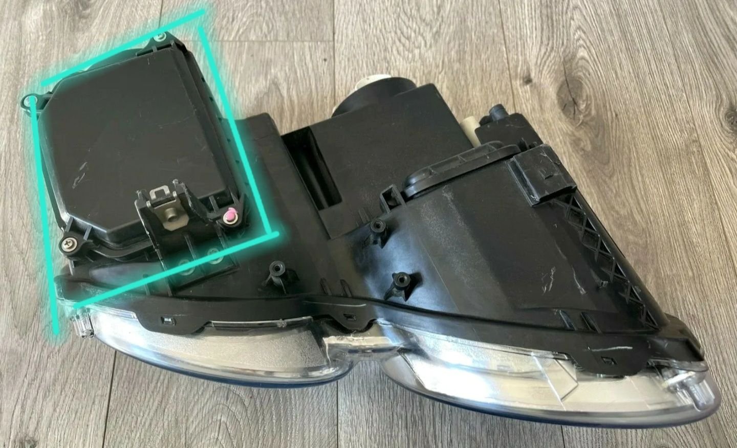

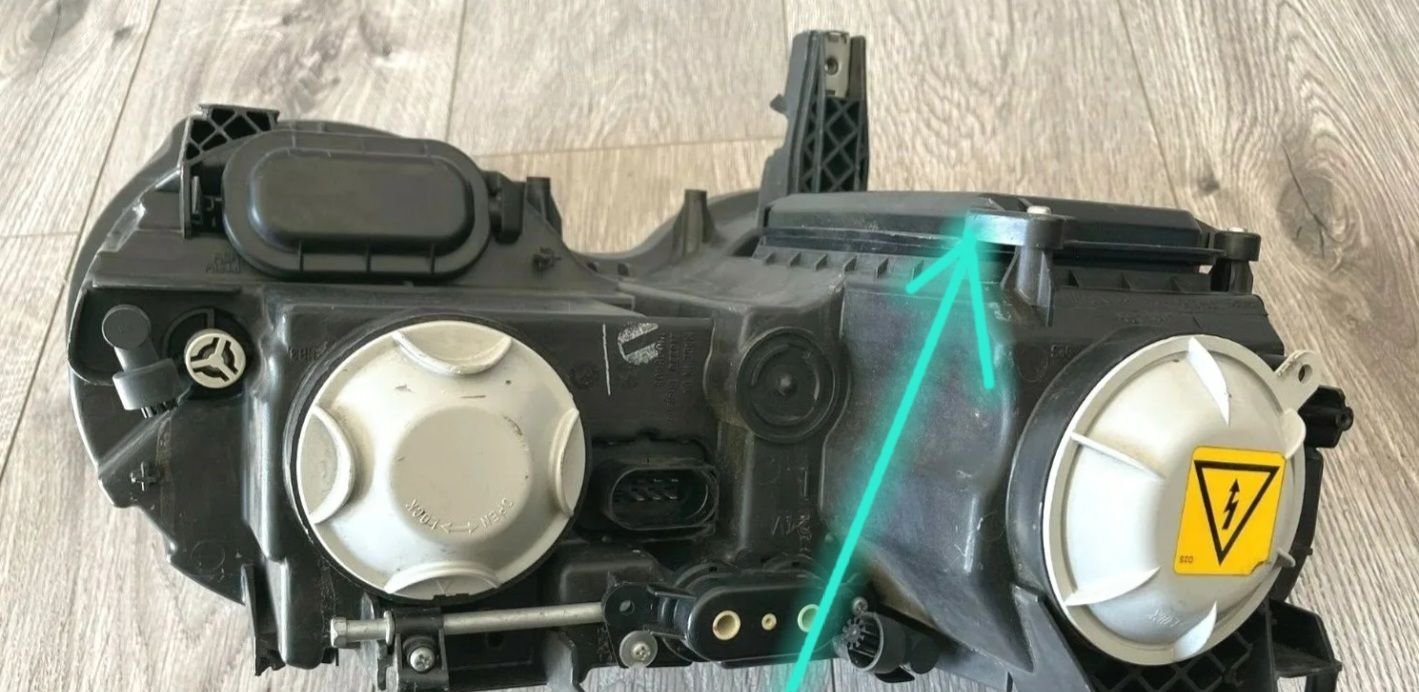

what "ballast" you are talking about?
Old Jan 24, 2023 | 10:49 AM
Johnny Hotspur GT's Avatar
Administrator
Joined: Jul 2014
Posts: 3,956
From: Montgomery NJ
Rep Power: 1002
Johnny Hotspur GT Is a GOD !Johnny Hotspur GT Is a GOD !Johnny Hotspur GT Is a GOD !Johnny Hotspur GT Is a GOD !Johnny Hotspur GT Is a GOD !Johnny Hotspur GT Is a GOD !Johnny Hotspur GT Is a GOD !Johnny Hotspur GT Is a GOD !Johnny Hotspur GT Is a GOD !Johnny Hotspur GT Is a GOD !Johnny Hotspur GT Is a GOD !
@sazam ,
The headlight ballast...
Johnny
