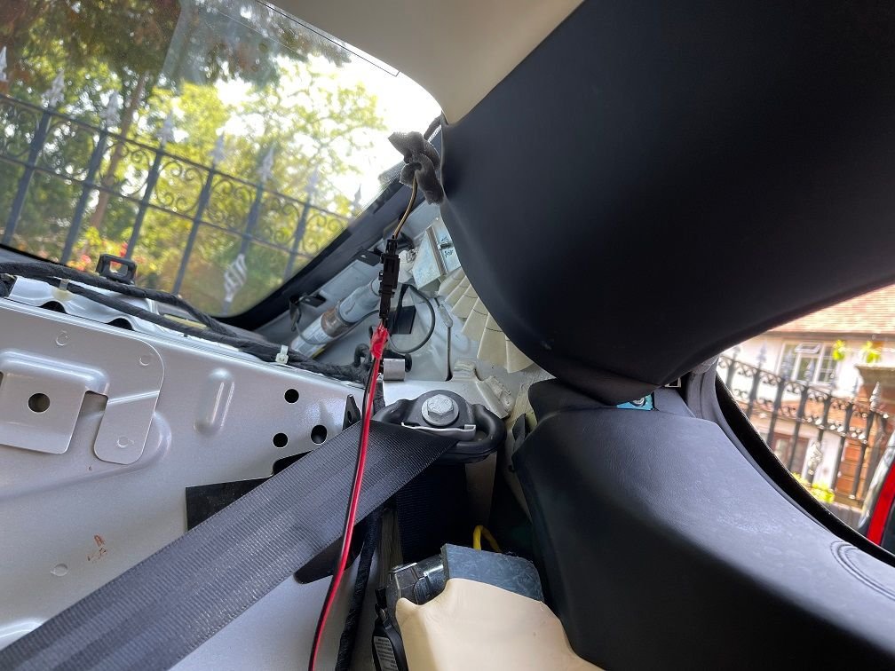

Ok, I have done the work around, and it worked perfect. I am not fussed about having a third brake light, plus the cost of replacement and fitting is huge. it is a very easy job to do, and it cost me £11.99 for a 12v led light pack, will post photos of the one I used, but plenty around. There is a post on here that shows which panels to remove on the left rear corner, https://www.6speedonline.com/forums/...ent-howto.html

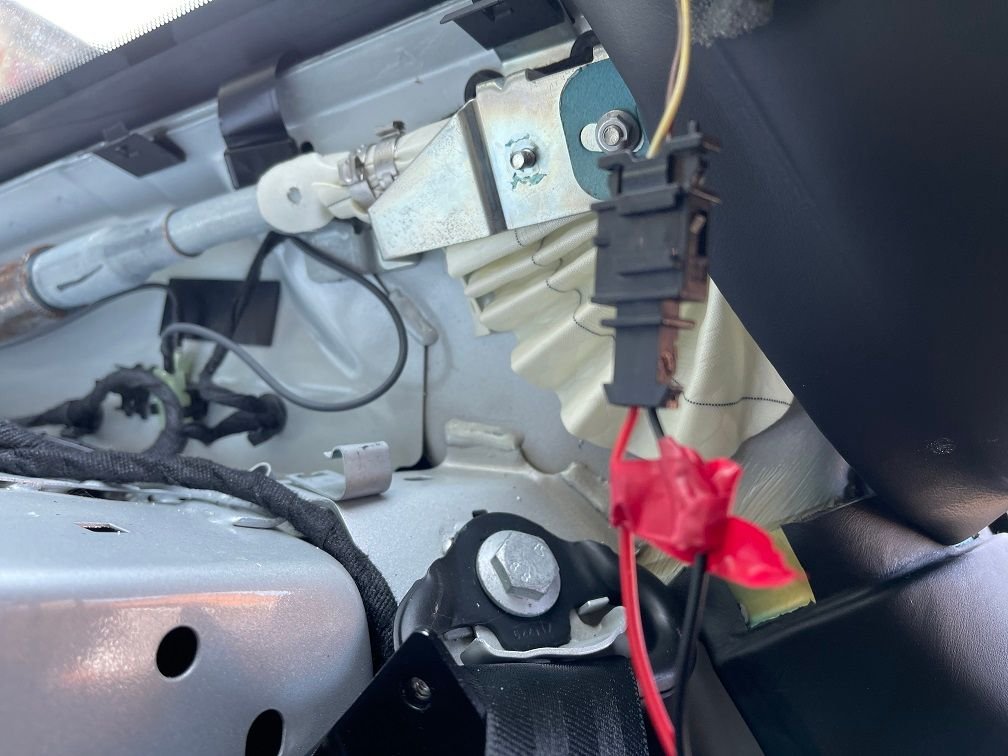

takes around 20 mins, once done you will be able to get your hand under the corner of the roof lining, and feel and pull the third light connector. There is plenty of slack so you should be able to pull it out. Disconnect the connector. The red and black wire side of the connector is the one that goes to brake light, the brown and green is the power going to it. So snip off the wires on the red and black wire connector, we want to use this connector again...(leave enough to connect the new wires to connector),.. Than use the snipped off connector and attach the new led light wires to it. Once done connect back to power by pushing the connectors back together. Than test, put brake lights on and the new led should light up. If all good, tuck the wires and leave under the roof lining, and put back the trim and seat.
All your doing is tricking the system to think the third brake light is working, which gets rid of the fault code and warning light.
Do not forget to plug in and delete codes out, as it will sometime keep coming up brake light not working, until you clear the codes fully.
it is as easy as that folks.
The photos of the wire were taken in the test stage, I then connected and joined the wires properly. So ignore the rough tape Lol.

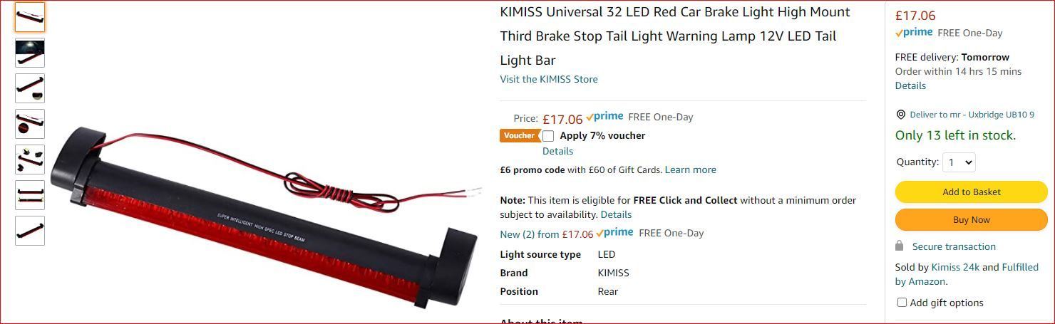

The led I used above still intermittency had the brake light warning come up only on start up. Going into the central can on the code read, it was coming up short to ground on the fault code for the third brake light. This meant the led I used was not big enough and not having the current to tell the car it was working. I changed the led to another larger one, even double sided this one to the rear windscreen top, which means i now have a working third brake light, no codes, no error messages. Fixed permanent for £17, 15 mins work, and still have a third brake light (although smaller) for the mot tests.
