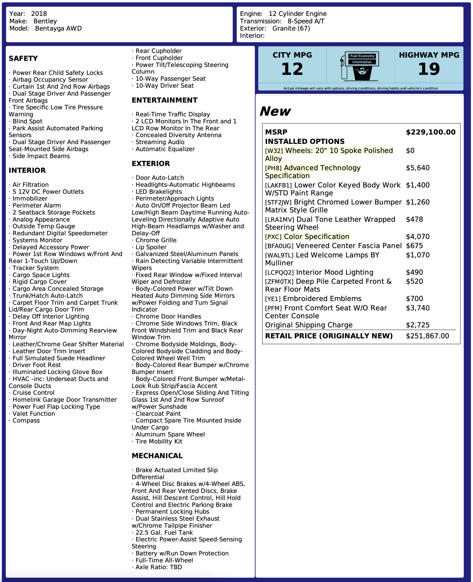

Thanks, Johnny. Yes, the figures have me wondering, too. I believe it's the standard brake setup. I've attached the spec sheet. I don't mind getting the brake pads replaced. I'm assuming it's 2-3 hours in labor and I can probably find a new set of pads online for a few hundred bucks?

The standard brakes are cast iron rotors and I do not see the CC listed in the options on the window sticker you provided. I believe the CC are only available as an option on the Speed model. BTW that is not the original Window Sticker for the car, which would contain more information.
You should be able to obtain the full vehicle specification from the dealer (if Bentley) or by e-mailing to the following
To: contactbentley@contact.bentleymotors.com
Subject: Full Build Specification Document For SCBCXXXXXXXXXXXXXX
Within the build document for my 2020 Conti GT, it clearly spells out the brakes (as well as everything else in the vehicle), something good to have if you purchase the vehicle,
Cast Iron Front Disc Brakes, 420x40mm, Black (BAV 1ZE)
Cast Iron Rear Disc Brakes, 380x30mm, Black (BAH 2EM)
