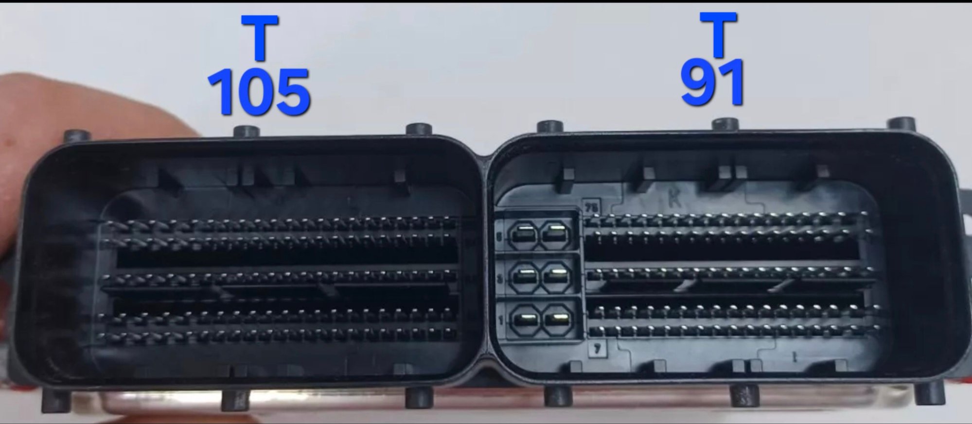

It is not pin 91, the "T91" stands for the connector on the engine ecu, not terminal 91, the ecu has two plugs, one with 91 pin sockets, the other 105, pin 19 that you mentioned is located in the 91 pin connector, hence the diagram depicting T91/19, just as others will be depicted as say, T105/45.
I will look to find information on that T8CF.

You’re right Johnny. My bad. Yes the 19th pin on the T91 connector, that is what I meant.

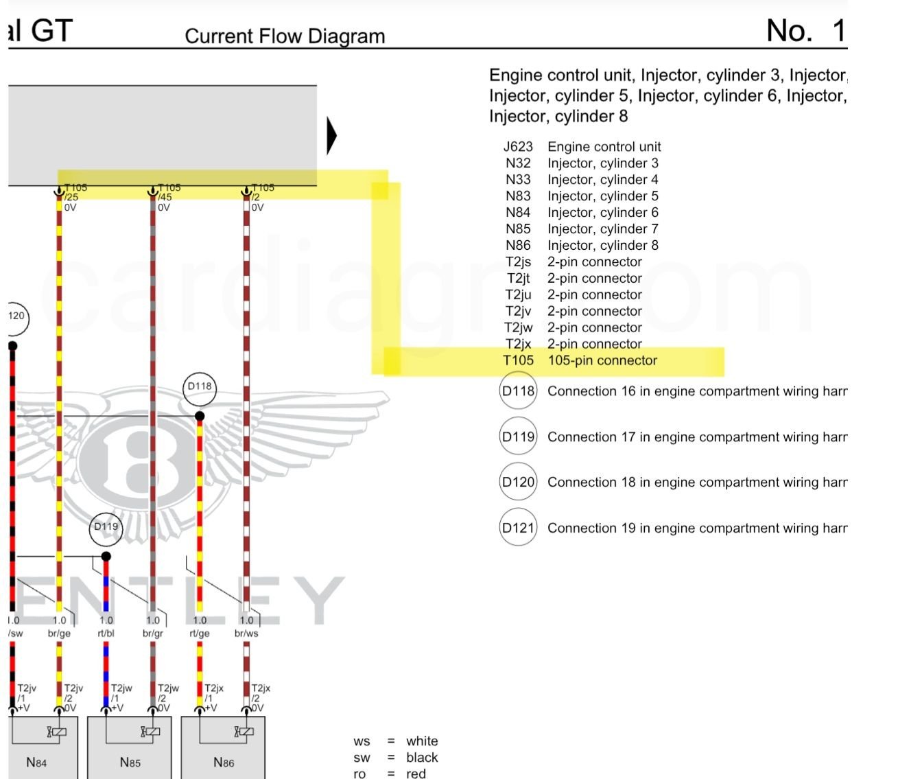

Hi Johnny by any chance do you know where this white and red wire goes to? Or comes from? I can barely read it on the diagram.
Thanks!
