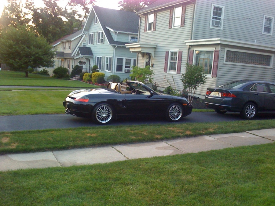

I said I would post some pics a while ago, so here they are. First the rims and then the Sparco Torinos.
A note about the Torinos: they don't fit. I saw them in somebody else's car, so I went ahead and bought them, but they had to be modified to fit the 986. The Torinos have adjustment ***** on both sides as well as plastic covers that will not quite fit when the seat is centered. To make the seats fit, the right-side **** and cover on the driver's seat and the left-side **** and cover on the passenger side must be removed to keep from rubbing on the center console. After the **** is removed, the adjustment shaft sticks out too far and has to be cut (I drilled it and put a cotter pin in to hold it in place, since this is what the **** does). This looks ok because you can't actually see the mechanism once the seat is in the car.
On the outside edge of each seat, I was able to leave the *****/covers in place. However, the seats cannot slide all the way back if the ***** are left on. I am right at 5'-11.5, and this is ok for me. If you don't want adjustment, the ***** could be removed and the seat could slide maybe 1.5-2" further back. But if you don't want adjustment, why buy Torinos?
The Torinos + Sparco seat sliders end up being just about the same seating height as the stock seats, but they have far more torso support. They are nice seats, but if I were to do it over again, I'd go ahead and buy the Evos because 1) I don't use the recline or slide functions at all, 2) the Evos probably hug the torso a bit better while having more shoulder room, and 3) the Evos are really light.
This last picture was supposed to show the removed cover on the console side of the driver's seat. It's hard to tell, but with the **** and cover removed, there is some clearance so that sliding the seat back/forward will not rub the center console.

Will factory center caps fit in the Zehn wheels? Where did you buy the wheels? Thank you.

I got the wheels at Discount Tire. Big O can also get them. Not sure about the center caps because I couldn't figure out how to remove my old caps.

The victor equipment wheels do accept porsche center caps... if you look closely at your porsche center caps (or the victors, for that matter), you'll see a small pair of holes on the opposite sides of each other... coat hanger in both of those and just pull... out they come..
I have some Victor Equipment LeMans rims on my Cayman and have the Porsche center caps in them... looks good..
I like the look of the seats in your car.

Looks good, I'm considering some victor's for my 996..

Your car is looking good! The only thing I would do differently would be black center caps.

Thanks, I hadn't even considered that yet. I just replaced the top and have been planning other things like M030 suspension, V8 swap, and new exhaust, but I guess I should go ahead and take care of the little details that make it look better externally such as:
clear sides
clear tails
Porsche center caps
ash-tray delete
Also need to get that missing plastic guard that goes under the right side of the front bumper cover.
