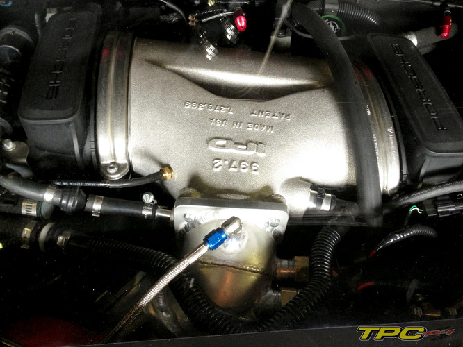

This car features the TPC Racing Intercooled PDK Turbo Kit and the TPC Racing tune that each car gets with a turbo kit. When installing the methanol kit and the NOS, there were many upgrades that had to be done. The first was the plenum for the additional injectors that are controlling the methanol. Also with the plenum modifications, we extended it to the throttle body. We did this so that we could tap into the plenum closer to the throttle body for the nitrous.

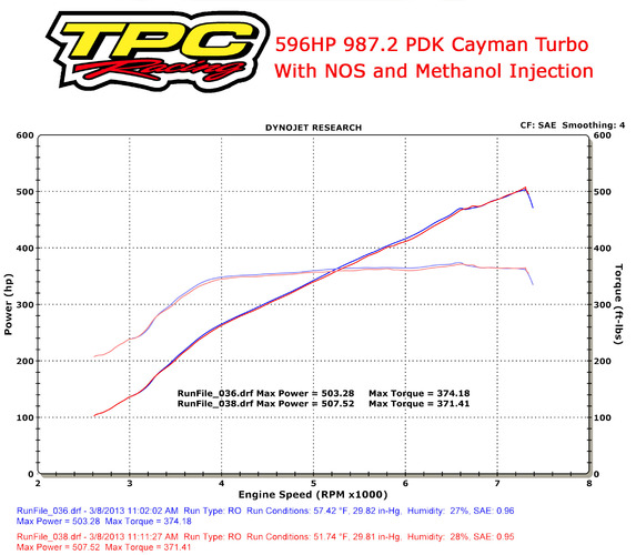

After installing everything, we strapped the car down to the dyno. Right away, we could tell that the car loved the methanol as we made a pull at 470WHP. After getting the methanol setting complete, we then turned on the NOS. The NOS kit we are using is a 40HP shot which works great on this car. Once we made a pull with the nitrous, the car put down 503WHP on PUMP FUEL! After making that pull, we made a quick adjustment and made another pull. This time, we made 507WHP!

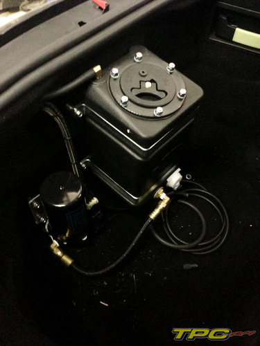

Methanol Tank

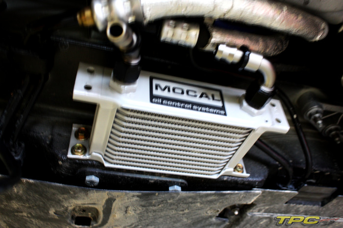

Additional Transmission Oil Cooler:
Plenum Modifications:

awesome job on this set up guys... is the owner on the forum?
also what meth system is that??

The meth system is one that we designed at TPC with the different fittings, lines, reducers and tank as those are the most important things to keep from evaporation etc

Yikes, nice and flat torque curve. Great job.
