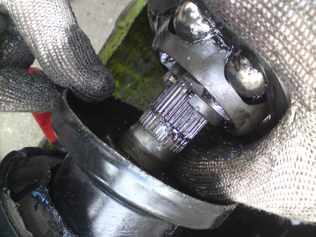

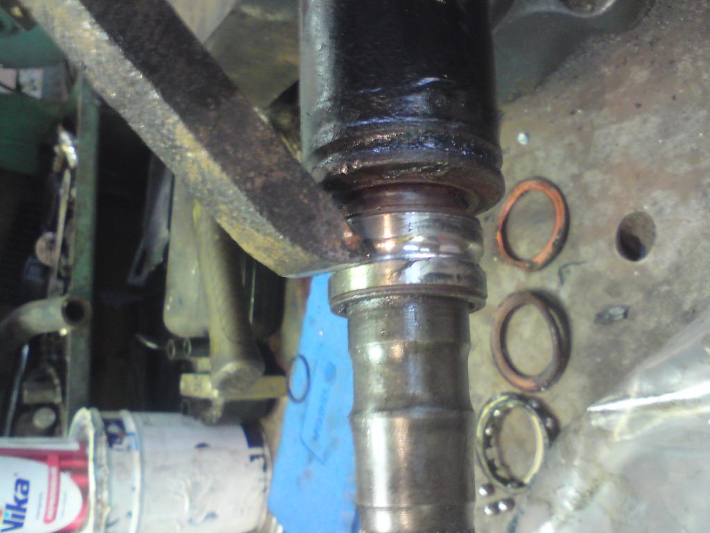

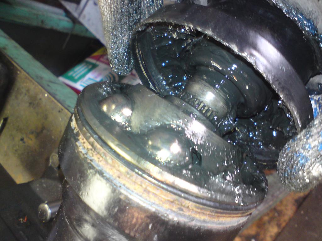

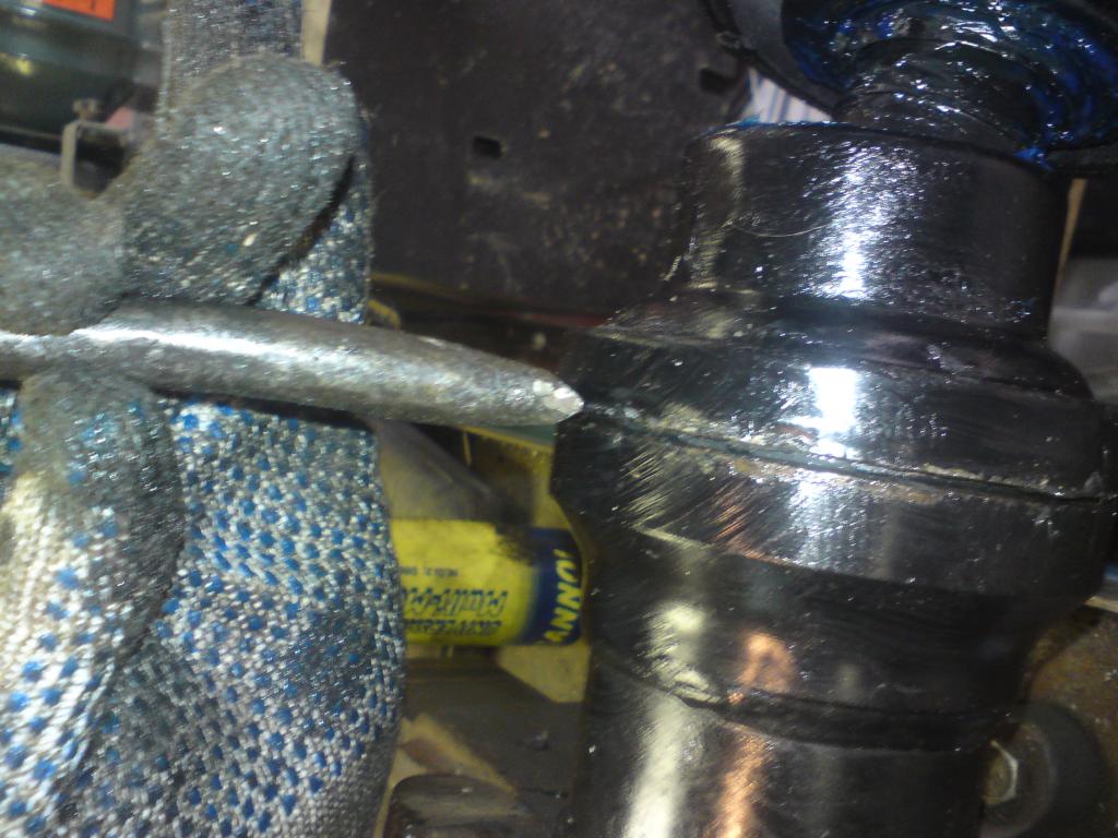

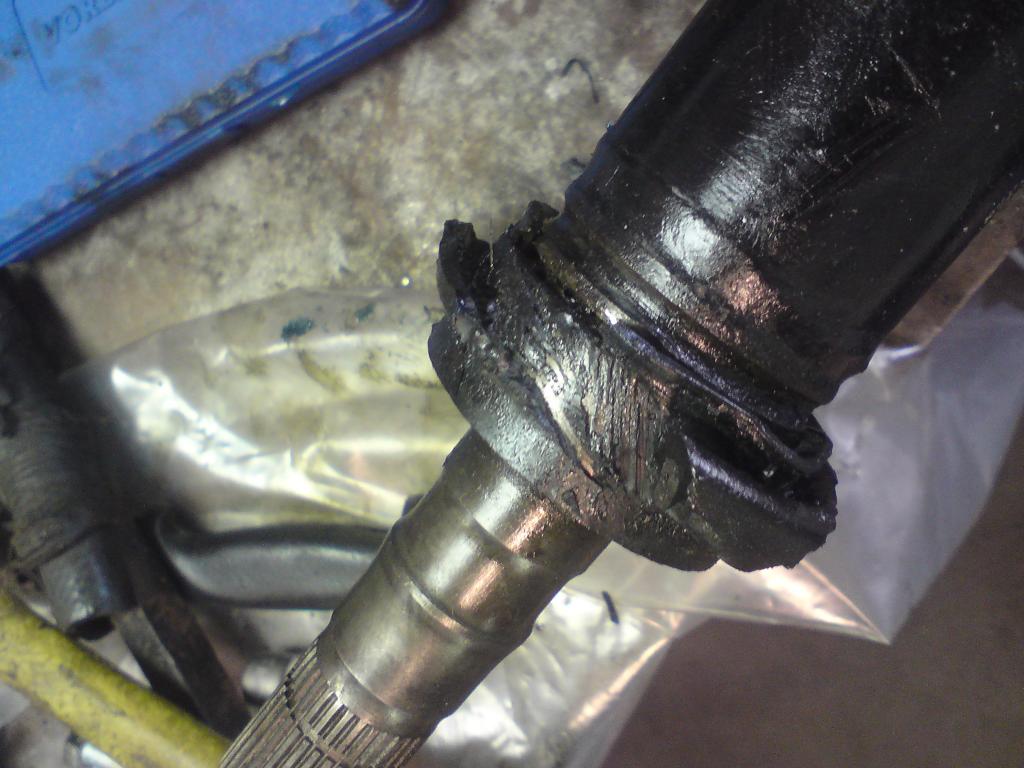

mmm.. what make of this? if chinese wont last long...
next thing is to change this only part you need to disassemble propeller shaft, and forge-roll it back properly that is very hard to do. more, will be vibration after this procedure, so bolts at bearing need to be tighted up in place only with spinin up prop shaft...

The quality of this bearing is very good. Installation is much more involved than a simple shaft replacement, so we recommend taking the new bearing along with your shaft to a driveshaft shop for installation and balancing. The cost to install and balance is usually still far less expensive than buying a new driveshaft.
