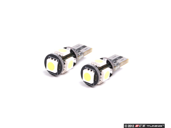

This latest Ziza release for the Cayenne emits a super-bright white light from the door mirrors as the doors open, illuminating the road surface below to keep you out of puddles or mud. The sense of occasion offered by this lighting is worth the upgrade alone. Easily installed at the bottom of your exterior mirrors, the stunning Ziza LEDs simply replace the OEM filament bulbs.

I bought these from ECS and there are no instructions on how to install them. I called ECS and they could not help me. It looks like the mirror has to be taken apart which doesn't look easy. Paying a dealer to do this is not worth it. If anyone knows how to install these please let me know. Thanks

I just installed these last week on my cayenne. It's pretty straight forward but scary. you need to pry the mirror off. I did it by hand it needs some pressure, the mirror won't break, it will pop right off. The mirror is held on by some wires. I did not disconnect them as it's not necessary. There is the light socket pull the socket off you may need to twist it, the rubber socket will come off holding the bulb in place. Swap the bulbs make sure it works as the polarity may be wrong. If it doesn't turn on just swap the bulb 180 degrees. And re-install that was tricky as it needs to be perfectly aligned or it won't seat properly. Then push the mirror glass back on. The drivers side was easier than the passenger side as there as a few more wires on the passenger mirror glass. Hope this helps! Great upgrade glad I did it, made my CTTS look more modern.

Thanks a lot for the help. One question though. The mirror seemed to have a black rim holding it on when I looked at it. Do you pull the mirror with the black piece or somehow unlip that black piece and pull it away. Thanks again for the help!

Pull the mirror with the black lip as one piece. Also I found if you pull from the outer edge and push the side closer to the car it's easier to remove.

That worked! All done. No problem. Took 10 minutes. Thanks again for the help! Gotta love these forums!
