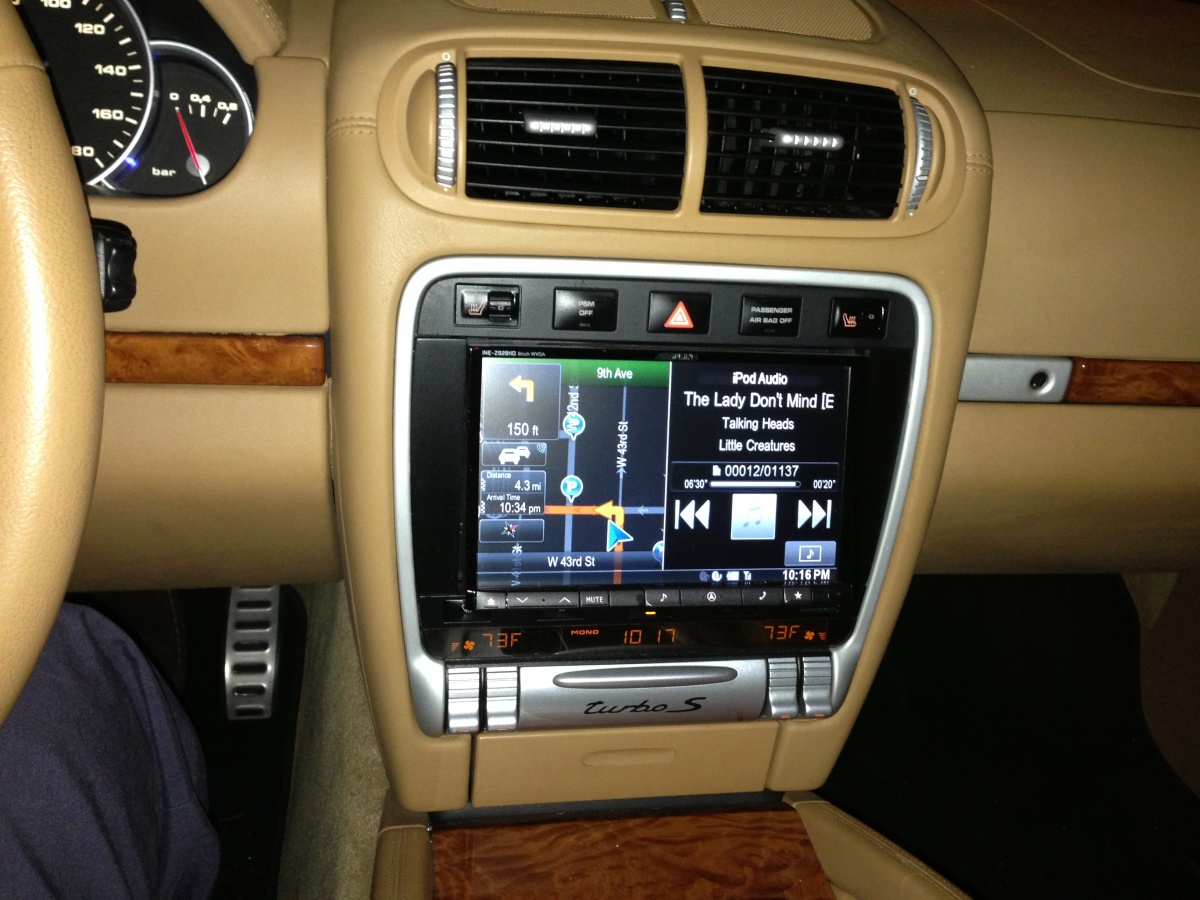

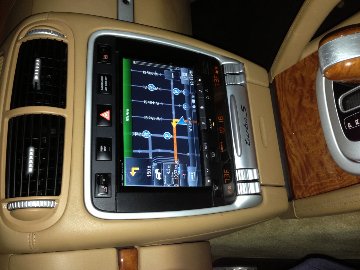

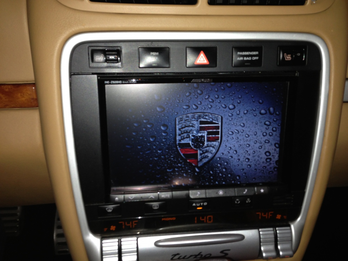

I believe Garmin uses Navteq maps but it would probably benefit Alpine to use Garmin's UI for GPS. Anyway, here are some photos, hope they help

Wow...now that is a majorly big screen!!!

did you use the NAV TV MOST HUR module to plug into the fiber cabling for the car amp?

Yes on the Nav-TV MOST-Hur
I actually overstated steering wheel controls ... I haven't been able to get the phone answer, hang up and mute buttons to work. I just set the phone to auto answer in the car which works 75% of the time (translation 25% of the time I don't want to speak to the person who's calling but the damn thing auto answers)
I do need to bring back to the installer and have them spend some time on the phone controls.

tks for the pictures! it's almost like fitting a Ipad mini in there...lol.. hmm..maybe that would be a good option as well.. LOL
