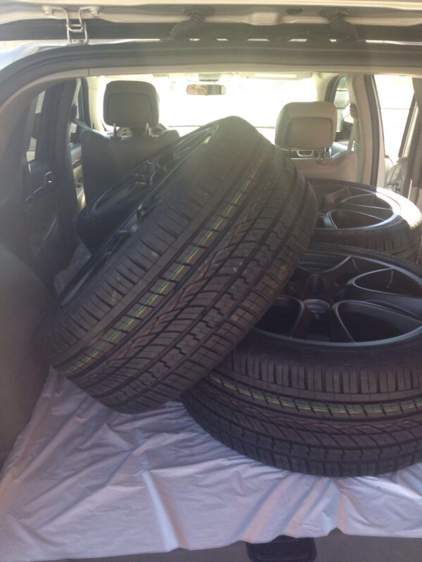

Last Friday. New tires and powder coated wheels with autumn black.
