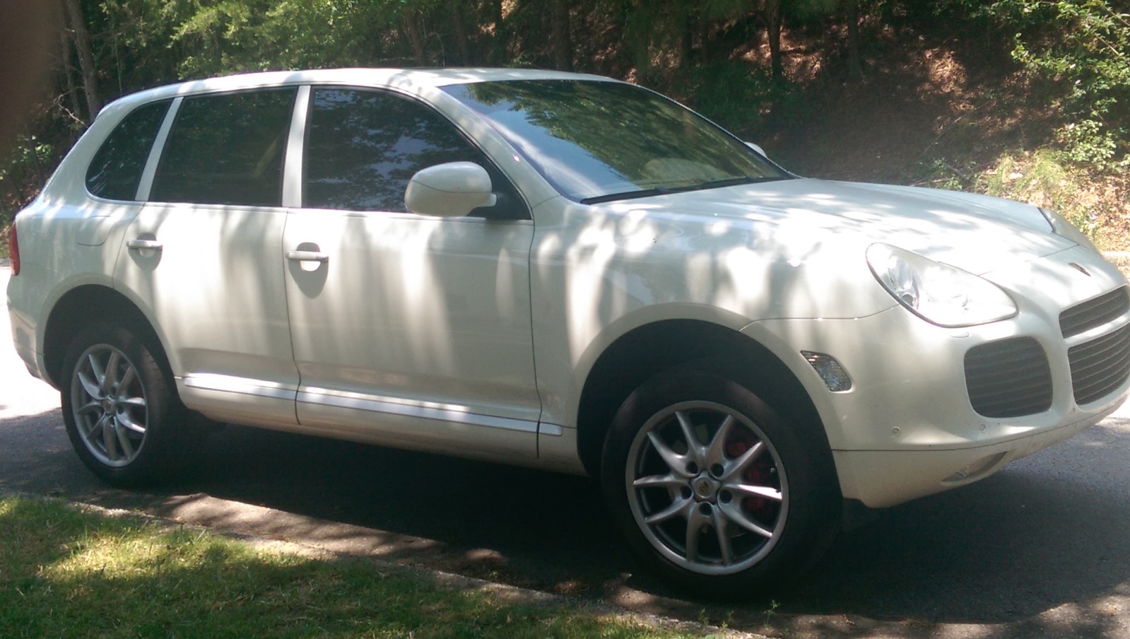

Finally, a picture of the filthy fat pig:
SO DAMN HIGH!!! And this is in low mode. Ridiculous.

I have to say thats the first CTT that I have seen with 19" wheels. If you are planning on getting 21" wheels the sting is worse than 19"s. I would go with a 20" great selection and prices dont sting as bad when it comes to replacement.
