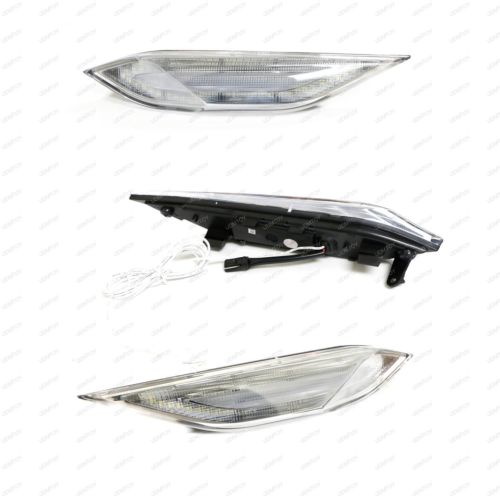

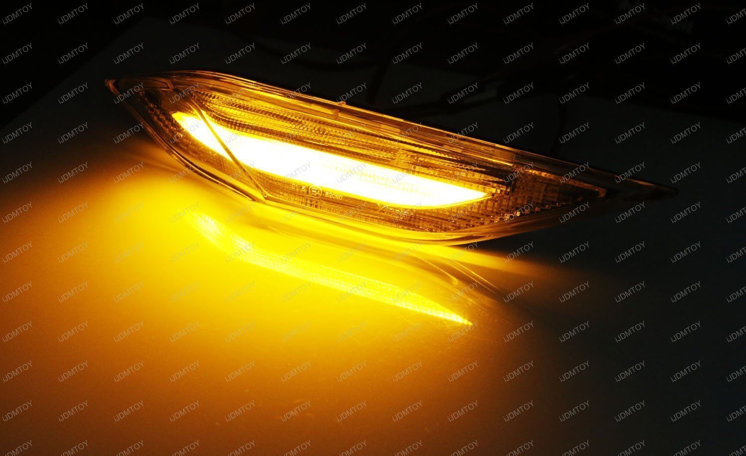

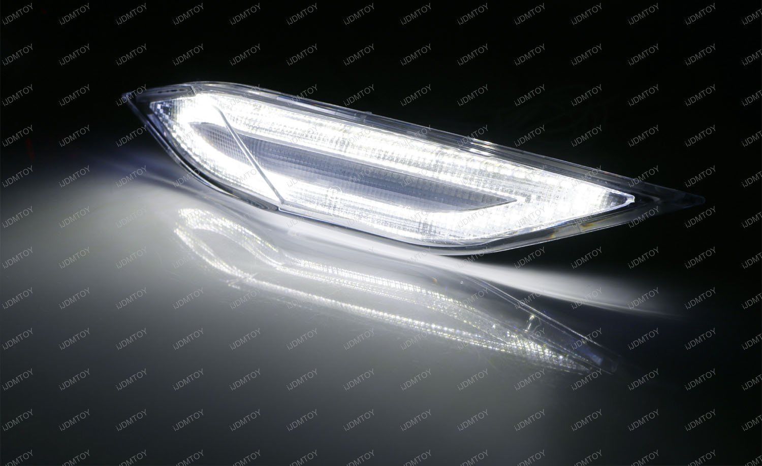

Saw these the other day on a black 958 and the bright DRL like light ring caught my eyes. Apparently the white light needs to be wired to switched 12v to act like DRL, while the amber uses existing harness for turn signal.
Anybody know of any good nearby spot to tap into switched 12V? Or even tapped into the factory DRL LED's directly?
I bought these too but havent connected them to the DRL yet.. seemed complicated unless you know what you are looking for.
I will see if anyone replies with some ideas.
