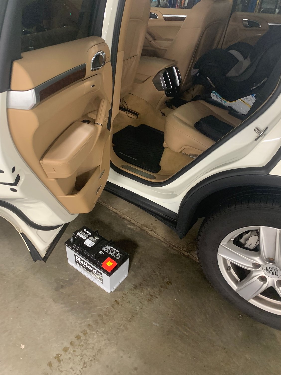

I purchased this battery DieHard Platinum AGM Battery, Group Size H8, 900 CCA to replace the factory one. 20 percent off coupons can be found everywhere for this particular battery so after tax and core refund I snagged it for $171.19
Replacement battery for my 2011 Cayenne S.

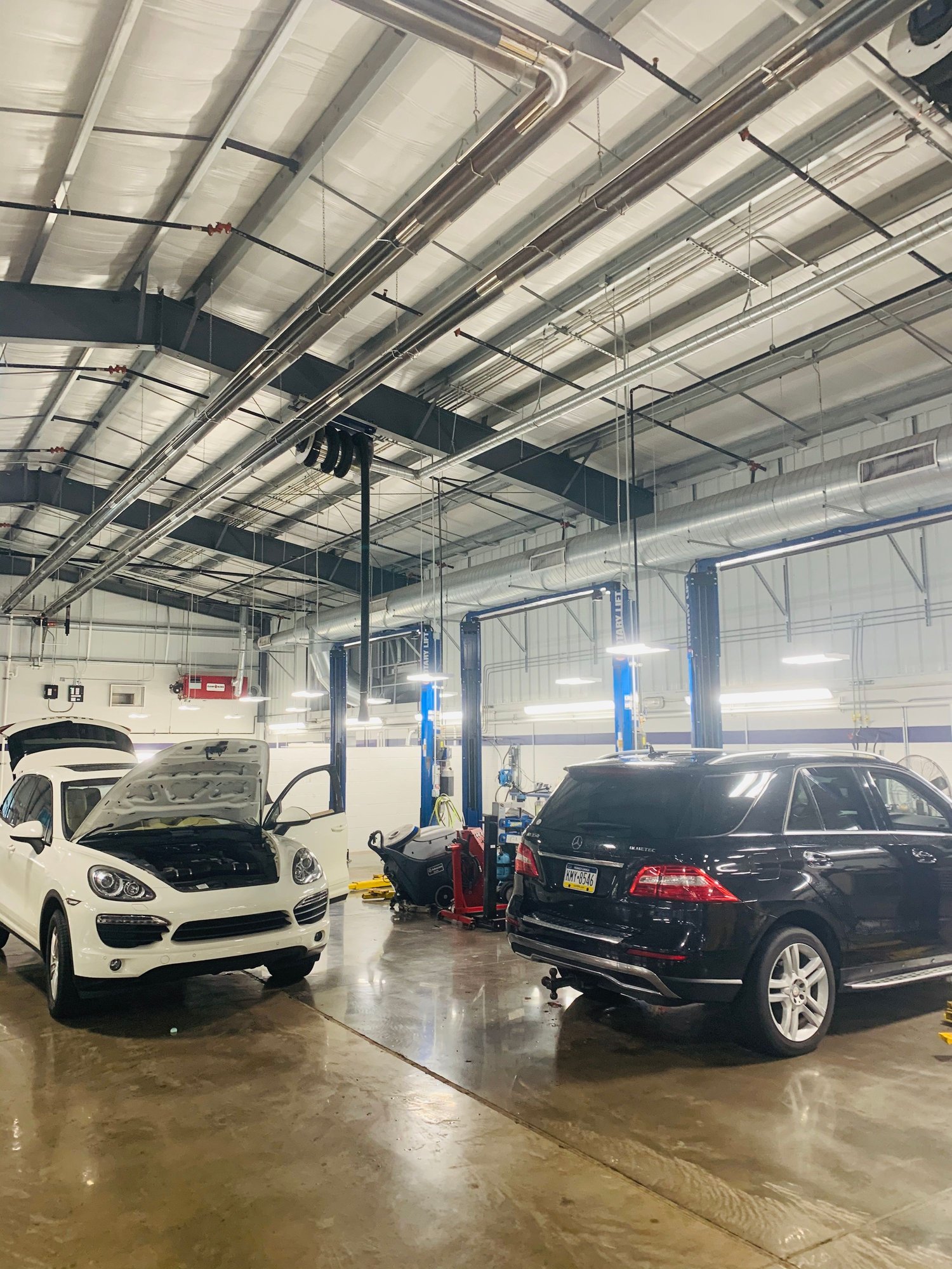

My good friend invited me to his gorgeous new garage and gave me the guidance and tools to DIY my very own battery swap. Of course I tried to tip him for his help but he refused. I wanted to share a few pics of thr swap.
Prepping in the new garage while my friend preps disassembly of his transfer case.
Getting the battery ready for transfer.

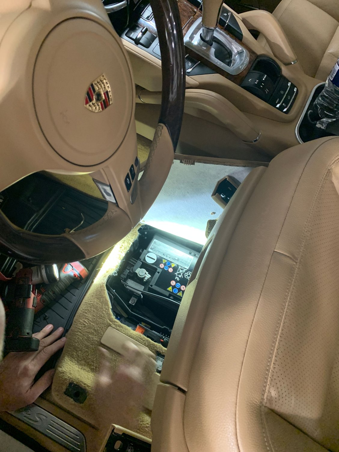

My friend started the project for me by getting the seat back, carpet pulled back and battery cover off.
Just before I removed the factory battery.

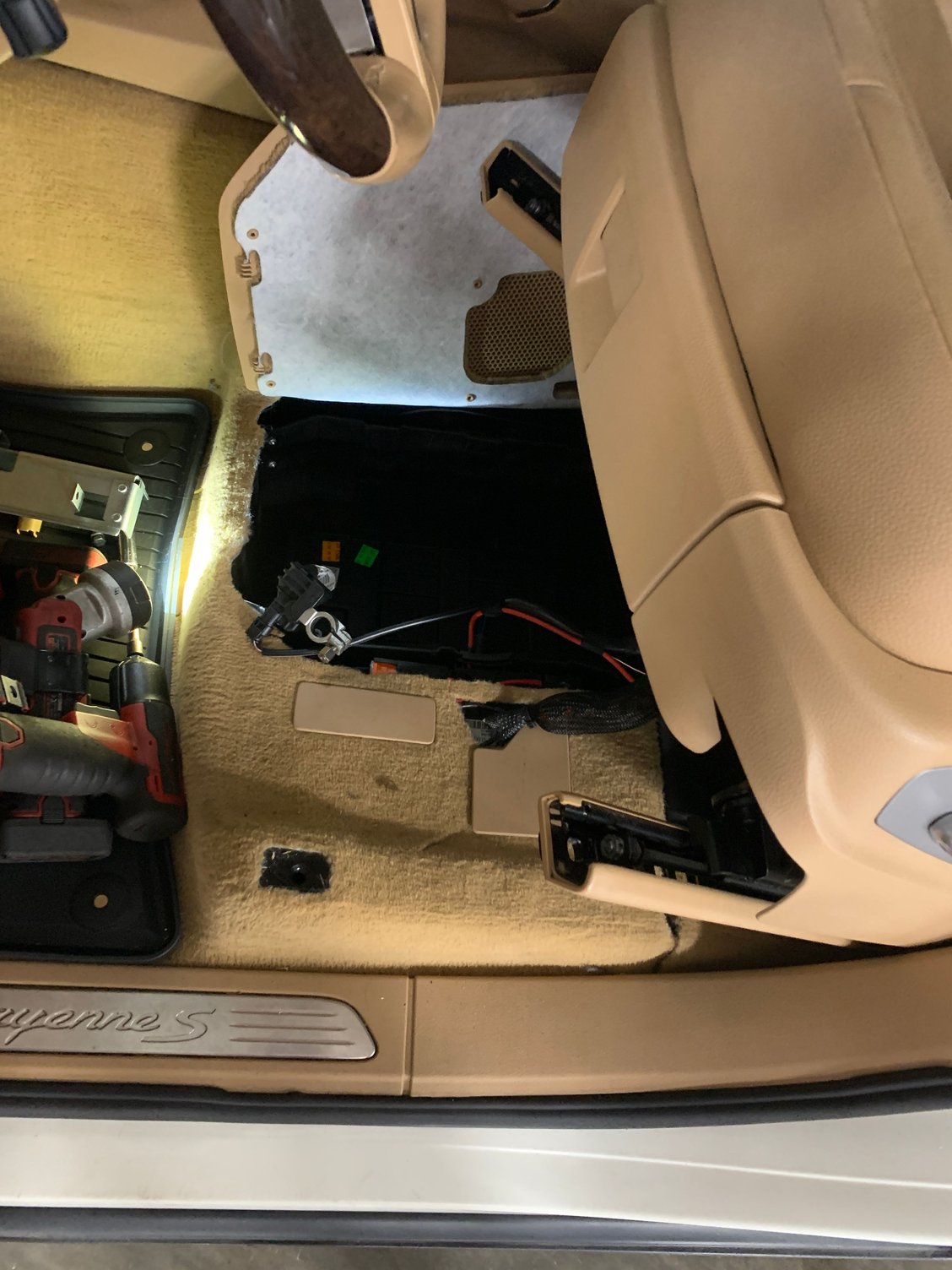

The old battery is out!!
Picked this up for 75 bucks delivered on Ebay and it arrived the same day. I topped off the battery, cleared a bunch of memory codes and I am good to go!
