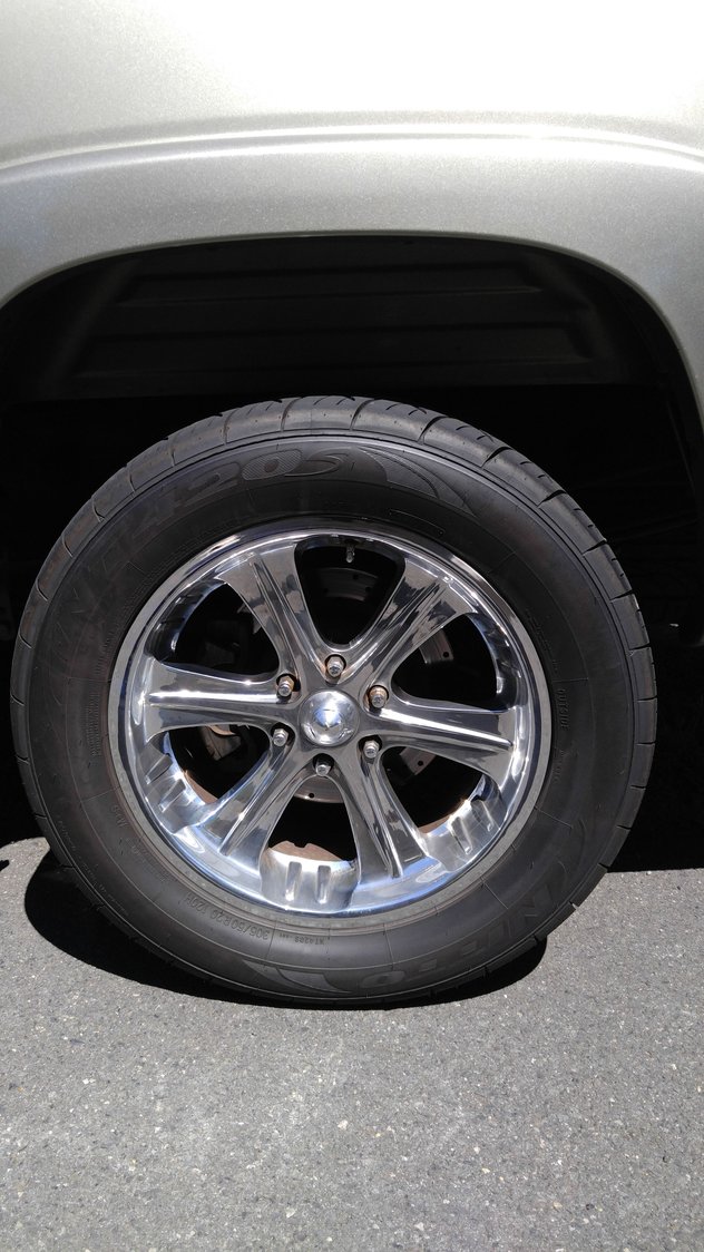

Originally Posted by Gimmeboost
1. What are the wheels made of? Are they alloy/mag or heavy cheap chrome plated. a lot of the shiny chrome rims out there are so heavy even if balanced they vibrate because the suspension can't dampen out the bumps in the road. The higher the frequency of the shock absorber (faster you travel) the more pronounced it becomes.
Here's a picture of them. They are heavy, but I'd honestly say no more heavy than the stock rims. They do have a chrome outer lip and pinstripe and it does seem to be a bit "cheap" as it did scratch easily a few times.
Front/rear - note the deep dish in the rear
Fronts
2. Do the spacers centre the rim? They should have a lip either side to ensure the rim is located correctly. If the spacers don't have this and are simply spacing the rim you will never be able to centre the rim correctly.
The spacers have a sort of "lip" that does seem to centre the rim but there could be some play in this case.

Have you checked the age of your tires? The close up of your rear tire indicates 4013 , which means manufactured in week 40 of 2013 , which puts it at almost 4 years old, which should still be OK. Check the date on the fronts to see the manufacture date.
I have just replaced the two front tires on my Cayman which were fitted in 2015 which turned out to be from a batch manufactured in 2009!
I had vibration at about 100km/h , tried balancing and also suspected a bent rim.
The tires still looked healthy and had plenty of tread, but due to age I guess used to deform at speed and create vibration.
Replaced tires and vibration went away.
Tire life is indicated at 5-10 years depending on the manufacturer.
I'll have to check the rears. The fronts were replaced (the close-up is of the fronts) and they are now Jan '16. If it was a tire issue I was always apt to blame the Nitto's instead of the Vredstein but good point.
