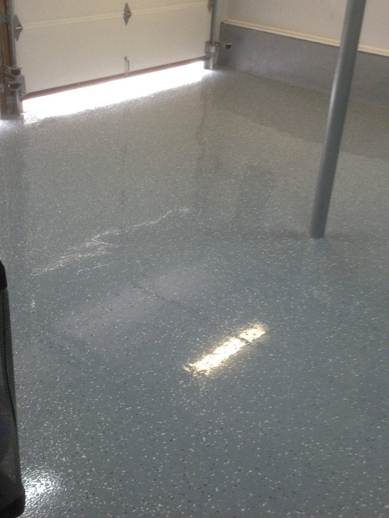

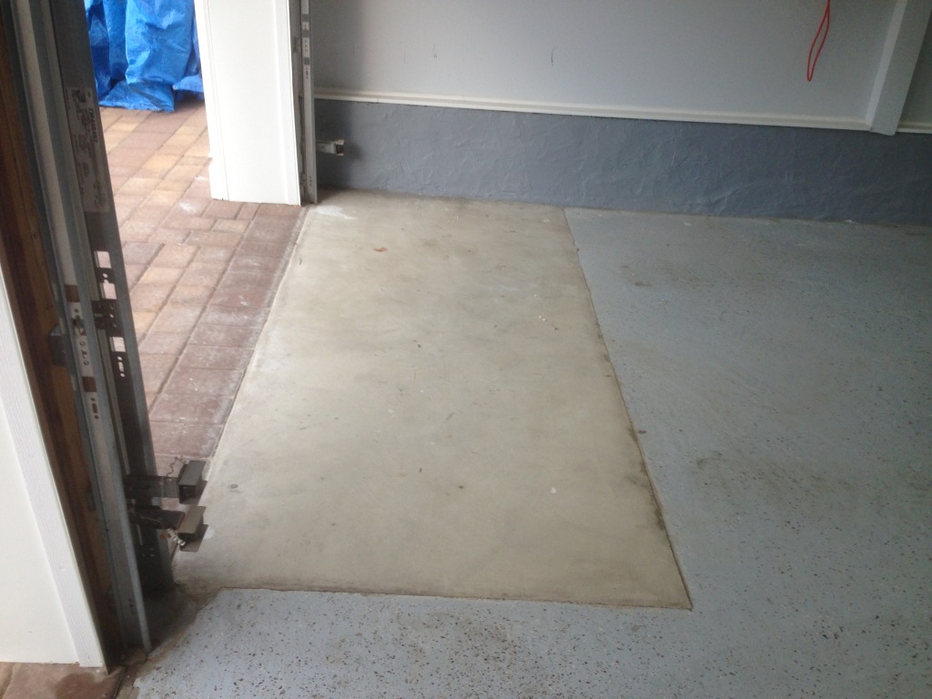

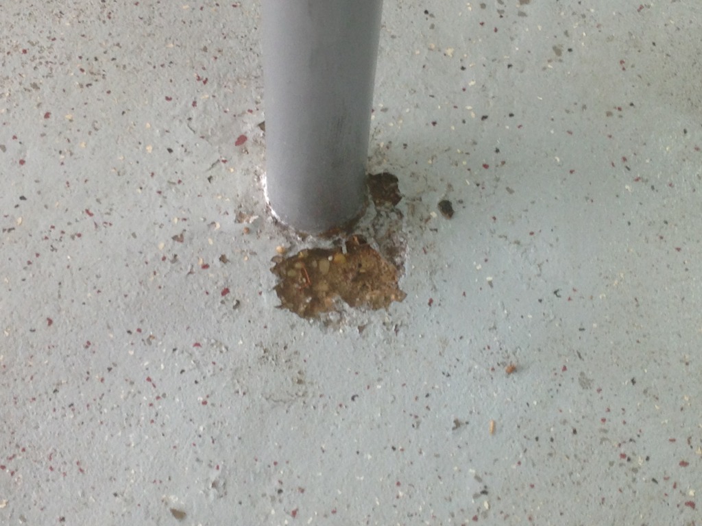

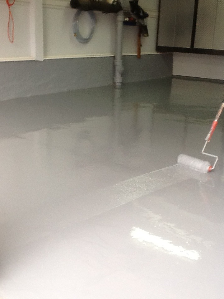

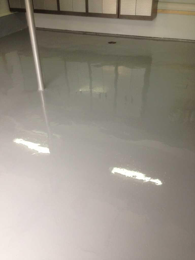

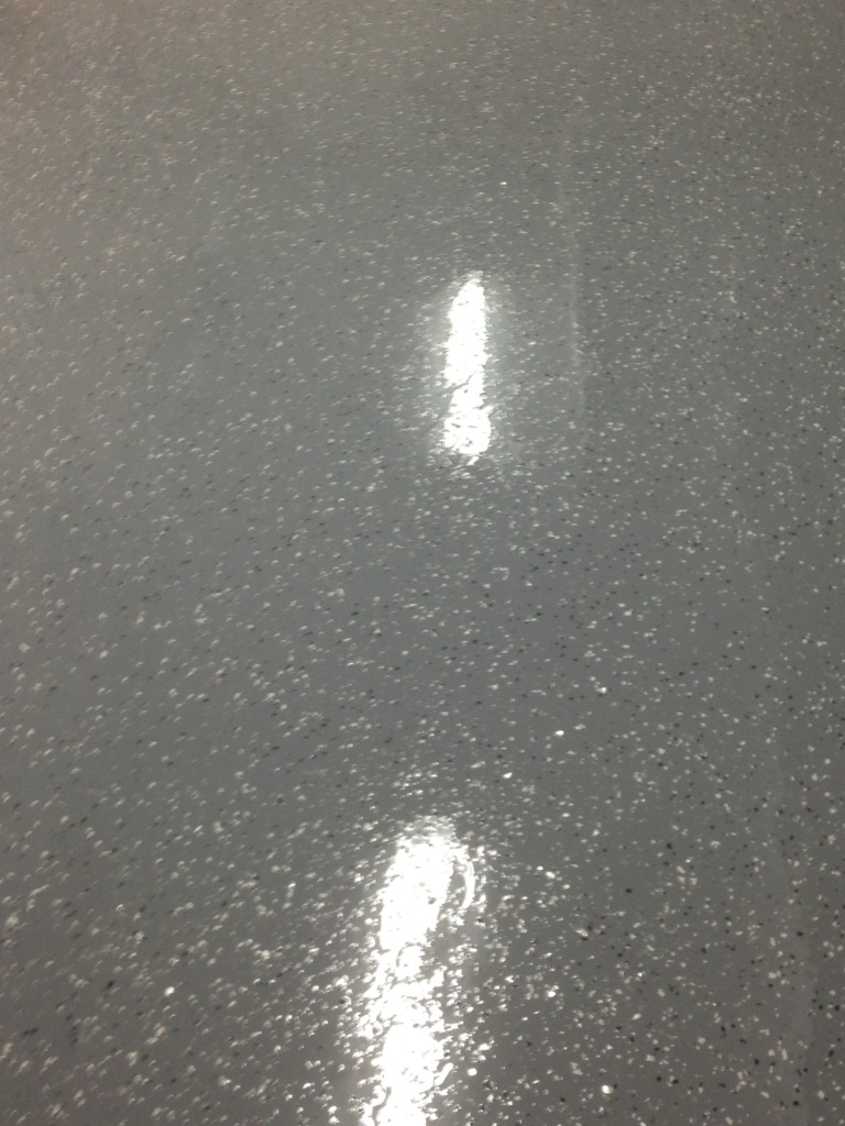

Emptied the garage last night and got the fridge on a dolly and covered it with a tarp to spend a few days outside. Going to let the pictures do the talking on this On this one...
Quick summary. Needed to remove my old epoxy I did in 2008. It had been damaged due to a flood and ensuing construction. Floor was ground, defects filled, repairs ground, vacuum slab, apply 100% medium gray epoxy, add chips and non slip additive last. Tomorrow they will return to top it with Polly to uv stabilize it and add some gloss.

Damage around center pole
Damage filled
Old patch not quite level.
Patch after grinding

Squeegee application of epoxy.
Color coat complete
Back rolling
Adding flakes

Finished
They will return tomorrow to add the clear.
