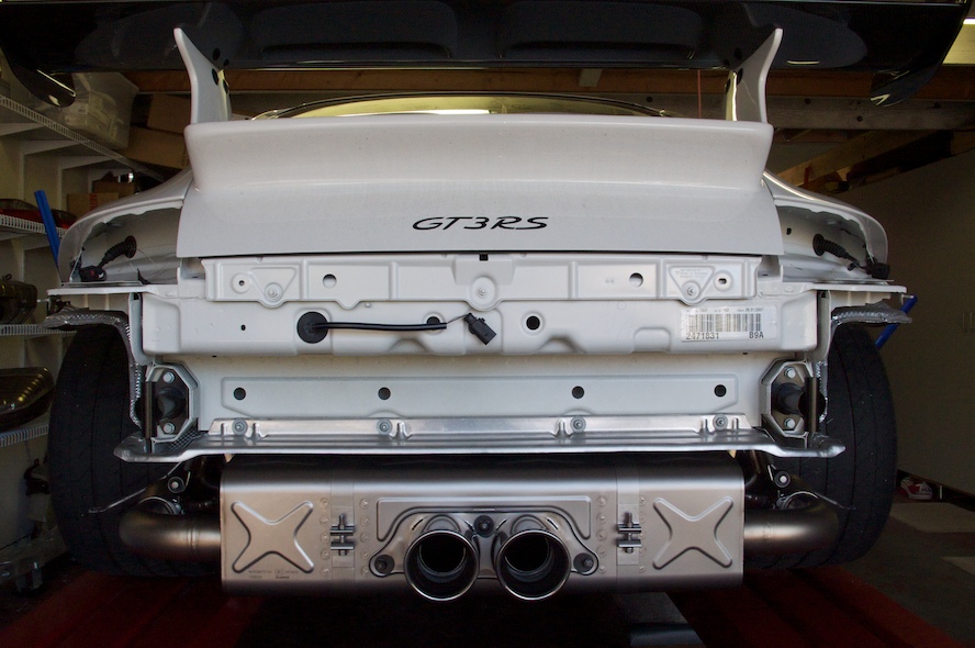

Back to the installation, it was a perfect fit in every detail, the instruction DVD and manual were first class, every set of crews, nuts and seals was packaged in separate zip lock bags and included special anti freeze paste - very impressive. After I installed the system in my own garage on a kwik lift, I wiped down the whole system with a drenched in WD40 rag as instructed (to eliminate finger prints which would be permanent if burned in) and after the first heat cycle the system turned into to most incredible purple bluish color.
#Driving impressions: Excellent but at first after having driven the car with the too quiet for me stock exhaust, I felt it was way too loud!
A week of driving went by and I got used to it and actually started to really dig it. On several drives with other Porsche enthusiasts, I was told they all wanted to drive right behind me because the sound and my blipping of the throttle was just the best they ever heard. One 60 year old wife of another Porsche owner who usually shuns these drives, said to the dislike of her husband, that this was by far the best drive she has ever been on because of listening to the sound of my car - really!
Power delivery is steadily increasing all the way to redline just the way I like it BUT unfortunately there is a little drone between 1800 and 2800 rpm. Here is another excerpt from Stef - Europipe:
“We've build several prototype central mufflers for the 997 GT3 just like your Akrapovic setup and had plenty of drone too. *Also the sound inside the cabin was loud up to 3000 rpm , quieter between 3000 rpm and 5000 rpm and again somewhat louder up to redline. *Not good. *The total lenght of the main exhaust pipes is too short , hence the drone”.
In other words the distance from the cat outlets to the rear central muffler is too short to get rid of this drone but on a race system if used for racing, who cares? I use it for street hence I would rather have no drone but I can live with it.
In my case it is only somewhat irritating between 1800 - 2800 rpm. In quiet neighbor hoods, I just keep the rpm below 1800 or quickly get the rpm up above 3000 with no load.
The throttle response is awesome and the 100 cell cats are trouble free, I was first worried that they may not be able to control the CO within the range the ECU dictates but after going to my very supportive dealer, they confirmed with their magic box that the O2 sensors have absolutely no problem controlling the values as needed. I never had a check engine light come on or a rough idling engine.

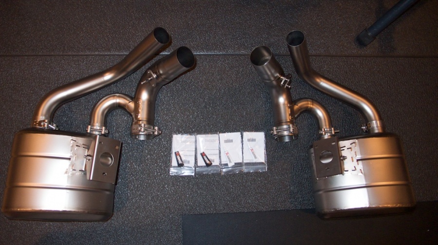

Right after I got the system installed, I purchased the side mufflers for this system, just in case I either move to Europe with the car or get tired of the race sound. So far they are still laying around gathering dust because I love the sound the way it is right now.
I plan on seeing MAX RPM who is an Evolution motor sports dealer and have my ECU finely tuned to the Akrapovic system on their dyno, date is not yet set. I heard super good reports about Todd Zuccone and feel confident that he will together with MAX RPM dial the system in to perfection.
If I install the side mufflers as seen on the picture below, I will write an update on this site. Till then if you have any questions please let me know either via a response here or via a pm.

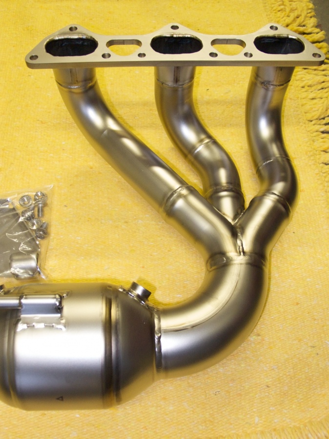

Looking at the collectors the design is ?
They have the bung on the cats?
#The whole system as installed weighs 31 lbs, I believe the first picture shows my system on a yellow blanket, this is the way I weighed it, turned it vertical and balanced it on a scale with one finger so as not to influence the reading.
#I was told the complete stock exhaust weighs about 90lbs, mine weighs as stated 31lbs, makes a difference of about 60lbs, I did not weigh the individual parts of the Akrapovic or the stock system.

I too am not an expert but I am physician(radiologist) with much physics education and the weight claim loss stated is bunk. Whoever said that has no knowledge of unsprung weight and the rotoring mass.
The collector appears unusual. That's what I meant.

Yes, this system is full titanium, that explains the low weight!

Actually these 100 cell cats don't give me any problems what soever, hope it stays that way.
