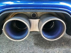

Over to the exhaust.... Pardon me for the guys that already know this but I figured we'd confirm once and for-all exactly what's under there. The same factory headers/cats and side mufflers as on the 2010 GT3. No titanium there. The only titanium as you can see is the center muffler and the tips as well. So no big/massive weight savings there (more on this in a mo').
Tips are pretty nice looking though:
How light are they?
Compared to the factory 2010 GT3 tips:
Here's our larger diameter stainless steel SharkWerks tips by comparison:
Showing that the 2010 GT3RS tips have a smaller diameter than the SharkWerks tips:
And installed for show...
They usually come in black but we've had a few requests so for a few bucks less you can have them in raw stainless too if you want...
