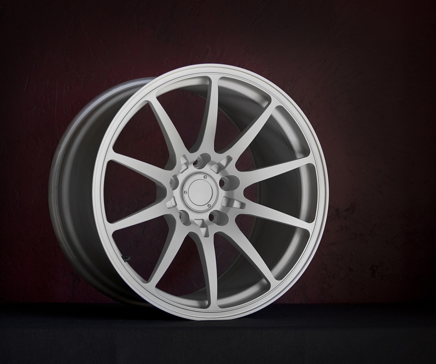

You can use either 18s or 19s on your GT3 for the track. The 18s are a bit lighter but the 18 inch tires are heavier, so that's a wash.
The biggest difference is there is a huge assortment of 18 inch tires available and they are much cheaper than 19s.
May I humbly suggest the forged Tech1-110 for your application? You will save nearly 30 lbs of unsprung weight compared to the OE wheels.

The 18x8.5 front is 7kg and the 18x12 rear is 8.6 kg.
The 19x8.5 front is 7.35 kg and the 19x12 rear is 8.85 kg.
Weights vary slightly with your choice of finish.
I will PM you with the pricing.

In response to all the guys who PM'd me about the GT3 RS, we also make the correct fitment for these cars as well.
Both the GT3 and the RS can accept a 9 inch front wheel if you prefer. We make the correct offsets for these widths, both 18 and 19 inch.
Finally, if you have a late model Centerlock car, we also make the correct fitment for those in both 18 and 19 inch.
In all cases, the factory TPMS sensor is an easy bolt-in and the wheels fit with the PCCB carbon brakes, even with the 18s.
