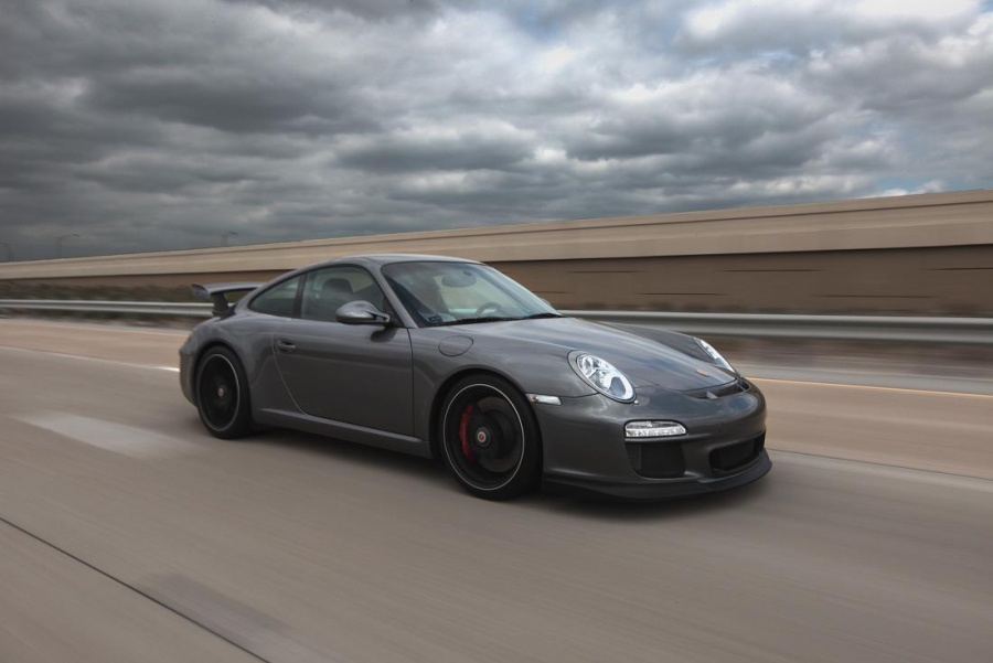

Here's a pic a buddy took. This was his first time shooting a moving car. It turned out pretty well though.
Looks great and please thank the dealer from us too. Without their support it'd be really hard to get our message across
