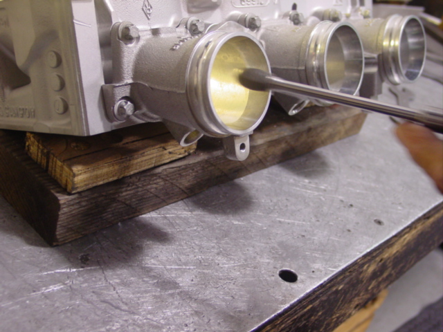

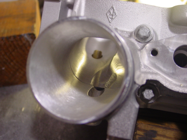

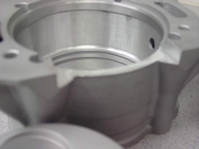

OK....update time! A lot exciting stuff is happening with this project over the past month or two. Sorry I've been so bad about updating but with all the projects we've had going on it's been hard to post as regularly as I'd like.
So...to recap. Life as a 4.2L has been great for this RS. After a few months of track use and normal daily driving, we decided to push a little further and are in the process of updating the engine with OEM GT3RS 4.0 intake manifolds and new cams. The goal with these new upgrades it to reach over 500hp at the wheels...which should be no problem since we're already so close.
Anyhow...here's a few photos of the process underway. Apologies in advance for the not-so-stellar quality.

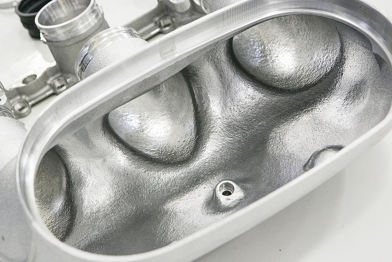

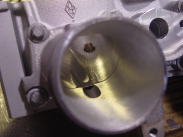

In this picture you can see the 4.0L intakes being matched to the already ported/polished heads. Lots of slow work that takes TONS of patience and attention to detail!

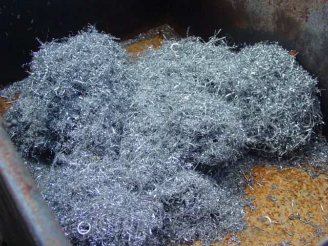

To give you an idea how much bigger the 4.0L intake is...this is the amount of material that was taken away in order to match the port size.
And the finished product...meticulously matched and ready to go!

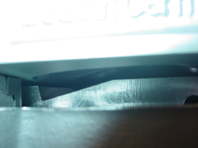

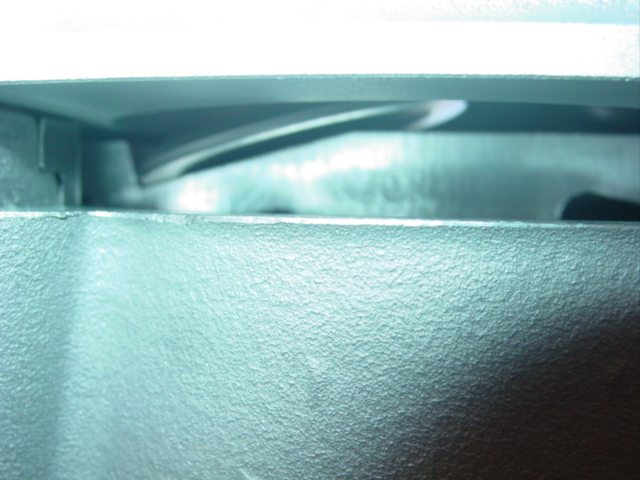

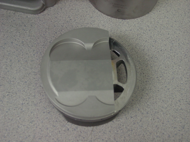

Now, with our new cam profile it was very important to measure clearance between the piston and valves. To do this we basically built a fixture that would allow us to look at a cut-away of the piston/valve clearance with the head installed. Started by cutting away part of a piston and cylinder and creating a "window" that would allow us to look in and measure clearance. Clearance was measured to about .005" so now we know how to fix the tolerances.
And in these pics, you can see through our "window" into the piston/valve clearance which helped us machine the appropriate valve pockets for the right amount of clearance.
