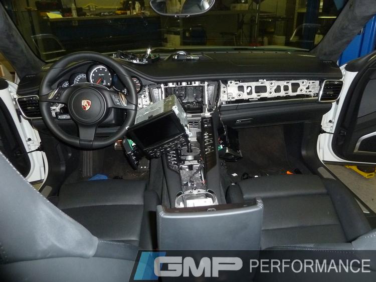

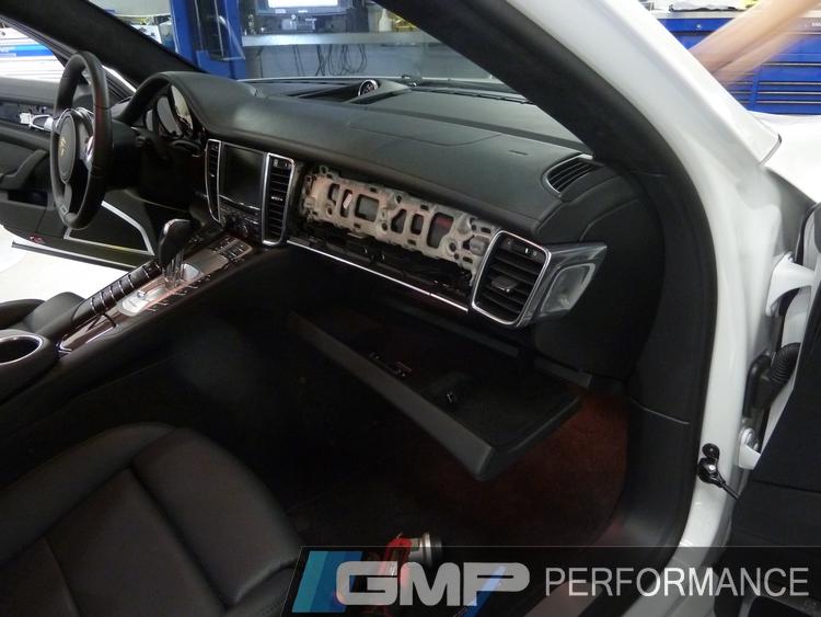

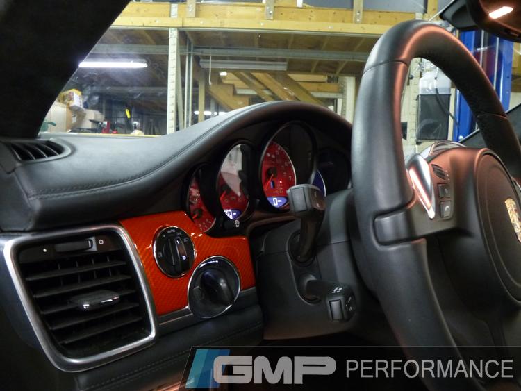

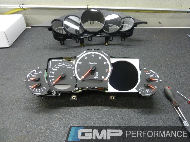

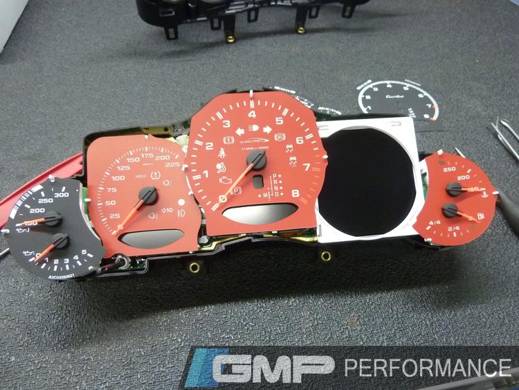

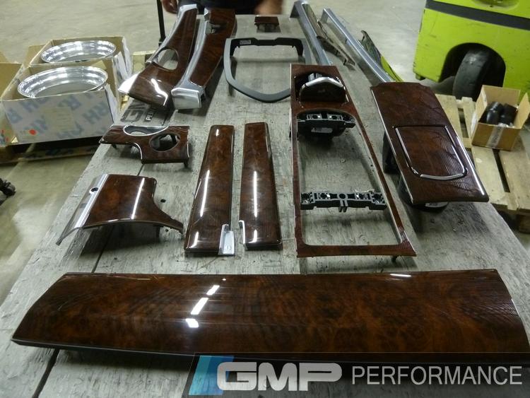

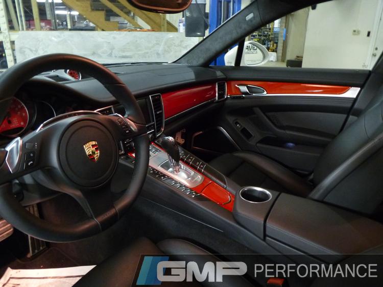

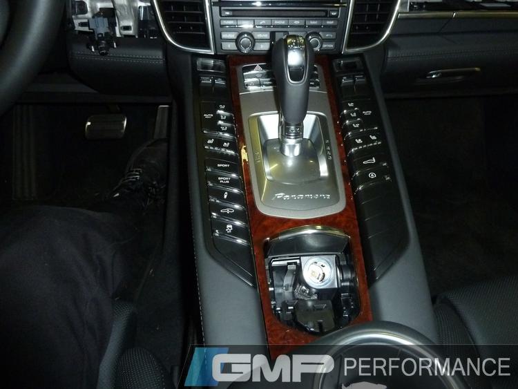

Interior Removal and Installation

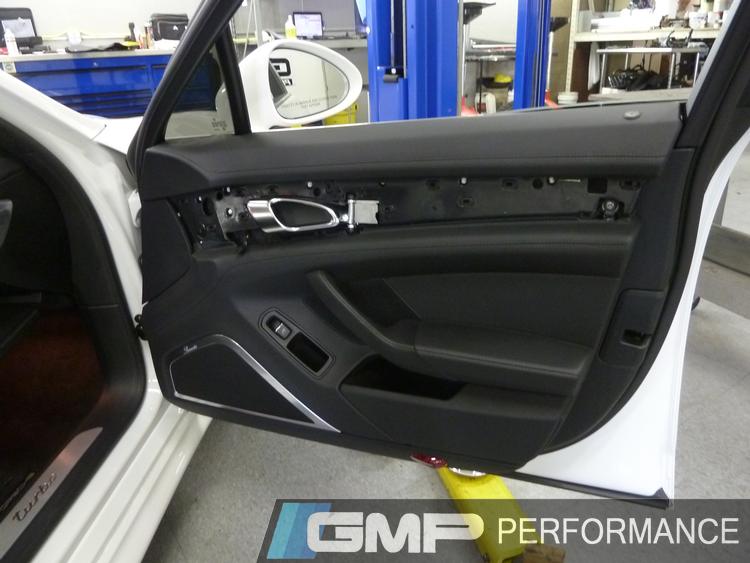

Out with the old...

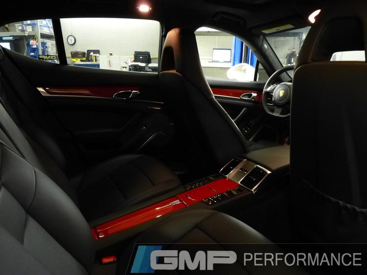

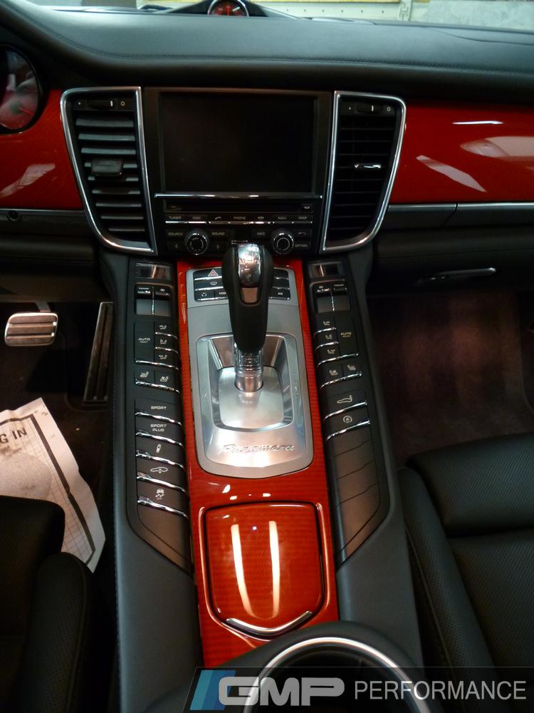

In with the new!

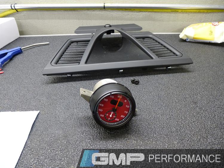

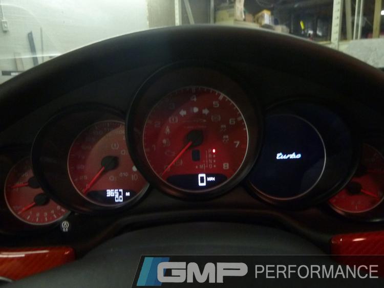

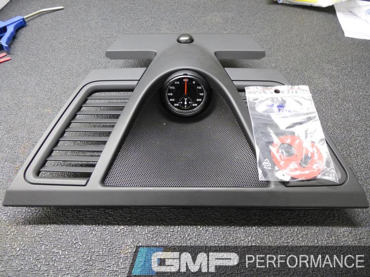

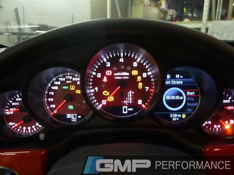

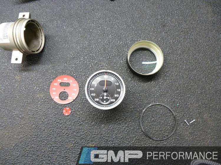

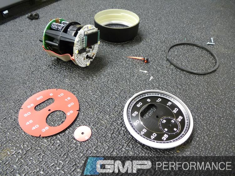

speedART gauges
All lit up

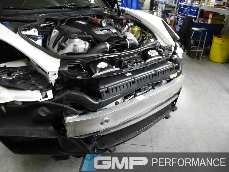

All this for an air filter

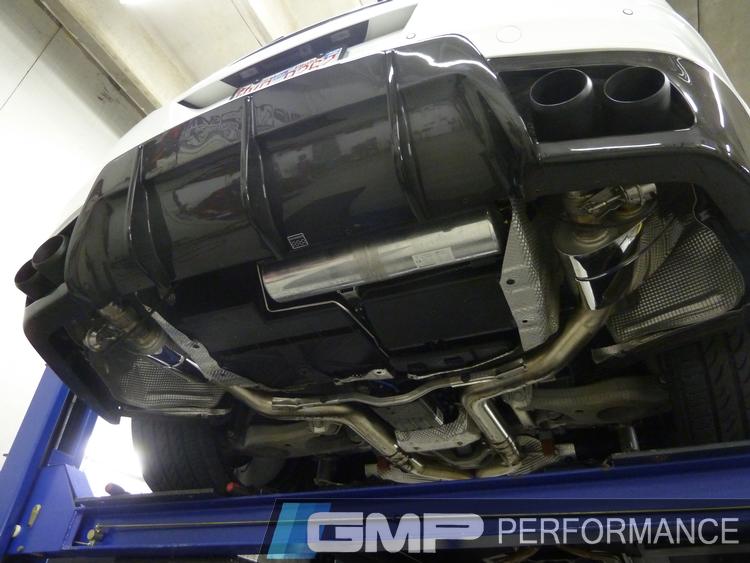

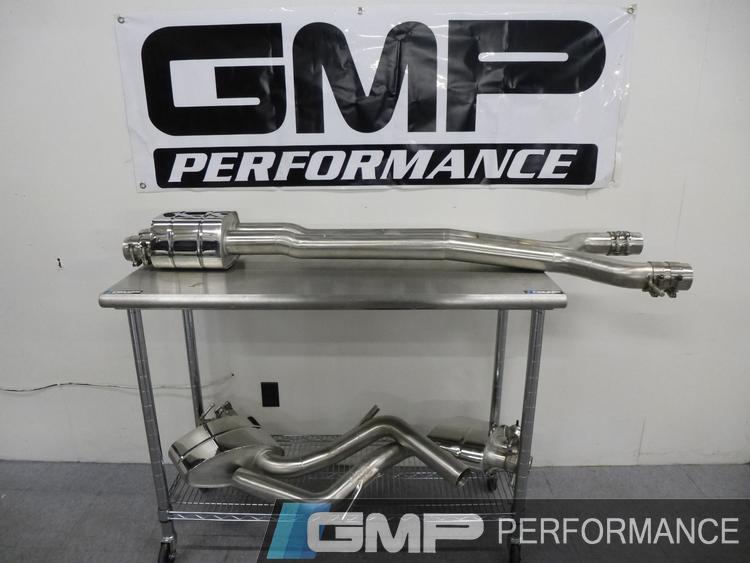

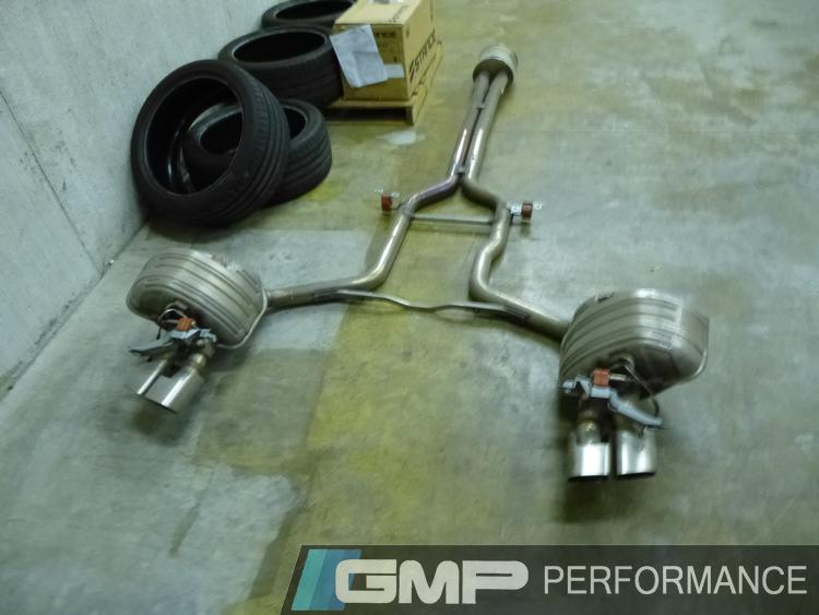

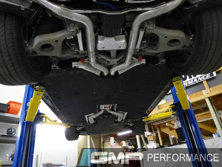

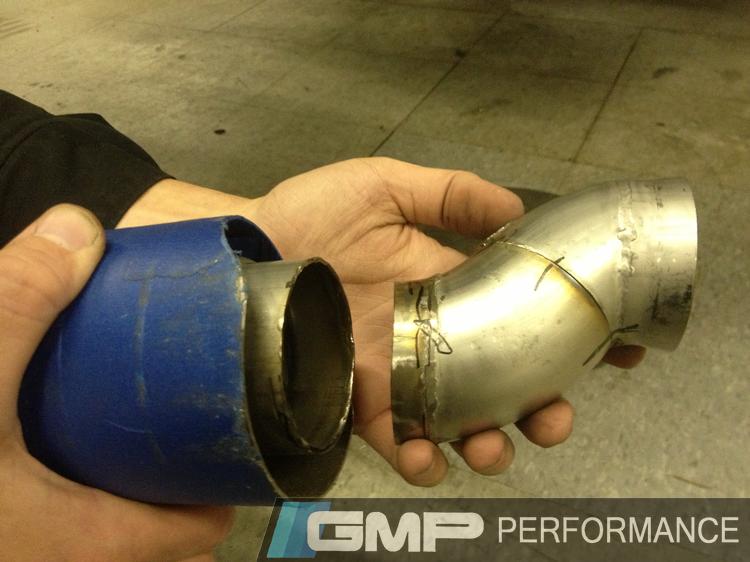

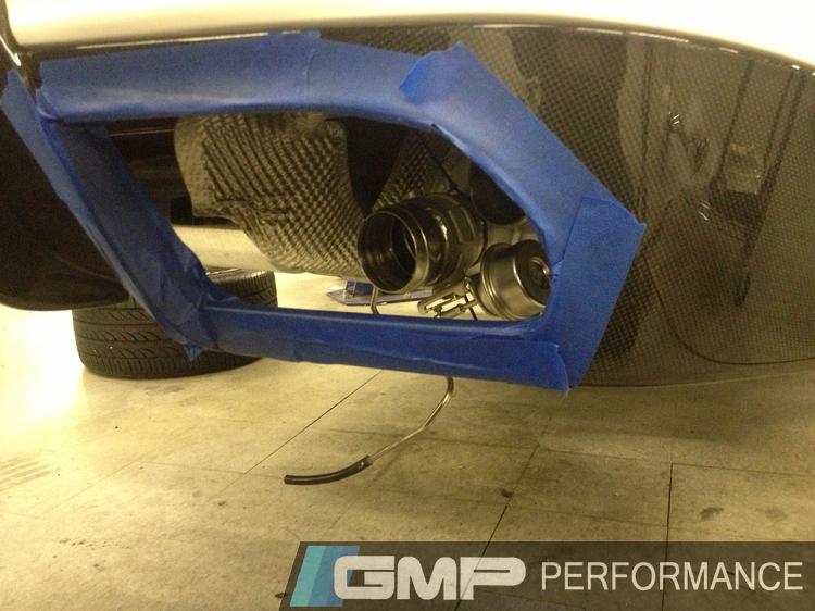

speedART Exhaust

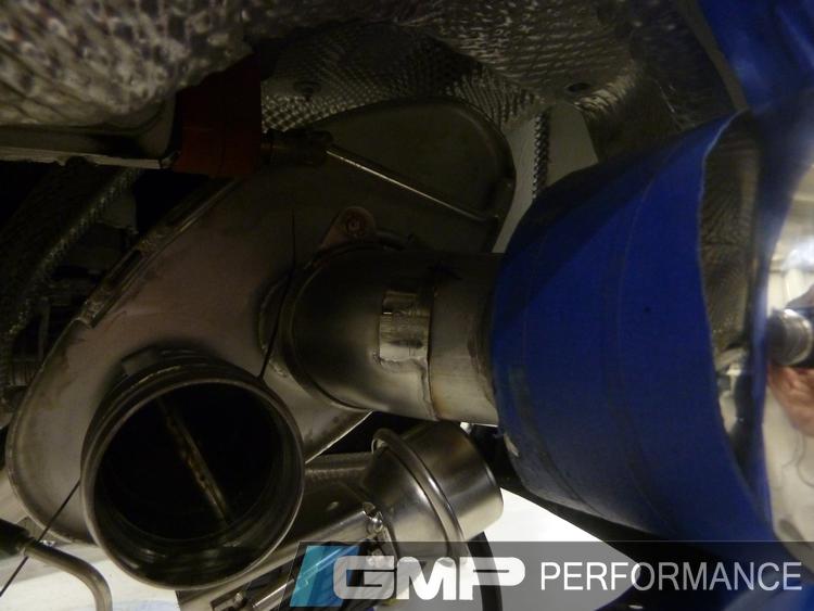

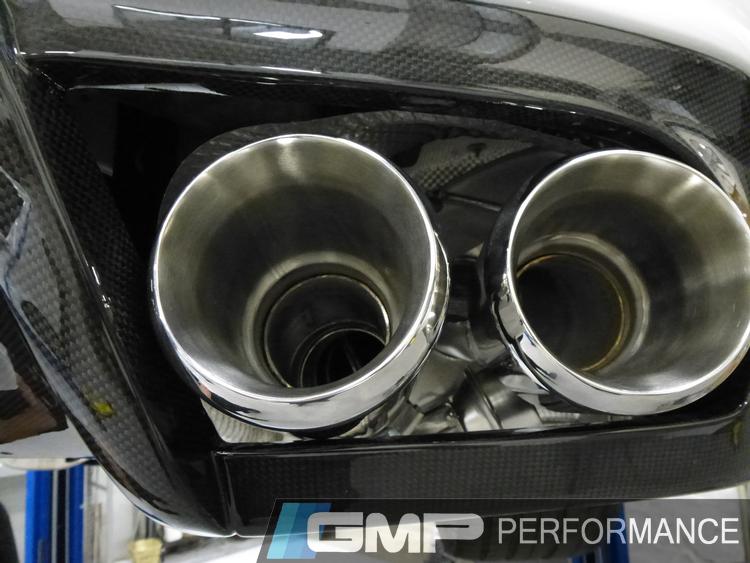

When you have big projects like this, the probability of never hitting a single snag is extremely rare and the Panamera was no exception to that rule.

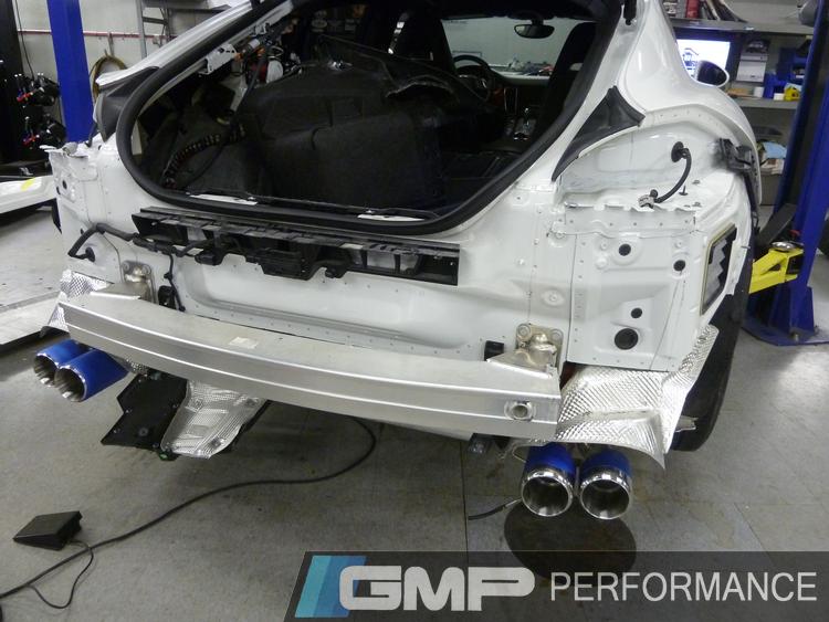

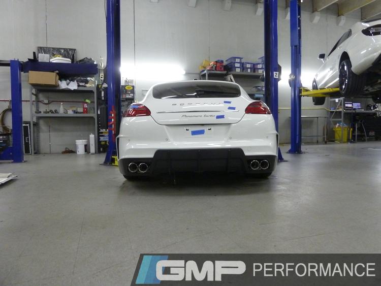

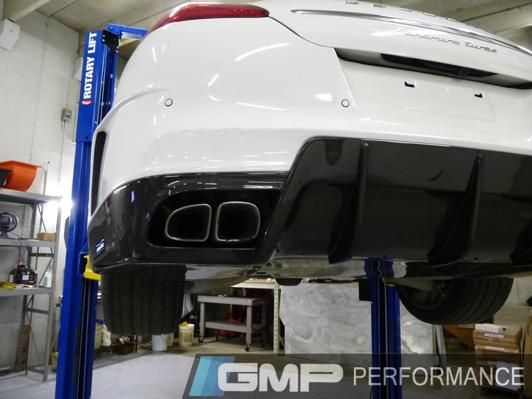

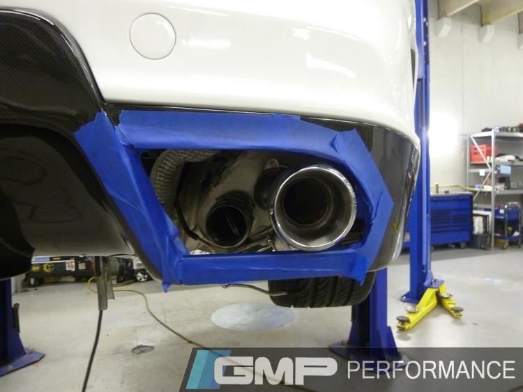

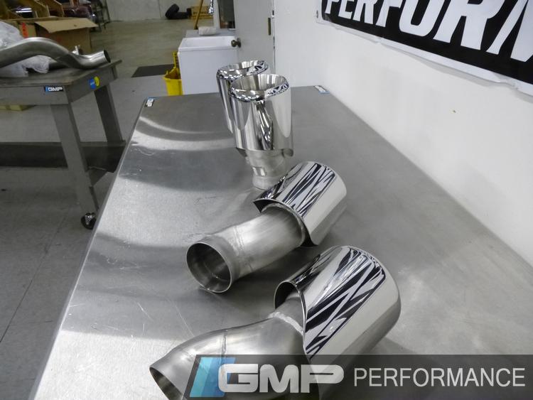

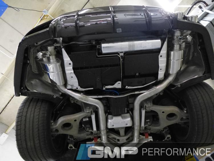

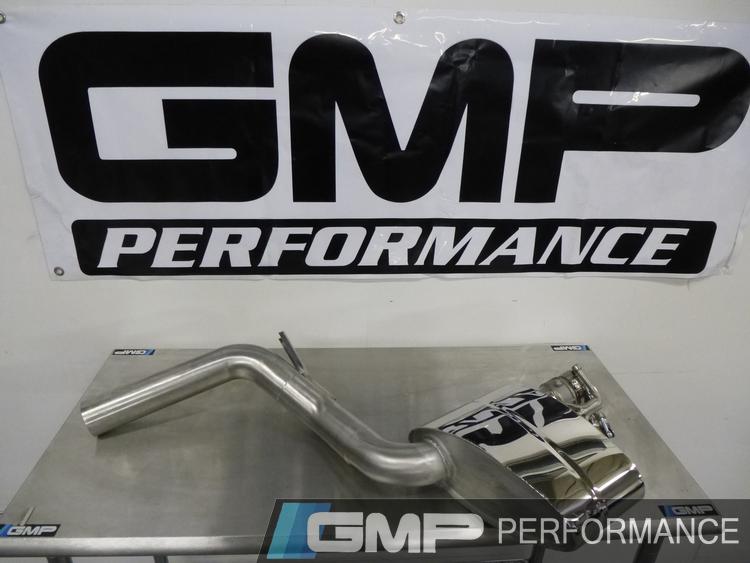

The SpeedArt exhaust system which was selected was designed to work with both the factory Porsche rear fascia and the SpeedArt body kit, but unfortunately the tips sat too low to fit with the Vorsteiner body kit.

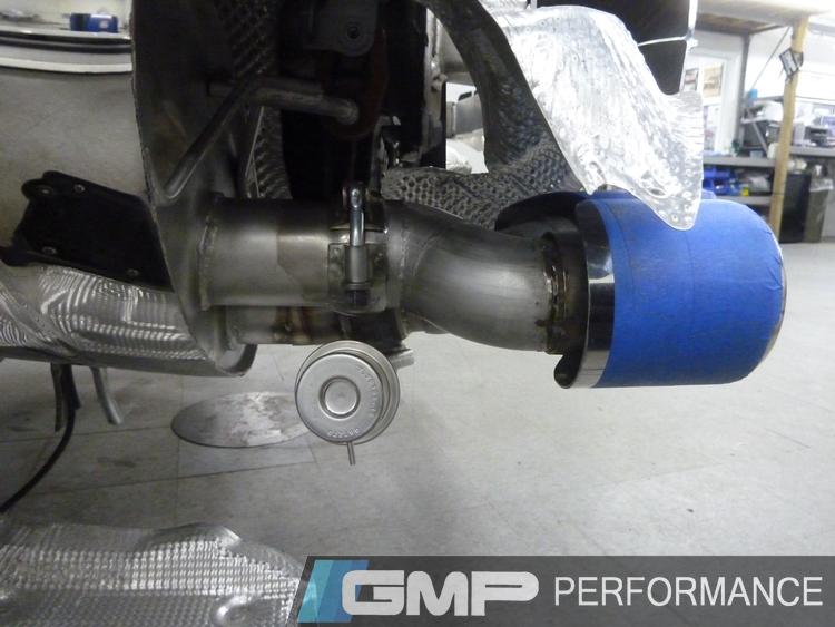

Once the Vorsteiner bumper was installed, we found the geometry of the tips would not allow them to properly fit into the openings of the bumper. The bumper was designed to fit a very basic tip, and the opening is very narrow. The speedART tips are very large (100mm each) and required an exact fitment. In addition, the fabrication of the tips were done at certain angles.

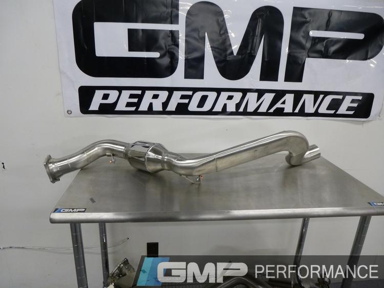

To retain the tip design, we had to disassemble the tips by cutting them apart into sections, and fabricate new angles to weld in. Then the tip itself had to be removed from the piping by hand cutting the old welds off because the tip style had to be rotated to form a correct alignment. The tip piping was measured, fabricated and then tacked together.
The tips were then repeatedly installed and torqued to spec throughout each additional tacked piece to insure that the tips were fitting correctly. Once the final pieces were tacked in place, the piping was welded all around. After they were completed, they were installed and adjusted to fit. The car was driven to get up to temperature and then they were adjusted to make sure there was clearance during expansion. The tips were then sent to get powder coated to match the wheels. Once they arrived back, we had to sand the tips at the mounting points to get them to fit and then install, adjust and torque them. A number of modifications were required, but in the end the result was worth the effort.

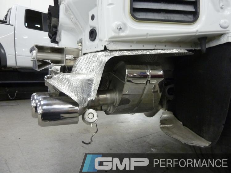

Stock tips and exhaust
New one installed

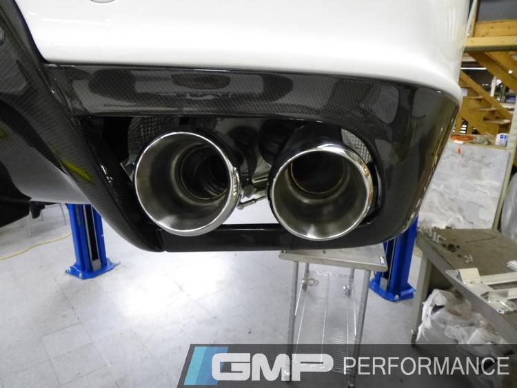

Something doesn't look quite right here...
Back to the drawing board
Through ingenuity and lots of work, they all get done. And it's totally worth it.
Powder coated, installed and all finished

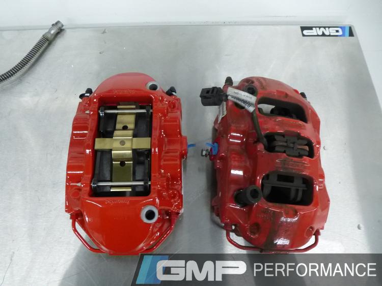

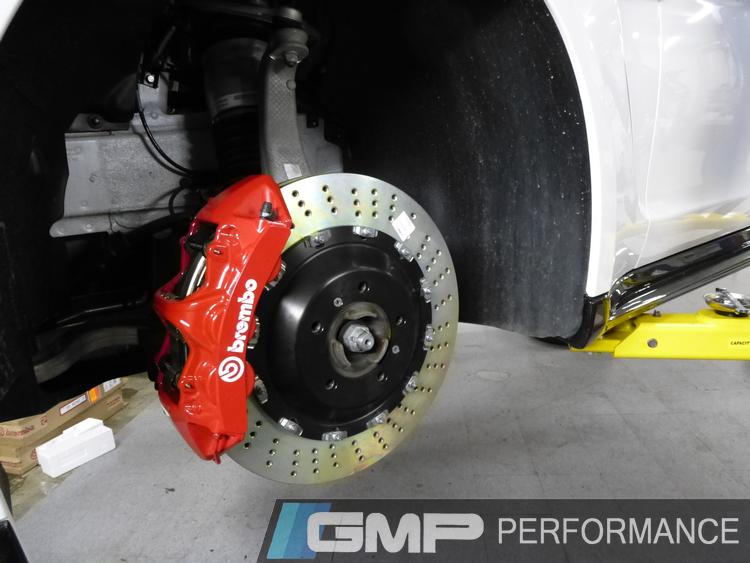

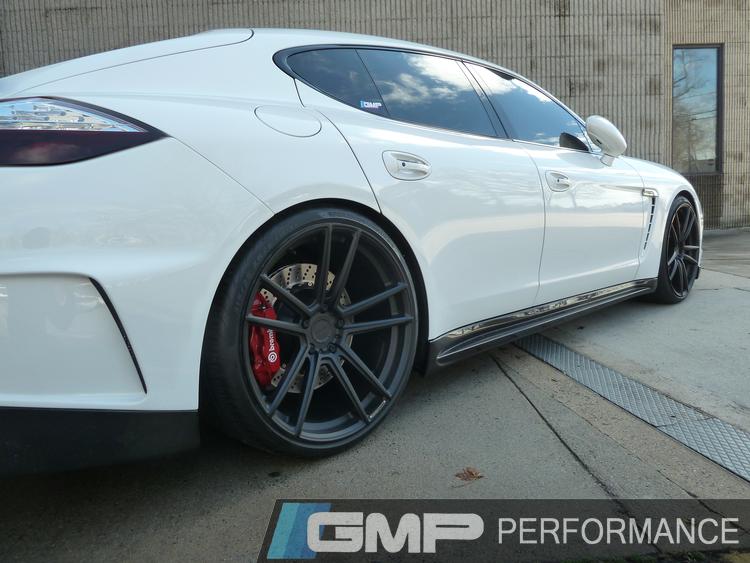

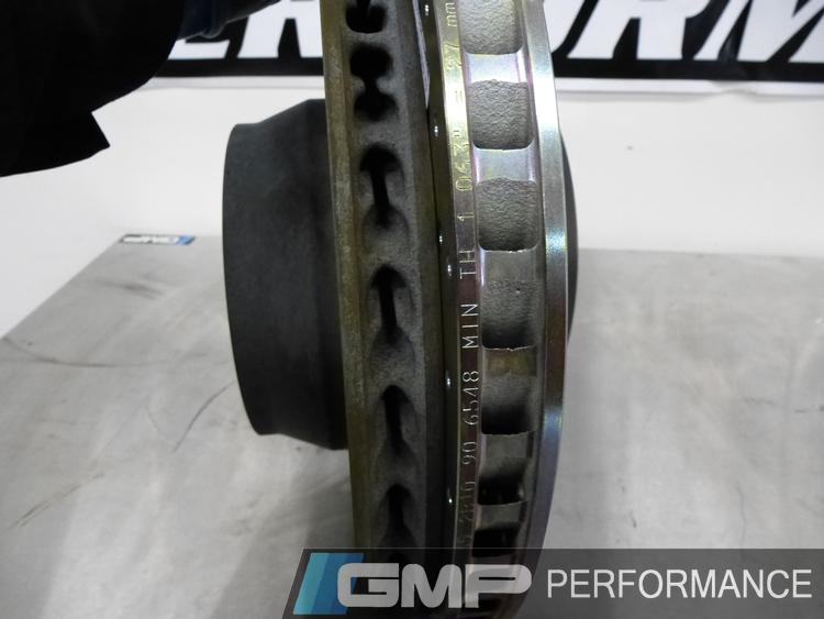

The Brembos
Brembo's on the left and OEM's on the right.

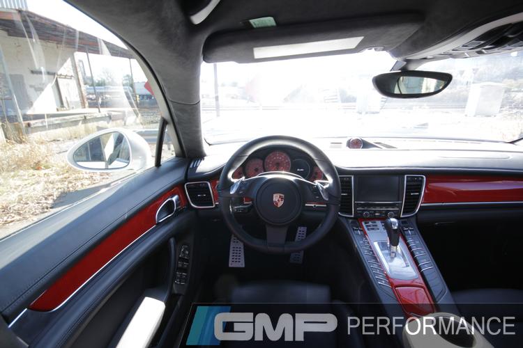

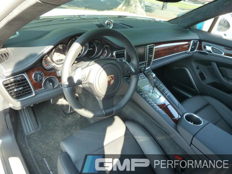

Interior

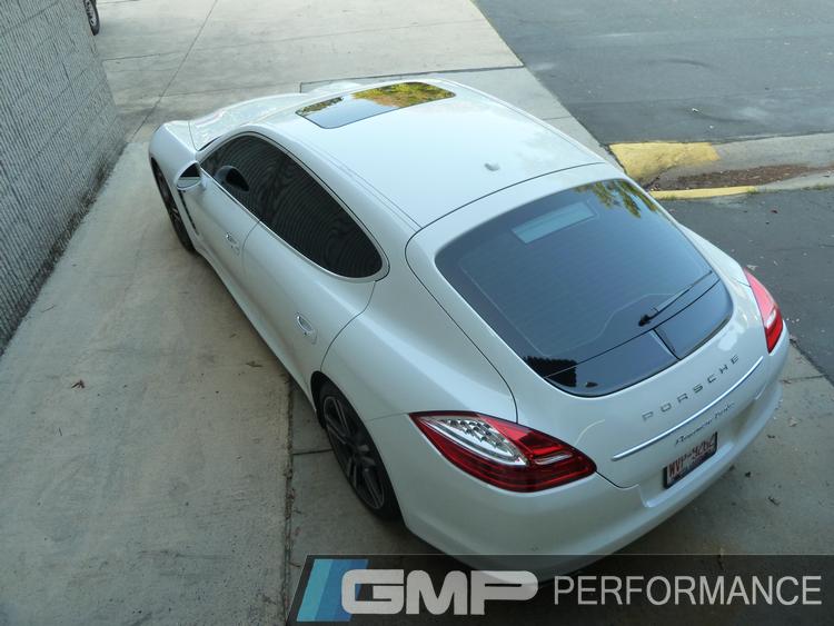

Angle from above showing the roof

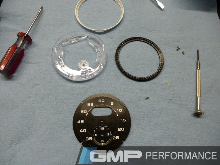

speedART gauges
