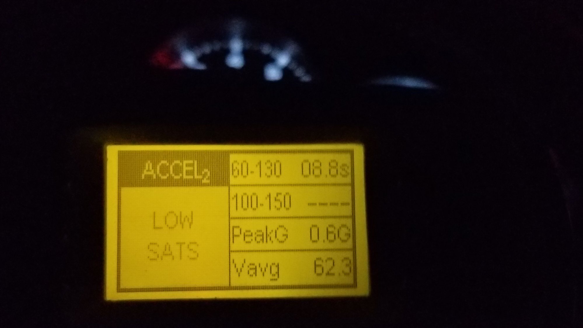

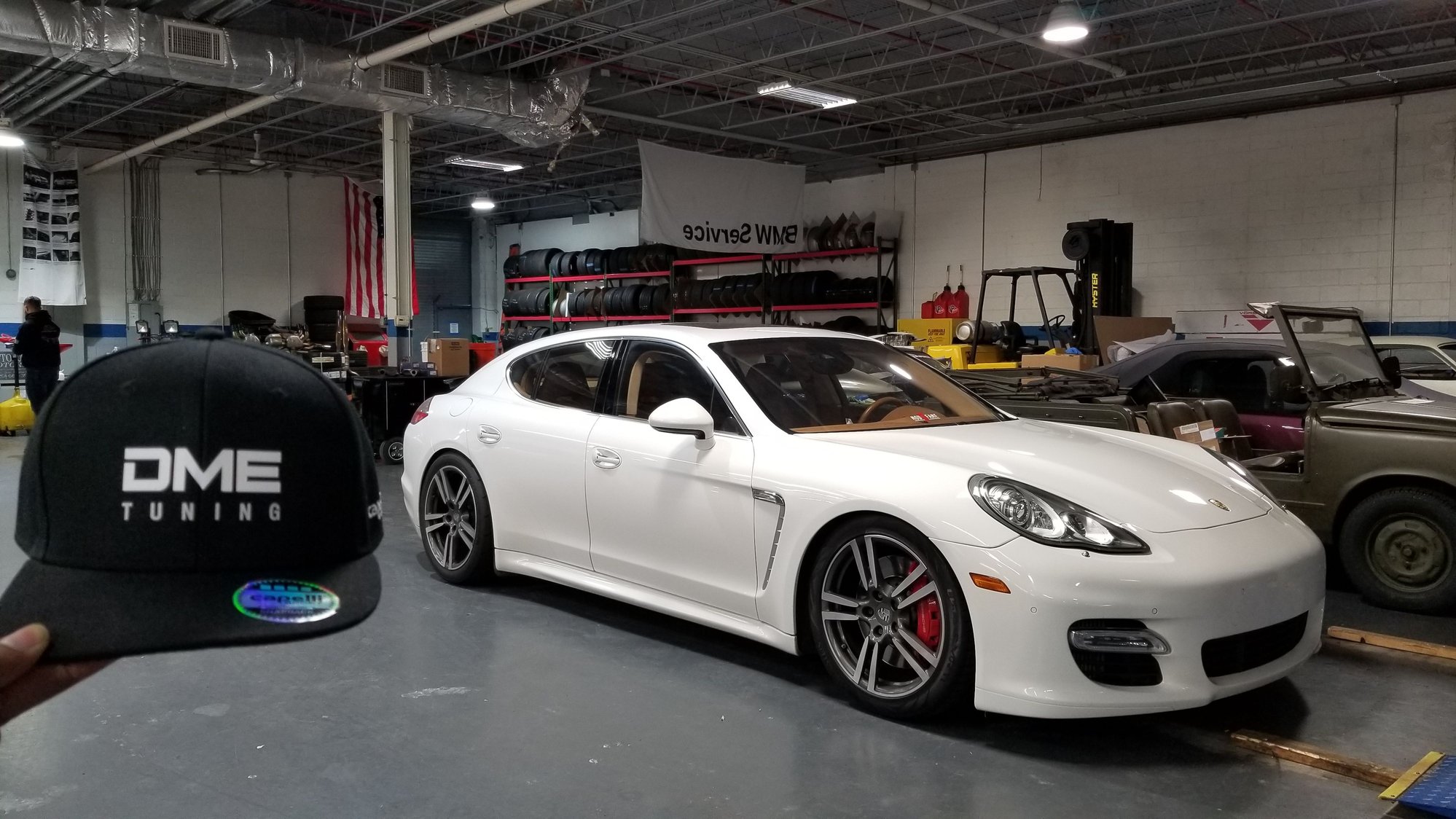

Old May 23, 2020 | 01:14 PM
  #49
murci930's Avatar
Joined: Apr 2013
Posts: 167
From: Readington
murci930 is infamous around these parts
Originally Posted by Mod2Fame
Well boys we are officially ECU Tuned. Who did I go with
the fine people at DME brought me into their offices which are local to me and bench flashed my ECU. Guys, the car feels so clean and all the drivability is like stock. In addition the way the boost comes in is smooth and it holds that boost throughout the rev range.
So the question is, is it faster than the chipwerke piggy back? Driving the car, it is hard to tell if there is more power or not. So I went to the vbox (my dragy died) to get the data i needed. It is too cold in the northeast for dig runs to test 0 to 60 or 1/4 mile, so my only test I can do is 60 - 130 mph.
My previous best is 9.05 seconds however I couldnt seem to ever hit that time again. Consistently the car was closer to 9.3 seconds.
Well now boys and girls we are consistently a 8.9 second 60 - 130mph car with 8.8 seconds being my best so far.
This proves that not only is the car faster, it's more consistently so. I look forward to heading back to the drag strip with some good prep and on full race gas. I think I see 10.9x in my future but we will see.....
