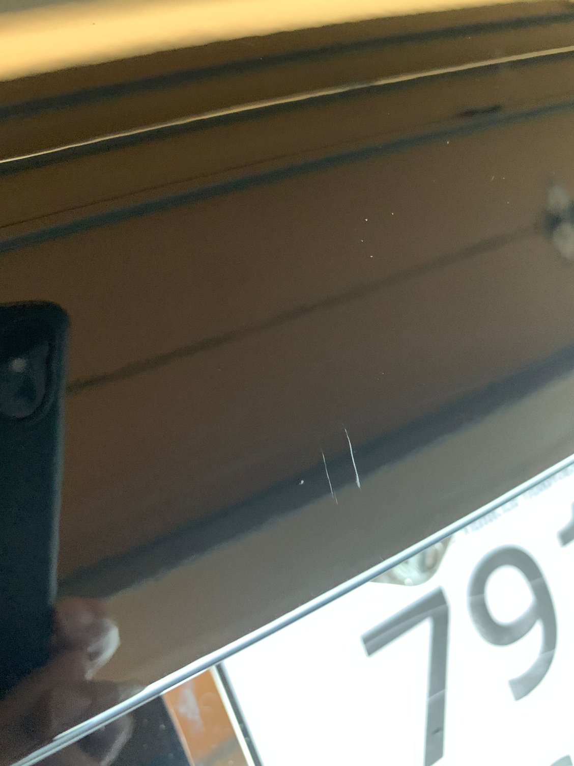

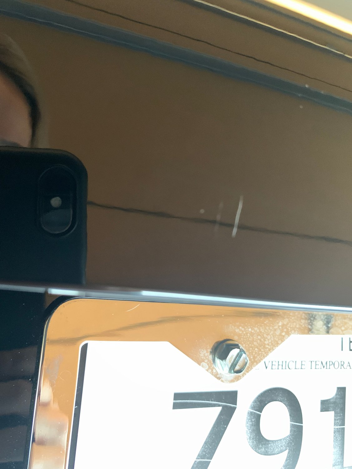

Hey guys. I just got my car like a month ago. I just discovered these scratches while washing it. Do these look like basic scratches or did someone key my car? Tried to get a good picture but it’s hard with the lighting.

I don't think you have been keyed. You may be able to get them out with a little compound. If you aren't proficient in paint correction you can pick up some Meguiars Scratch X 2.0. This is a very safe consumer light compound. You just rub on with a microfiber towel. With a little sccratch like that a little pee sized drop on the towel, 30 seconds of rubbing then wipe clean with another area of the towel and see where you are at. You may not get it perfect but you can probably make it much less noticeable.
Or any decent detailer could take care of it in just a few minutes.
Best of luck!
