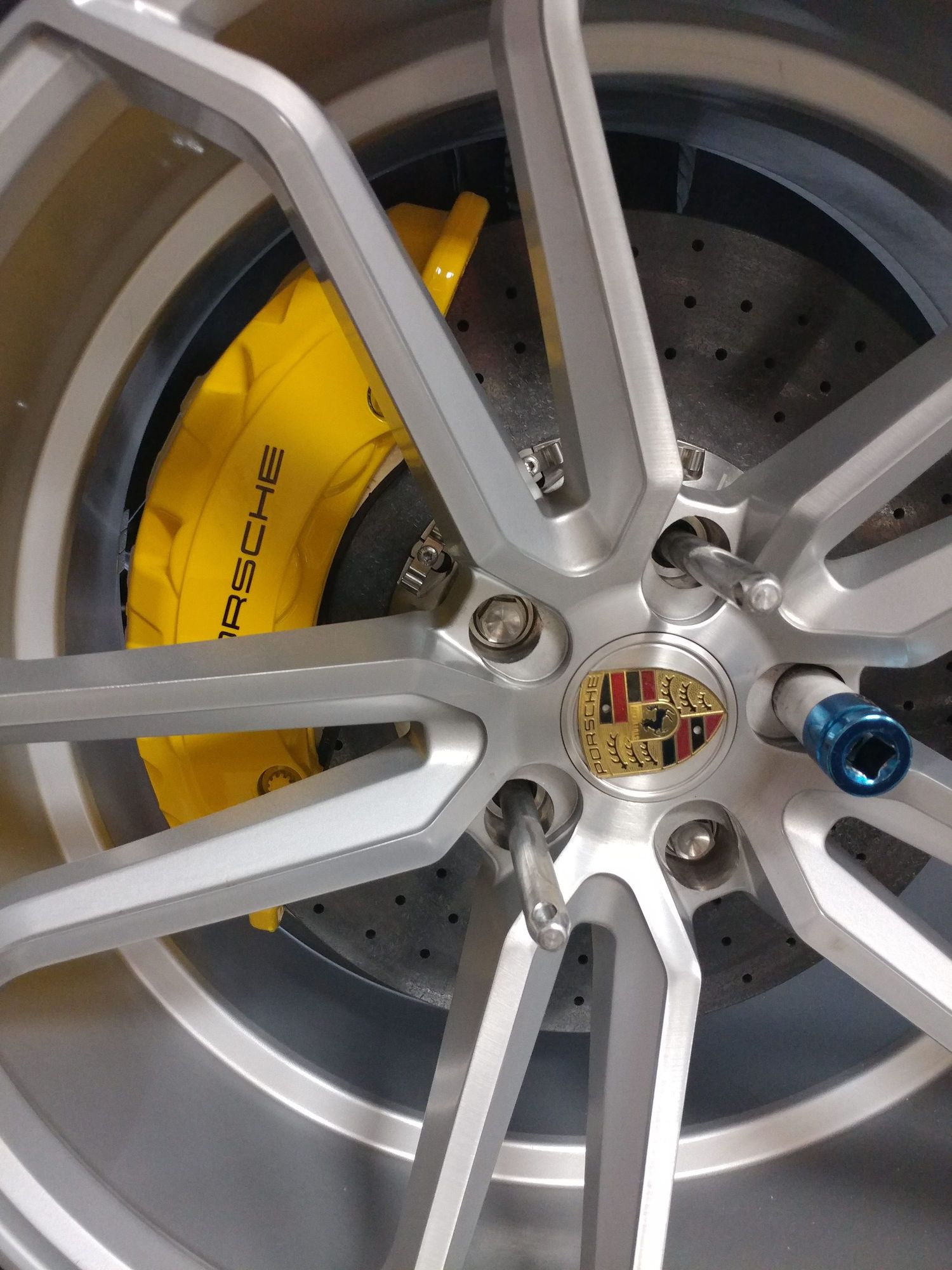

Wheel reinstallation. Ceramic rotors require the use of 2 guide pins for alignment to prevent the possibility of a wheel rotating and contacting the ceramic rotor, which can chip or fracture it. World Motorsports Ti Lug Bolts reinstalled at 110 ft lbs with Marine grade anti-seize (and why I use a lower torque than the 118 ft. lb spec). 410mm front rotors don't leave a lot of clearance space even with the 22" wheels, but that's partly due to the design of wheel's stepped lip.
