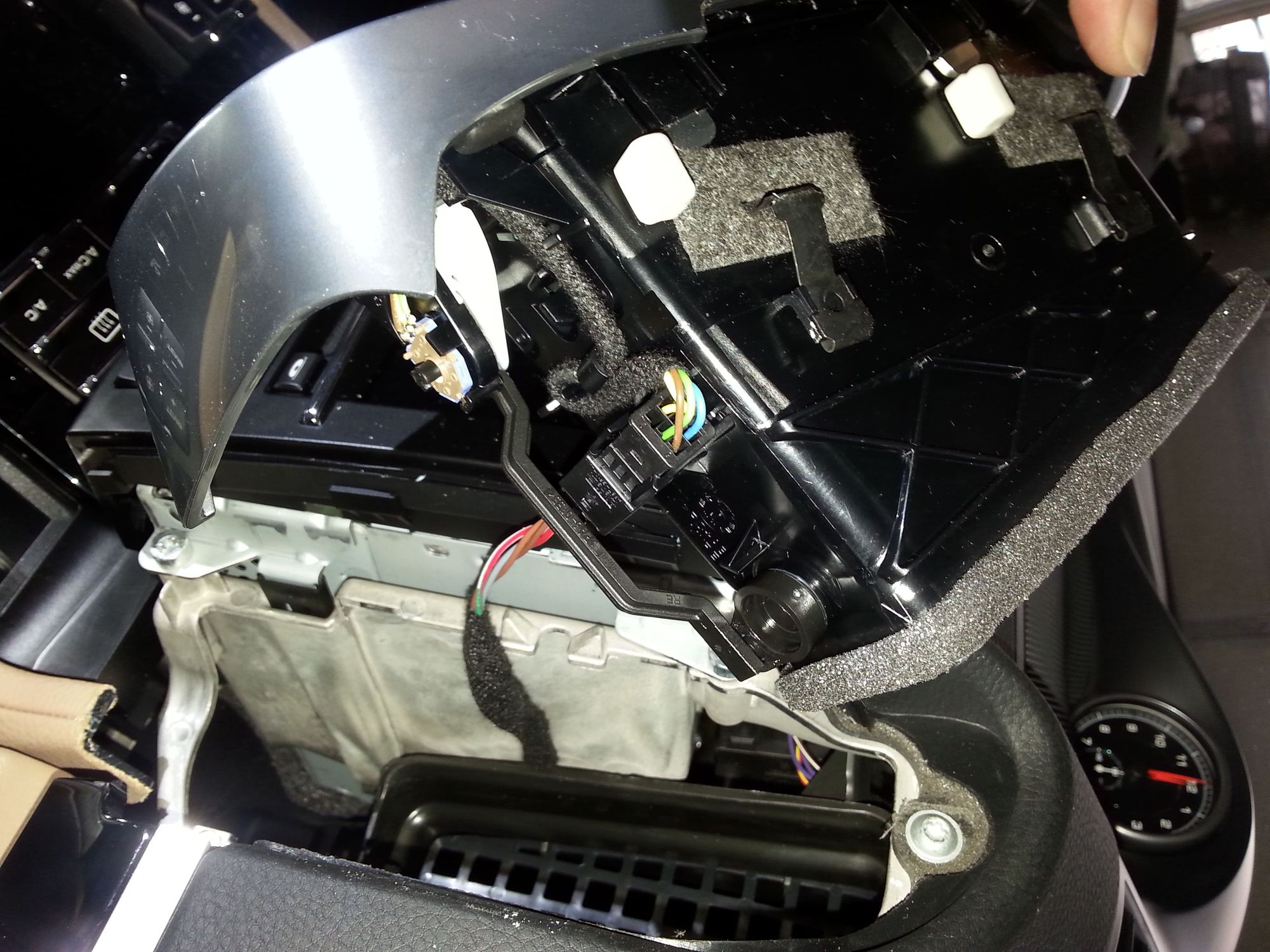

this is the side view of the vent after it's out. see the 2 black metal pieces with gray felt material? it goes through so when you pull on the tabs on the other side, it retract a little. that's all that is holding the vent in-spring loaded.
