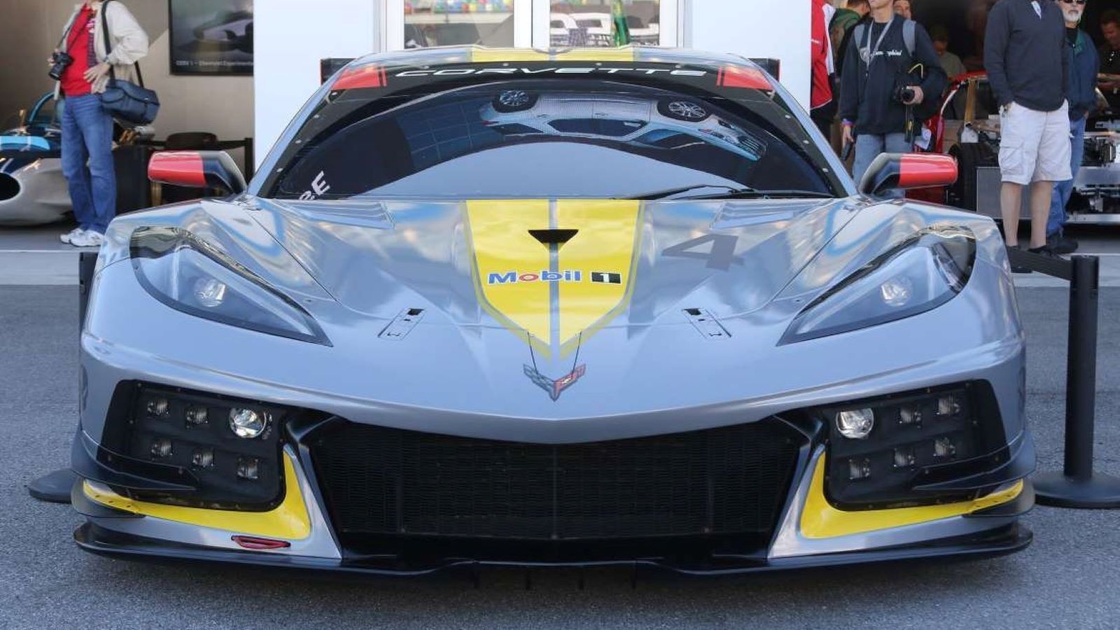

Limited Output
GM is still being very secretive with its new motor, which is why (unlike the production C8), the engine is hidden underneath its engine cover, not proudly on display. All they will say is that it's a 5.5-liter flat-plane crank, dual-overhead-cam V8 producing 500 hp and 475 lb-ft of torque. That may sound a little low, but that output is limited per class rules.
Photos: Hot Rod

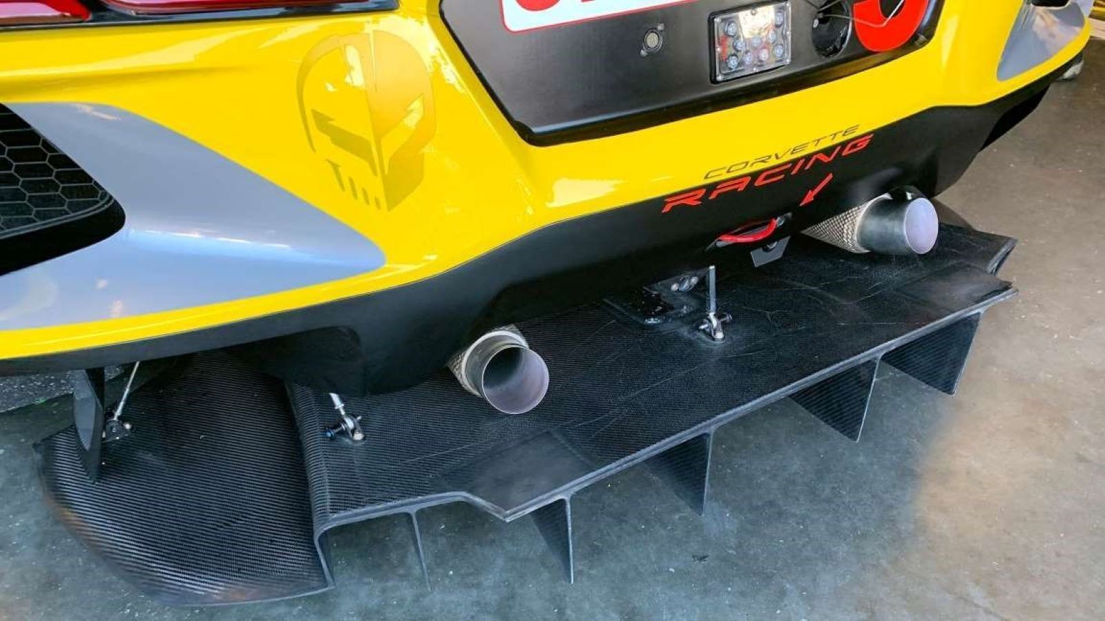

Slow Down
As Hot Rod points out, a cross-plane crank engine has two consecutive exhaust firings on one bank. Which helps it produce a deeper exhaust note, of course. But this isn't the most efficient setup in terms of exhaust scavenging. It also means they have to use large counterweights to properly balance the engine. These help keep the motor from rocking up and down. But they also keep rotational mass high, which makes for a slower-revving engine.
Photos: Hot Rod
