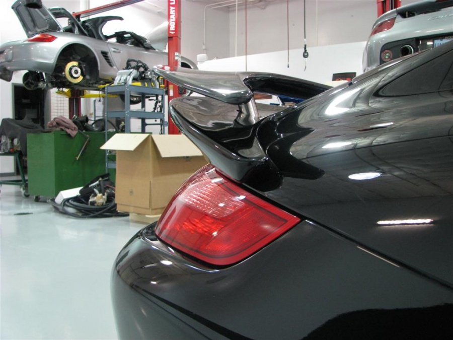

Or get this instead...

Bobby, don't show me that picture any more....must resist.......

Doug...you know you want it...
Man that looks amaazing. What wing is that? Can you link the site please?
