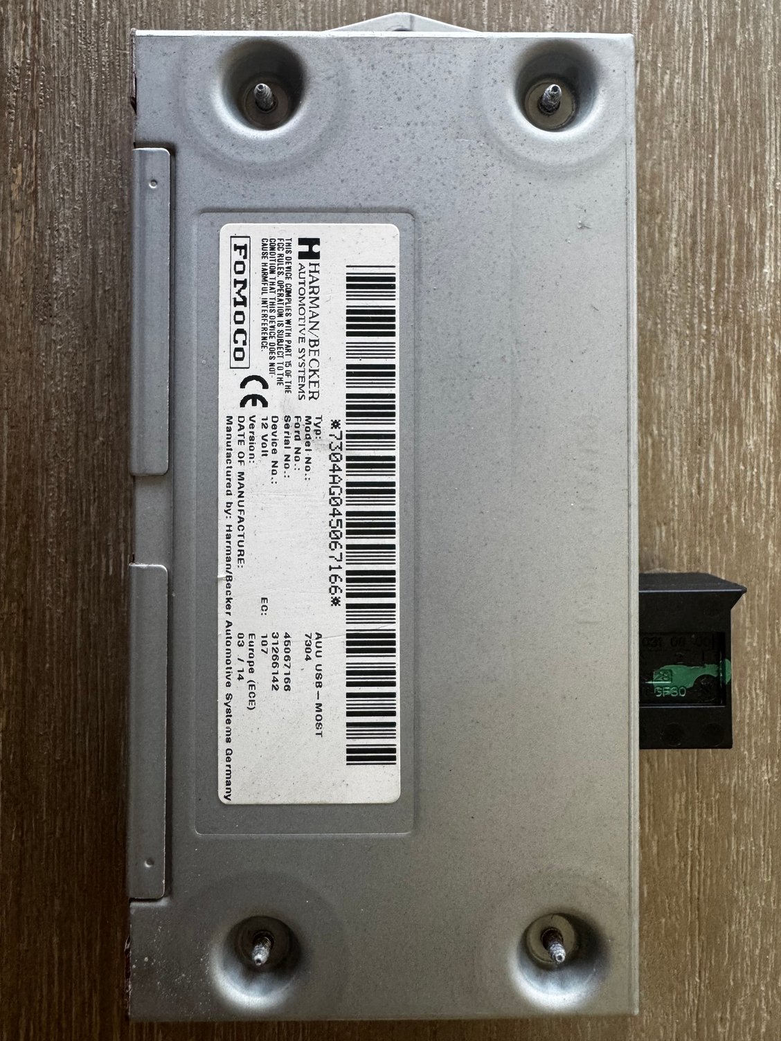

Update:
Following the instructions of the experts, I started unplugging modules one by one and testing. I unplugged this and after a short drive and clearing all the codes everything is back to normal!
I will be gone for a long drive shortly to verify.
Thanks to all who chimed in. This appears to be some sort of USB audio related module as I have no sound system now. But I have the sound of that sweet V12 back! It looks like plenty of these modules are available. Thankfully, they are not terribly expensive, but does anyone know if I will need any kind of dealer reflash when I replace?

Originally Posted by LaserK04
Update:
Where was that module located?
Old Today | 07:17 PM
LaserK04's Avatar
Joined: Apr 2026
Posts: 7
From: RI
LaserK04
Under the center console between the back seats. There are a few modules there. I unplugged them one by one and got some improvement when I disconnected this one. I met someone tonight that has direct experience with this and was advised to start chasing loose or corroded grounds.
