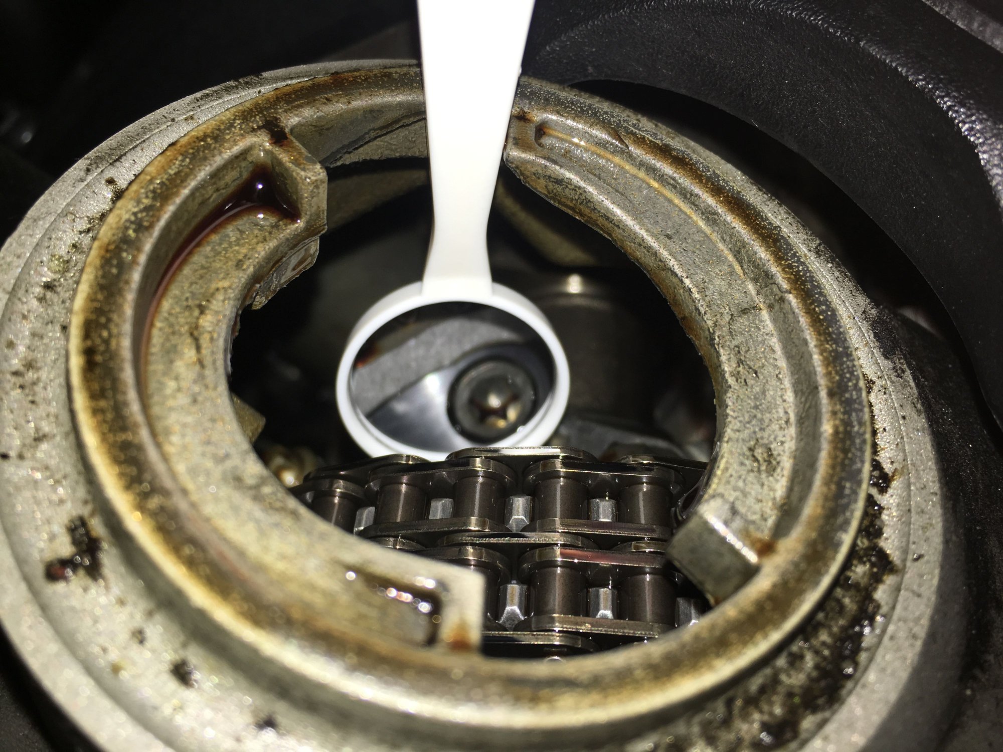

So reading through the last 28 pages of this thread while at work this morning (it's a slow day in the markets ....), my paranoia got the best of me so I nipped off to CVS to buy a dental mirror to check my bolts after work ..... I've got a '12 Cayenne S (build date 09/11), so I'm right on the edge of the dates that I've seen associated with the faulty bolts. I'll know more this afternoon, but in the meantime I'm thinking that 8 bucks for the dental mirror for a DIY check is a better use of my time and resources than getting the runaround at the Stealership! And I get the tongue scraper and dental pick as an added bonus

So the $8 dental mirror paid off .... Checked the bolts before my drive home this evening and as far as my old man eyes can tell, these are the dark bolts with NO pin in the middle but I'm hoping the experts on this thread can confirm..... TIA for your help to calm my paranoia about these friggin' bolts

As I posted over on RennList - those bolts look fine. They are not the problem ones.
Rock & Roll, thanks Don!

I have the 'bad bolts' AND the last two numbers of the part are the bad ones. You can see the 21 in the upper left hand corner of the photo.
I used the flashlight from my iPhone and saw that I had the bolts with the middle pins. My local Porsche SA who actually participated in this thread told us that in PA where I live, I am covered under the 7 year / 70,000 mile emissions warranty BUT I don't want to go through the hell of something like waiting on a new engine and a 4 leaf clover for Porsche to cover this.
