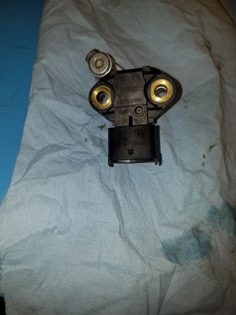

Once I replaced the oil pressure sensor, the temp showed much lower, and the oilpressure (while fully warm, at idle) was showing much higher.
With defective switch, my pressure at idle was at about 1.0 or 1.1 sometimes. With new switch in, at idle (same conditions), pressure was showing at about 1.6. Big difference.

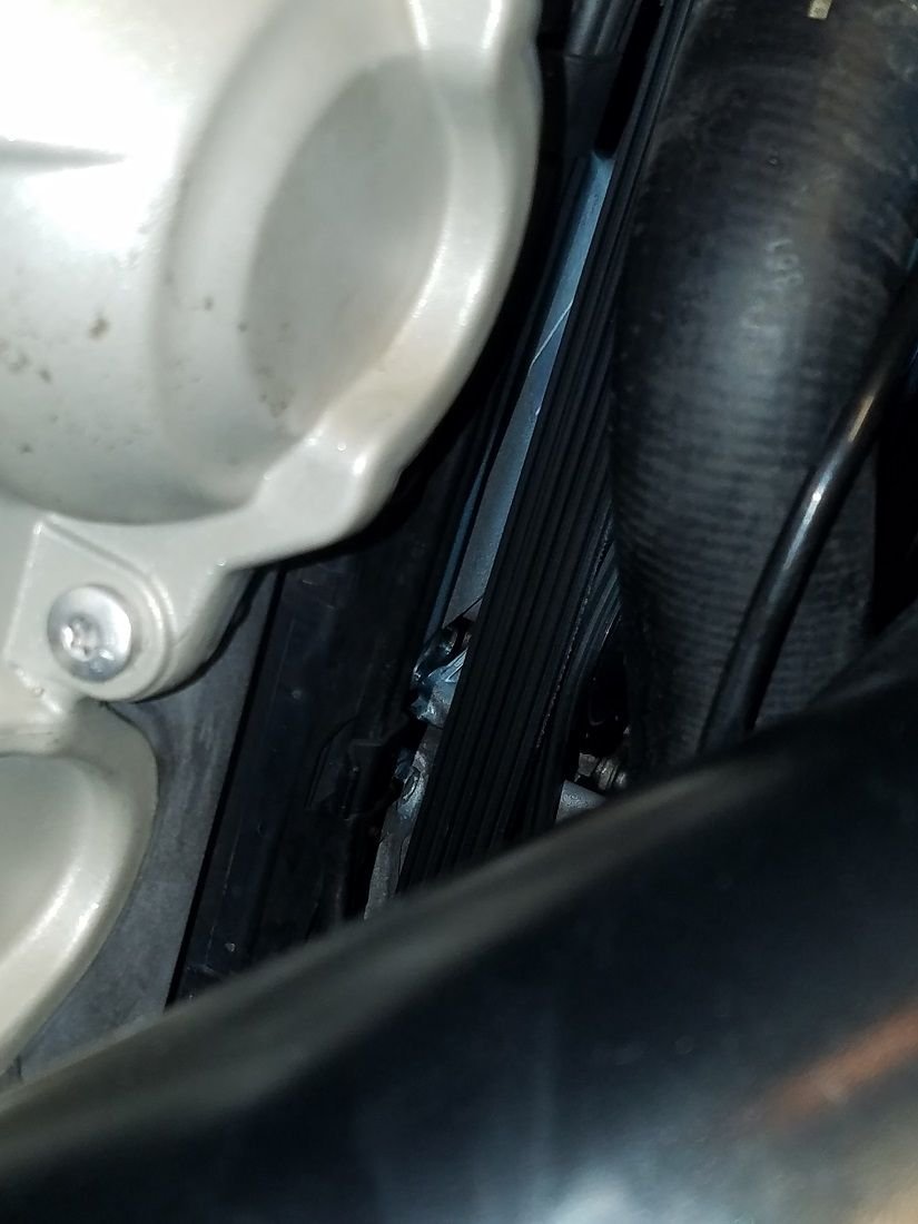

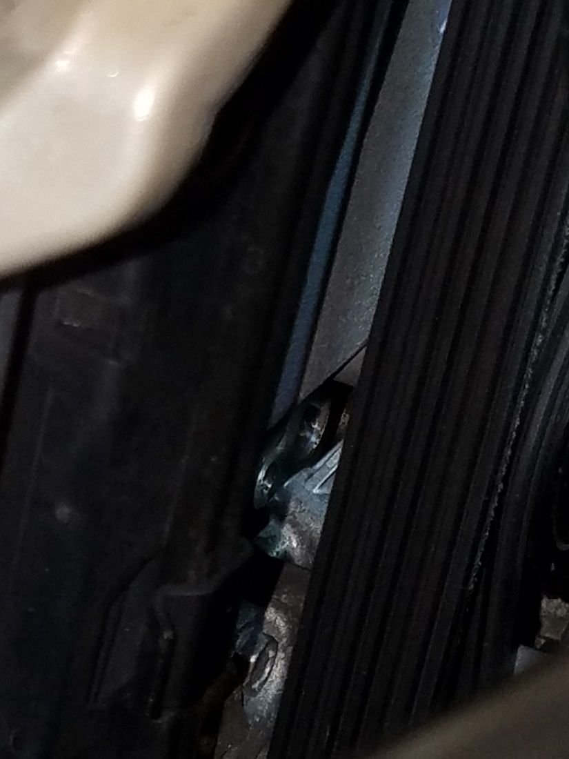

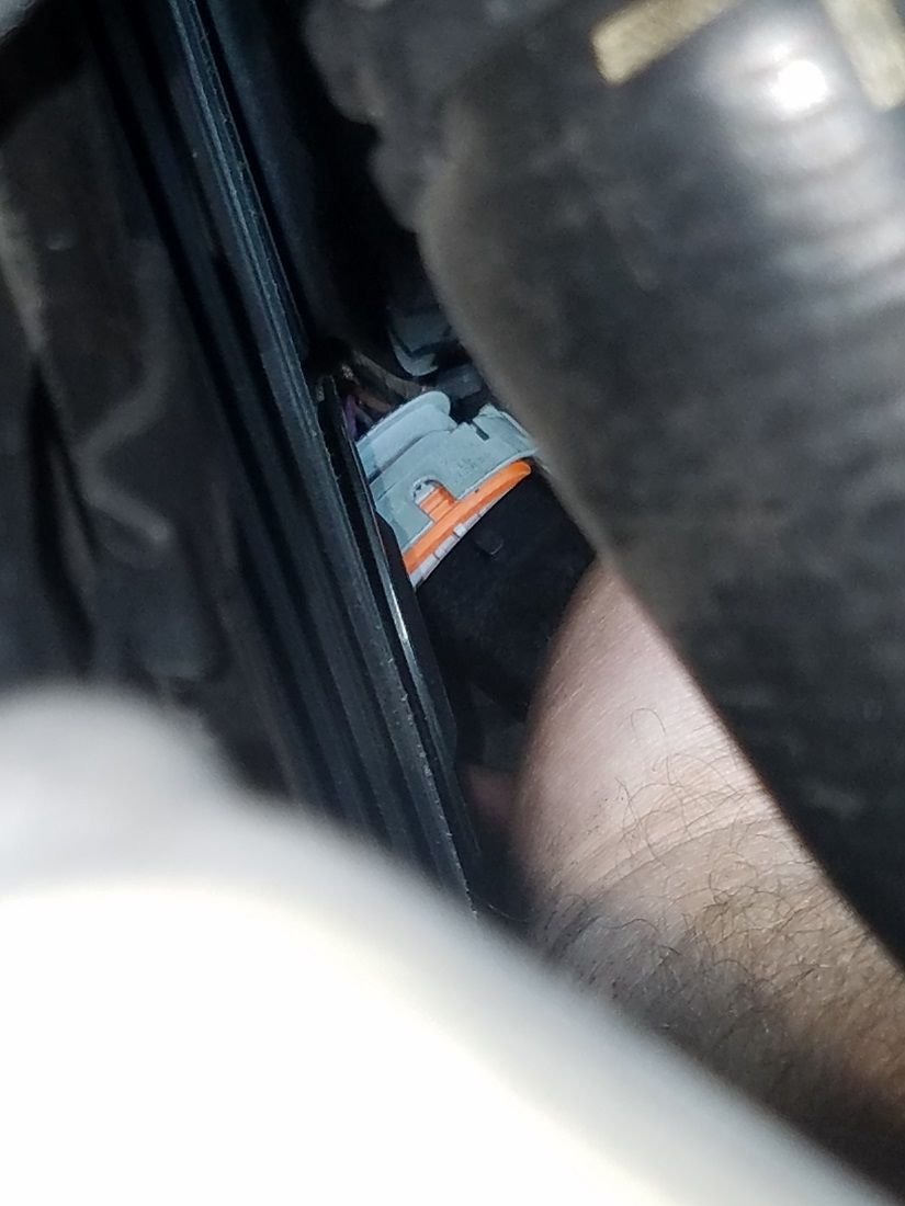

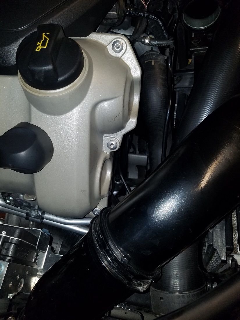

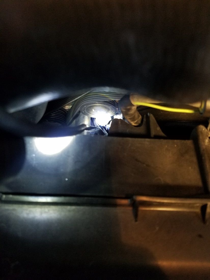

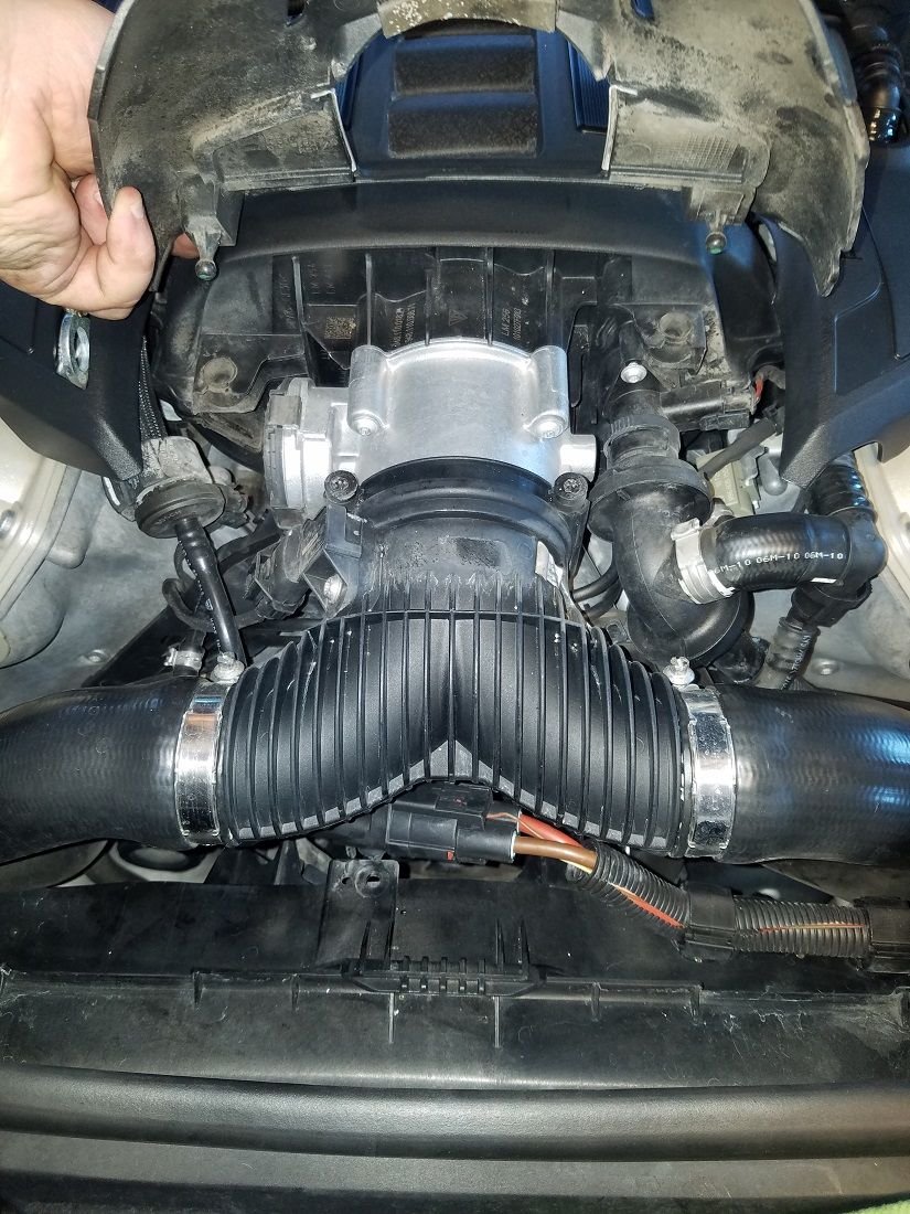

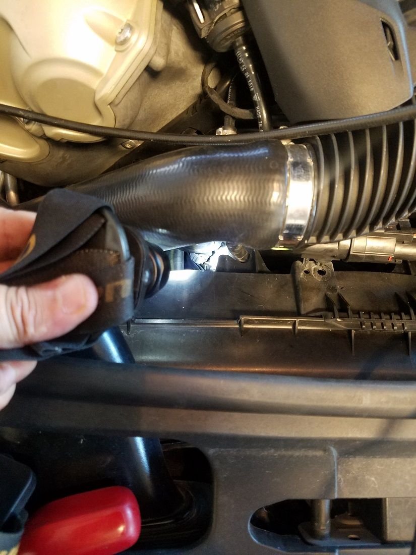

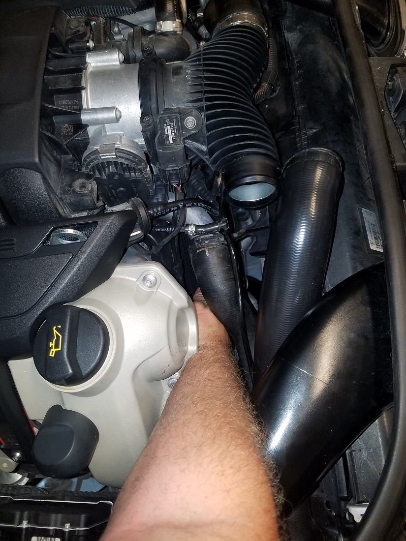

About sensor location:
The sensor is #8 on diagram.
standing at front of car, facing it, sensor is located on passenger side, front of engine. It is to the right of the pulley, under the drive belt.
The flashlight illuminates the location.

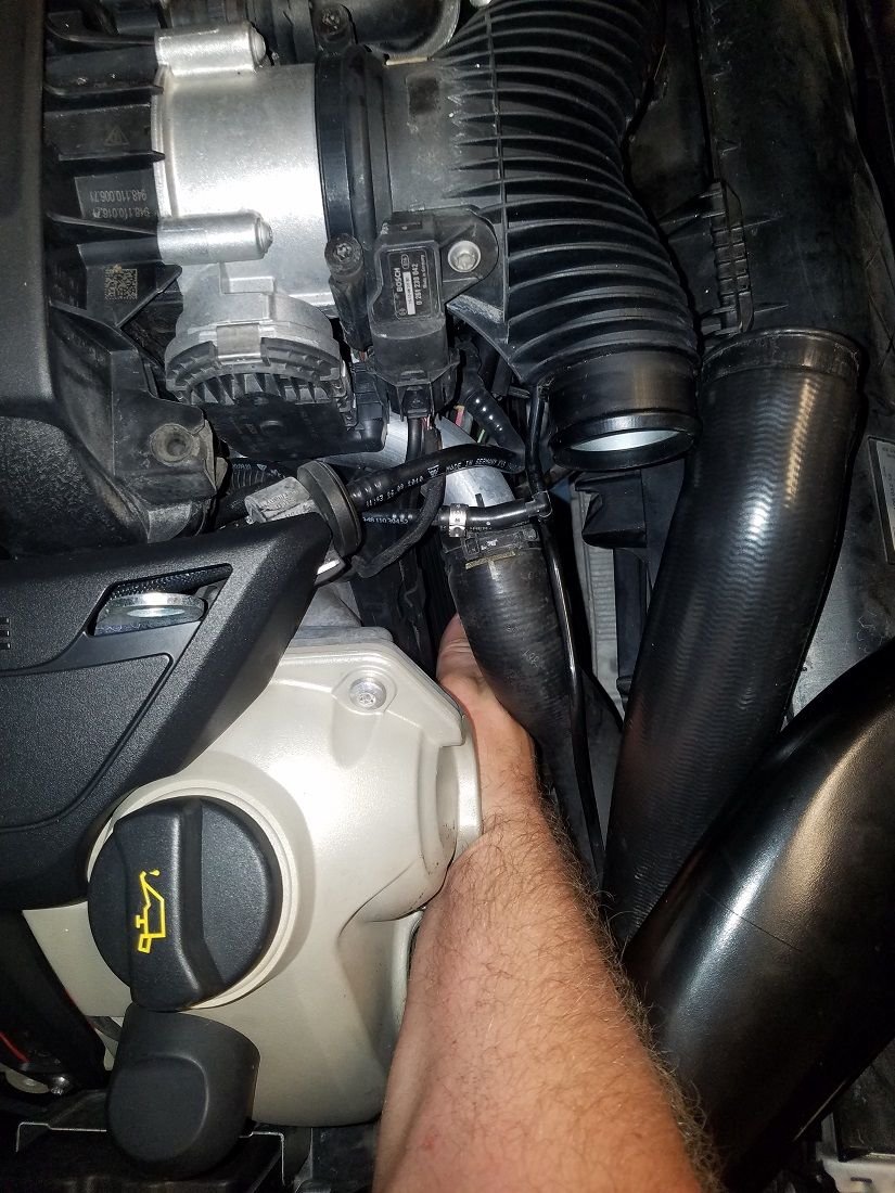

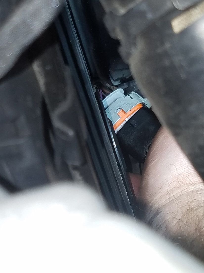

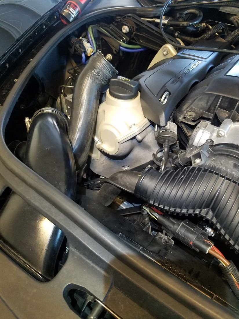

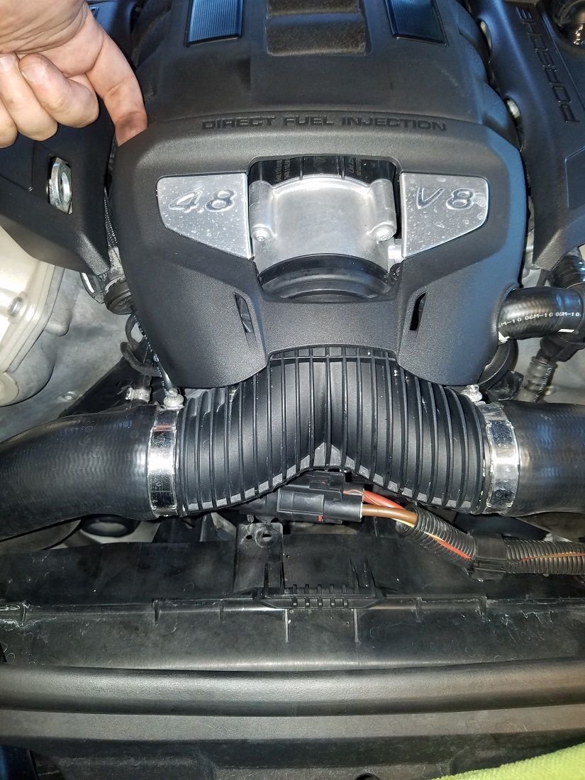

You can barely see it from front. You will be able to see the two E-torx screws , don't remember size, prolly e8 or e10. Once you have the intake hose off, you can squeeze your arm between valve cover and the rad hose.
TIP:

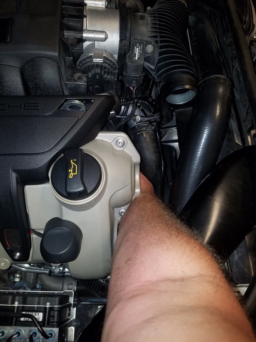

- If you are left handed, it will suck for you. Your fingers must be facing towards sensor.
- Huge help - wet the inside forearm of the arm you will use, with motor oil. Don't ask me what grade, lol. There, I used 5W40 castrol. It will help the arm slide past valve cover, so fingers can get to the bolts.
Small socket driver needed to get into that space.

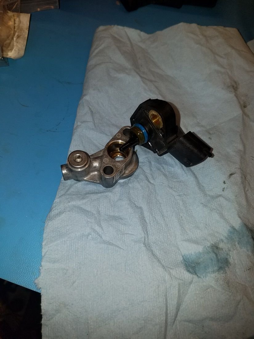

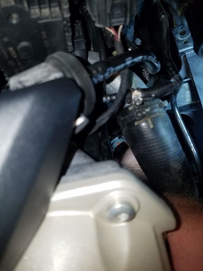

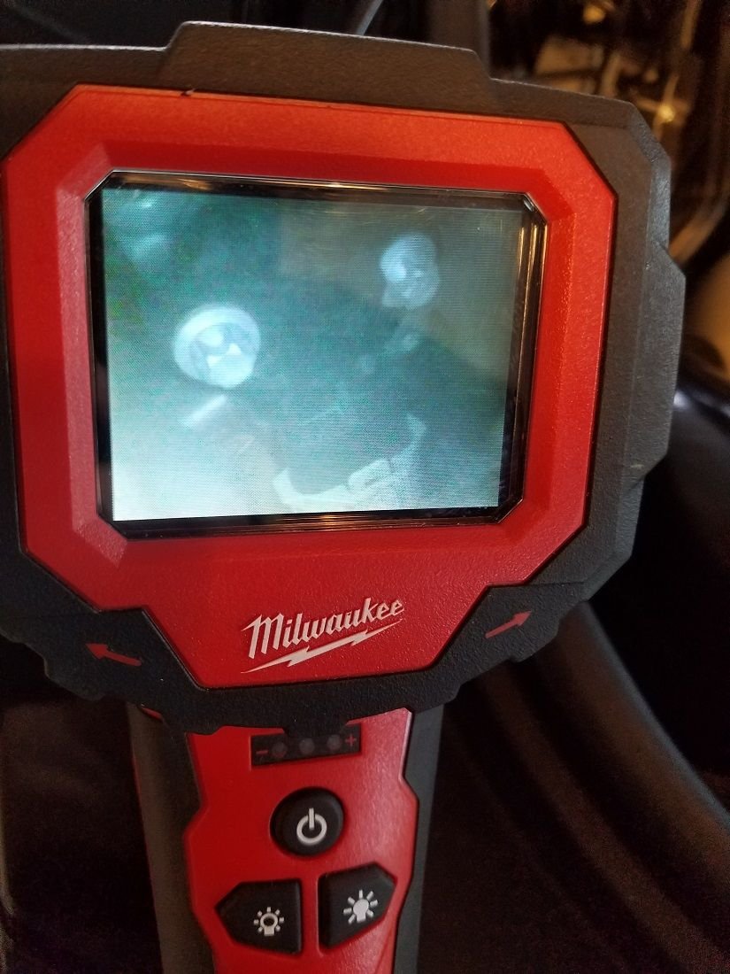

Another tip is don't remove electrical connection from sensor until you remove the screws. Then, the sensor with its metal bracket, will slide out of the hole, and you can play with removing the connector. Small flat tool needed to pry the inner tab, from what I remember. Gentle. If you break the connector retainer tab, the whole connector may slide off over time. You will be back to same symptoms, even though sensor is good.
Recommend as a 2 person job. One to do work, while other one assists with camera if you have, giving drink, and encourage you not to quit. As anything in life, if you determine yourself not to quit, you will be successful.

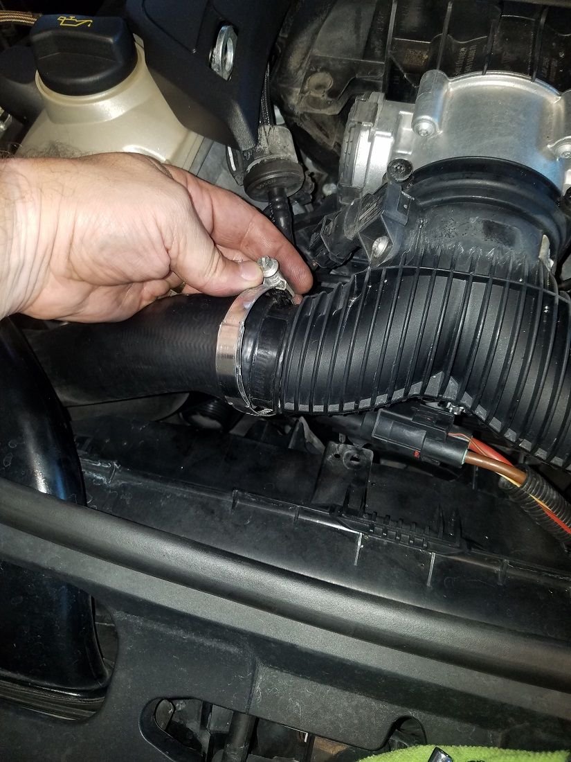

Well, here is the partial stuff......
DIAGRAM OF OIL PRESSURE SENSOR LOCATION (along with locations of other sensors - for your reference):
REPLACEMENT PROCEDURE
(these pics are unedited, but you will get some sense of it all , until I get time to prepare and annotate correctly).
For now, trying to help folks out so posting what I have as is:

Thanks for the DIY with pictures. I did this today and you are not kidding about it being a tight blind space. Getting the old one out and disconnected was no problem. Getting the new one in was a pain in the butt. I did it myself but could have used a helper to hold the camera. I wouldn't even attempt this without a snake camera. I also would not do this again. Whatever they charge for this is worth it. It sucked bigtime. Hopefully, it cured my issue. We shall see! Thanks again for the DIY!

Oh and it's an E10 socket for the bolts holding the sensor on.

Thank you so much for this post, I just did mine.
If you remove the cover below the engine and have a second person watching and guiding you, its really not that bad.
Apart from the time lifting the car and removing the cover, the actual job replacing the sensor took no more than 30 minutes.

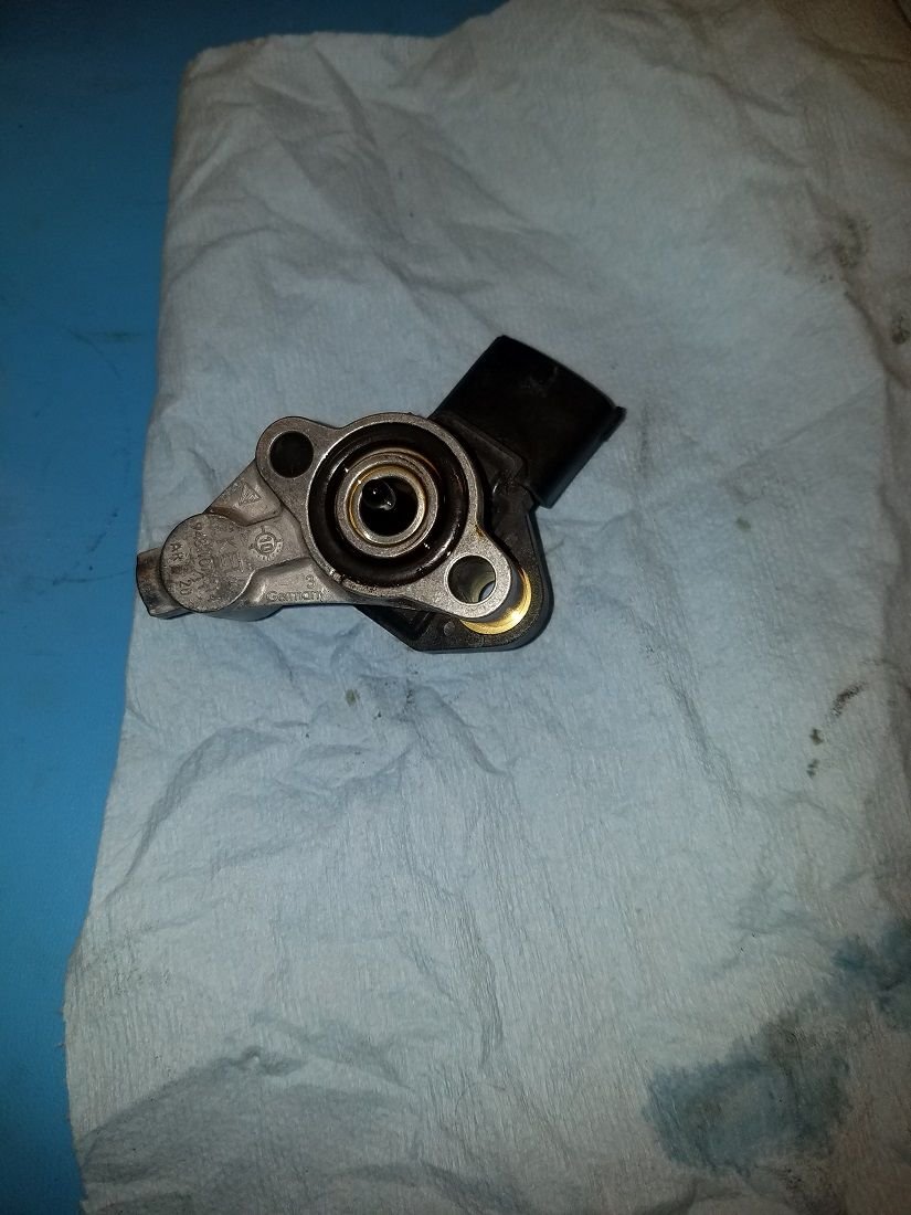

Additional information:
- there is a pin on the front of the electrical connector you need to push to get it out.
- there is an O-ring between the engine and the metal part behind the sensor that does not come with the sensor, remember to buy that beforehand.
