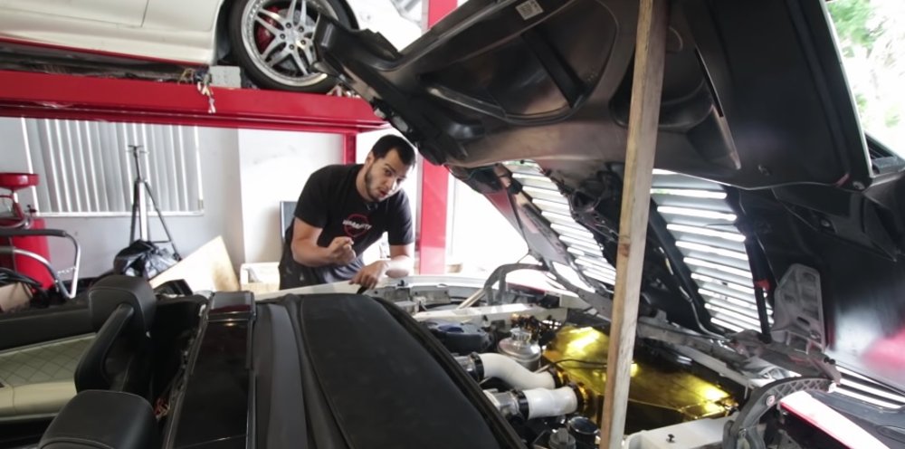

Check the PCV System
The host begins by explaining how his dry dump oiling system works and how he does not run a conventional PCV system. On a car with a traditional PCV system, excessive crankcase pressure can lead to oil being sent into the intake at unusually high rates, but his Lamborghini doesn’t have a recirculating system, so there is no chance of this being the cause of the burnout oil. Just to make sure, he shows us the spotless intake tubes.

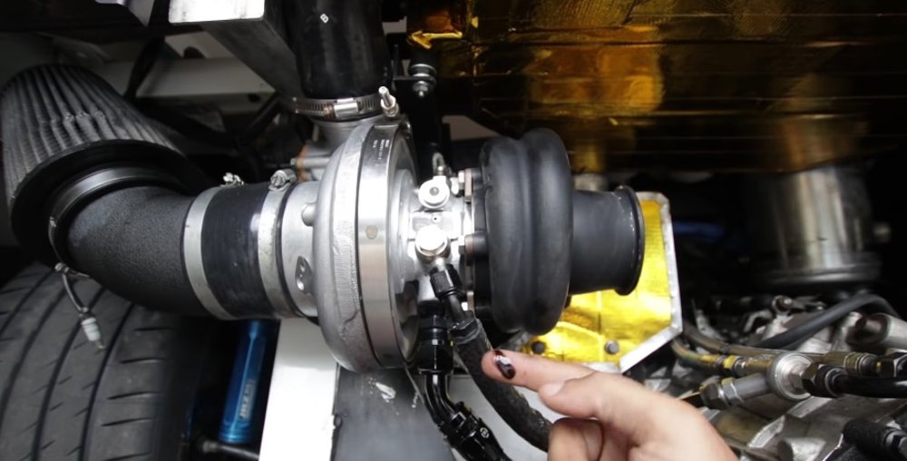

The Troublesome Turbocharger

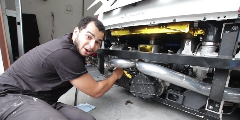

Next, he looks around the rear end of the Gallardo, focusing on the oil lines running to and from his twin turbo setup. When he spots some oil on the garage floor below the driver’s side turbo, he has found the location of his problem. Upon further inspection, he finds that the oil is leaking around the seals and dripping off of the outer housing of the turbocharger. The inside of the housing is clean on both sides, so the host believes that there is excess oil pressure causing the leak.
Lamborghini Turbo
While he doesn’t know for sure, he believes that a Y-fitting in the oil return line system is causing too much backpressure and as a result, the oil is leaking around the seals of the turbocharger. However, he doesn’t know for sure, so if anyone reading this has any input on how to fix his problem – he is clearly open to suggestions.
