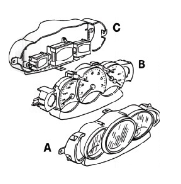

Okay, before anyone beats me up, I know there are kits available to overlay the gauges/dials on an instrument cluster... Moving on.
I have a 2001 C2 Coupe/6Spd manual with black gauges/dials on my instrument cluster. I recently acquired (at a ridiculous price) a 1999 C4 Cab/6Spd manual instrument cluster with silver/aluminum gauges.
Now, I realize I can't do a 1 for 1 swap for two main reasons: 1. The odometer setting can't be changed (mine is at 42K the new cluster is at 114K) and 2: the C4 fuel sensing unit/wiring is different than the C2 cluster.
Here's my plan (see diagram): Disassemble both clusters and combine Part C (the electronic guts & odometer info) from my C2's cluster with Parts A and B (the dials and facia) from the C4's cluster.
Theoretically, I think this should work. Where am I going wrong? I appreciate ANY help/advice/expert knowledge in advance. Thanks.

Thanks for the reply, but I'm really more interested in the compatibility issue between the C4's Part A & B with the C2's Part C than in resetting the odometer. Will something short out if I try to mate them and then install them, or is the worst that will happen will be an inaccurate fuel gauge reading? Or something else? Any ideas? I don't mind trying something that fails...as long as I don't cause major damage doing so. Push comes to shove, I'll just do a gauge facelift. Thanks again, Macster.

Can't help you regarding electrical compatibility/signal compatibility between the two different clusters.
Just a reminder: A new cluster is very expensive. I seem to recall the price of a new cluster for my 2002 Boxster was around $2K. A used one cost me nearly $500 and I made sure I got one *exactly* like the one in my Boxster so I didn't have to worry about incompatibilities. The last thing I wanted to do was ruin the new 'used' cluster or worse damage my car's electrical system trying to get a strange cluster to work.
