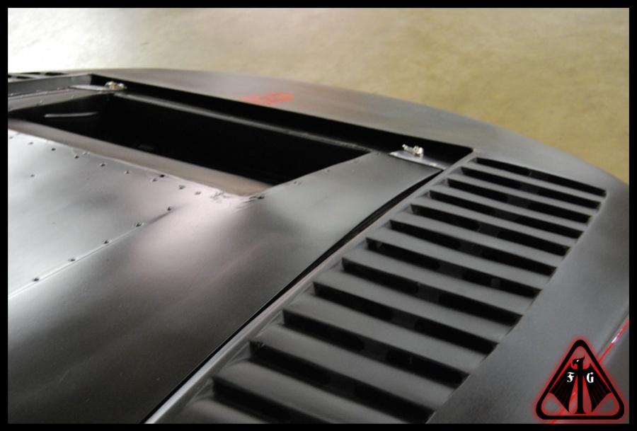

I should note the box is constructed of thin fiberglass fabric layers with layers of carbon fiber in between. Wanted a period correct look and finish so we laid the fiberglass over the carbon for a final product.

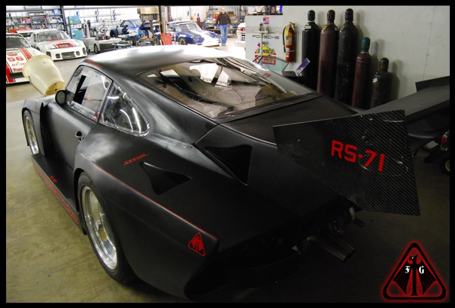

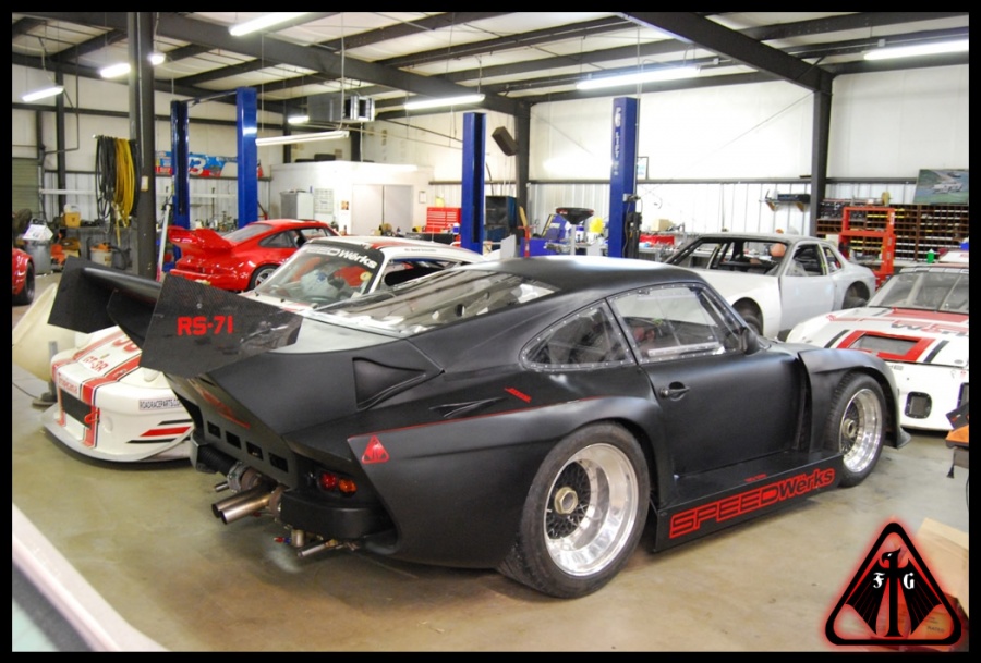

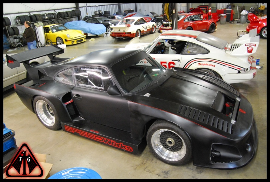

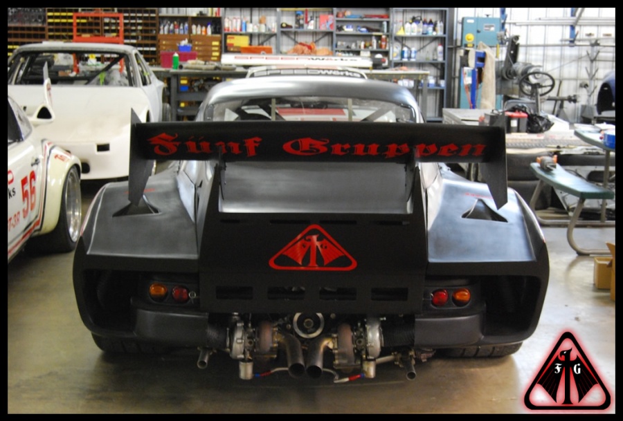

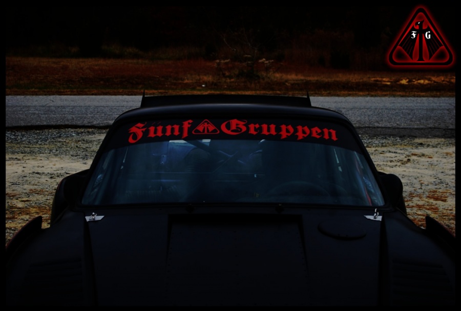

a few more pics

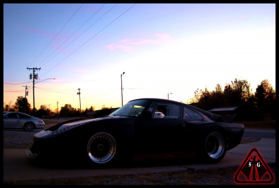

A couple artsy shots for giggles.

Thanks for the kind words guys - been doing some fine tuning on the street and dyno, going to have an upcoming track day on Feb 5th at CMP.
As far as Porsche forums, I started my own at funfgruppen.com along with my own enthusiast site for the 930 and hardcore grassroots enthusiasts.
Here's a couple pics ya'll might enjoy.
