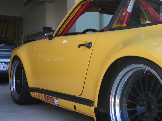

I highly recommend Jongbloed wheels. There are custom made, light, and very strong. I've had 3 sets of 18 inch wheels for my 911. Ryan is very experienced making wheels for all Porsche models.
http://jongbloedracing.com/index.htm
