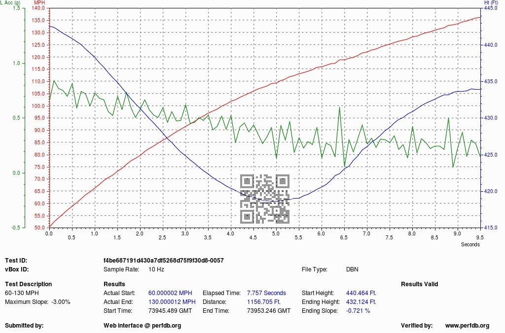

Originally Posted by longboarder
Hi Chris, yes the car is bone stock except for the tune.
I can only estimate the amount of E in the tank. Our Cali 91 is up to 10% Ethanol. I mixed about half of a 5 gallon jug of E85 (which is minimum E70 and typically E77-E84 based on my buddies with flex fuel GTR Ethanol readers) on a full tank of 91. Too much E and the Porsche ECU will likely flip out so I was careful to start with a very small amount. I est that I put 2.5 gallons of e85 which probably blended to e25.
I agree e25 is not enough to get race has results but hey at $1.99 gallon and given my 60-130 results. I'll take it particularly since the standard GIAC OTS isn't specifically designed for e85.
My 997.2 fuel system will be able to handle about 800 wheel on pure e85 so this is just the tip of the iceberg for my testing on the 3.8 DI platform. While my 997 will not be tuned for e85 for another few months, I'll stay with race gas for the upcoming shift sector event but I will run the 991 on the same e25 blend with a goal to hit 160mph which I would be awesome for not putting a drop of race gas in.

A couple amatuer-ish thoughts come to mind around the addition of E85 and the results/comparibility.
First, E25 is going to have a good bit less specific energy to it than standard "E0" 91. If you were to run a wideband O2 sensor, Im guessing you'd see the A:F slightly higher than GIAC would expect, given their tuning.
I'm also going to *guess* that GIAC tuned a car to the ragged edge of knock and A:F and then backed the tune down for safety before they called it the "OTS". Who knows when the fuel a customer grabs wont support the octane of energy density that a tune would need? Safety is necessary.
My last guess is that the DA at 5:30 AM on a cool morning in Southern CA was amazing. Cold air, cold intercoolers, etc. The car was absolutely in it's safest possible environment.
So I don't doubt that you ran an amazing time. But I'm pretty sure you were running the engine a little leaner than "OTS" in a really great environment.
No cheating, just optimizing and risk taking.

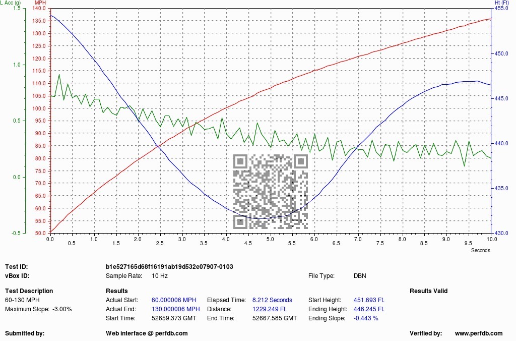

Well I looked at my Vbox data from COTA and my best 60-130 there was 7.5s and that was on the grand stand stretch. Of course the track isn't as nice as the road that long ran his run on. The track definitely has ups and downs in every 60-130 that the Vbox data shows. I also looked at the AP data and it's even slower than what Vbox measures., more like the best I see there is 7.8s. Now I should say that TC is on when I am running at COTA but not at the drag strip. Anyway, my car is much slower but the IATs are definitely much higher for the data points I have on 60-130. We don't know what the IAT was on long's run but it's a single run on a cool morning so it's probably low 100s at the top end. Mine are typically 130-140 on the top end.
I would have thought the data from COTA might be closer to what long described since I come out of the curves at about 35-40 mph and then roll on the throttle to WOT before I hit 60. There were plenty of times in the COTA runs where I had the back stretch to myself and didn't have to move over to pass or slow down any because of cars in front of me. Anyway, the best time from COTA with a hot car running around the track repeatedly was 7.57s. I am pretty sure this is from the grandstand stretch. The second one is the best time from the back straightaway. In addition, this is with VP101 and nothing else. I filled the car twice that day.

Just for grins, here was my best 60-130 with the FVD piggyback on the car back in July. Of course I am sure the IATs were blistering but one can see how much faster the car is now than then. Part of it is bound to be the tune and some of it's going to be the heat. I didn't collect Vbox data in September.
You aren't guessing my friend...I can tell you have a lot of experience with this stuff.
I've been running e-blends for nearly a decade on other cars tuned for 91. Many dyno runs, airstrip testing runs, hundreds of logs. A little E absolutely sees higher AFRs. And every car responds differently.
I don't recommend this to others. This doesn't get the blessing of my tuners in fact some like ESS have said flat out don't do it. I do little blends...log and blend a little higher and log again. See what my cars like.
I agree it was good conditions and the car responded very nicely. But it was nearly a flat slope and more normal slope (neg 1 or more) on race gas would have likely produced better results. Is a high 5 possible GIAC tune-only? We shall see.
This is actually the exact opposite slope needed for an optimal run.
The highest negative slope should be at the end of the run. Why? Take a moment to look at your G-forces at the beginning of the run compared to the end of the run.
Yup you got it. The car is accelerating slower at 130 than it is at 60. Therefore to optimize your run the highest negative slope needs to come at the end of the run to "help the car out". You don't need negative slope at the beginning...you need it at the end.
