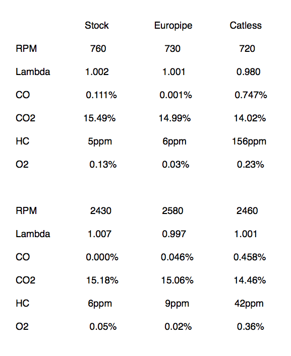

There are differences indeed. All these 100 cell race cats are actually made for racecars that run on a racetrack. Those cats all have a low amount of precious metals because the emission results are not that important.
We invest in 100 cell sport cats that have been coated with a very high amount of precious metal. They are vastly superior to any of those Euro 4 grade 200 cell cats commonly used on aftermarket Porsche sport exhausts.
Here are the emission results of our test-bed 997 Turbo with 100 cell Europipe cats after 64.000 km of use.
I also measured the emissions without cats so you can compare stock emissions with Europipe 100 cell and catless.
Hi Stef,
The extremely low CO implies either a really lean mixture or hot cat. Did you happen to measure Oxides of Nitrogen (NOx)? They tend to skyrocket when you get CO that low, and we can't pass tail-pipe tested emissions here with anything above normal NOx (not to mention the annoying eye burning typically associated with high NOx... its what people usually sense when they think a car isnt using cats.)
I have no problem with ultra-high quality 100-cell cats, I'm just a bit of an old emissions test geek from when we had to try and get souped-up cars passed that were on the line.
For awhile there was a on-dyno "road course" that testers had to do complete with hills and stop signs. You had to know who the testers were that could keep the car out of boost (hydrocarbons).
