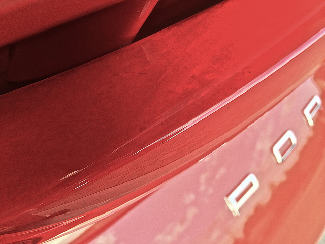

Could use a bit of detailing advice...
I am a complete noob when it comes to detailing. After a week of bad treatment (rain, dirt and track duty), I have some kind of dark dirt layer that seems 'baked' into the paint -probably the wax I guess-. Very little success with regular shampoo unless I scrub very hard and am worried I would scratch the clearcoat.
I know they are a bunch of detail wizards on the forum. Would one of them chime in and recommend what cleaning product I should use?
Here's a pic of my rear wing. I forced the contrast of the photograph to make the dirt more visible.
Thanks a lot for any suggestion ou may have!
Poor car gets the dirt beat into it from the speed!

Serge,
Go by and see David Whitlock at Atlanta Auto Salon, http://www.atlantaautosalon.com he is one of the very best. He is located in Roswell, very close to Henessey. If he can't help you it most likely it cannot be cured. People win national concours when he details their cars.

Serge - another thing you might try, if Money's method does not work, is to try Tarminator by Stoner. I have used it many times to get rid of stubborn stains that other methods have failed to deliver on. As an example, I had some newsprint that bleed onto my paint (long story). I tried all kinds of cleaners and it would not come out. However, Tarminator did the trick. I was happy.
http://www.autogeek.net/tarminator.html
Good luck.

Serge: you can pick up a bottle of Nu Finish in Walmart, etc. Make sure the wing is clean and there is no grit or dust, then gently apply the Nu Finish in small circular motions (there is no need for excessive pressure).
Amazon.com: Nu Finish Liquid Car Polish: Automotive Amazon.com: Nu Finish Liquid Car Polish: Automotive
I also use a lot of the higher-end cleaning and polishing products, but I find myself reaching for the Nu Finish to remove those stubborn tar and dirt stains.

Have you tried compounding it?
Auto parts store should have it (pick up 3m). Add some water and just rub lightly. That will clean the surface. You will need to re-wax/polish the area afterwards though.

Wd-40

Sorry, I should have given more explanation so you can make a better educated decision Serge. I hate it when I'm given advice without any explanation where it was derived from.
Your car has primer, base coat color paint, clear coat, wax, then polish (in that order of layering).
Most of the times "dark stain" is superficial and is just on the polished surface. Usually a polish cleaner will clean this.
If you neglect your car without re-polish and re-wax after every season (wax and polish is washed away by traditional car wash facilities), stains can get into the base clear coat. This lends to the old saying "protect you paint finish with wax and then make it shine with polish". Also why some bird poop eats through paint easier because wax has been thinned out through washes.
If the "dark stain has embedded into the polish and wax, a compound cleaner will clean all the way down to the clear coat, but remove the wax and polish with it. Thus you will need to re-polish and re-wax.
Hope that helps.

No no no! Please don't use wd40.

Just looked into tarminator. Looks like a great product. I assume it is a strong polish/wax cleaner. Try it first. Might work. Good recommend Porschecrazy.

Why not?
My experience has been quite the opposite vs other high end solutions.
It's worked for me many times & my cars get babied to the max.....

Maybe you made a typo, but polish is not a layer and is done prior to your last step(wax/sealant/coating). Compound/Polish, whatever you want to call it, is simply a liquid with abbrasives designed to correct the hardened clear coat. Polishing doesn't "clean" the paint. You want contaminent free, clean clear coat prior to abbrating the surface with a polish. The oils found in modern polishes need to be removed from the clear coat after performing their function in order to get a proper bond for your wax or sealant. I use either Isoprophyl alcohol diluted to 30% or Menzerna top inspection prior to a wax of sealant. Coatings like CQuartz, 22ple, or Opt-Coat require an completely polish residue free surface to have any chance of bonding properly. You would never polish your Last Step.
With today's baked on clear coats (super hard) hand polishing is basically a waste of effort. You really need a machine to get decent results.
The only problem with WD-40 is that it will leave a residue. Just follow with IPA, and it should be fine. I agree Stoner's may help with the initial heavy stuff, but claying will get that embedded dirt out properly.
Grab yourself a sandwich bag, put it on your hand, and swipe it across the cleaned paint. If it doesn't feel silky smooth, you'll still have more claying/autoscrubbing to do.

Thanks a lot to you all guys, I feel a lot smarter at once
Between the products and techniques you described and the address of a pro for complementing my own efforts every once in a while, I should have the car back to a pristine condition easily.... Just in time for the pollen season

Serge, you track it a lot, get the car Opti Coated or use CQuartz.
Makes after track clean up much easier I have found, do your wheels too. Initial cost is a bit higher, but makes your life easier in the long run.

I have the Xpel. Found out last year if you don't get the rubber off soon it will leave a stain.
